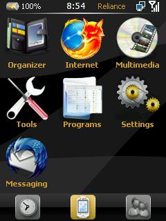

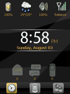

A Screenshot of my present WM Firefox theme running on SpbShell 2.1 :D (check out the awesome Internet and Messaging icons, they absolutely rock) :)
If any of you guys want it just let me know, I'll upload it here
(Dont know how many "Mogul" users are eating their hearts out... Go Touch!!!!! :D )
Just kidding though, but I guess Spb Shell runs better on Touch than Mogul :) hehe
