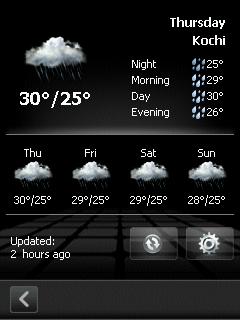

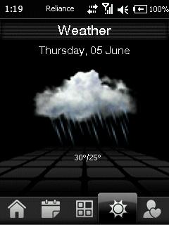

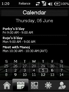

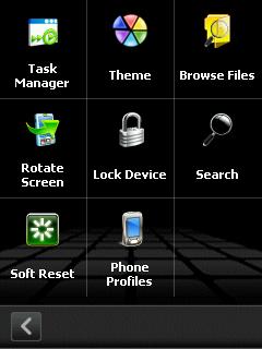

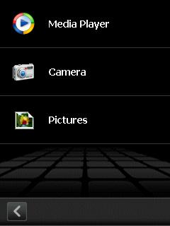

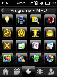

Anupe 14 Report post Posted June 5, 2008 (edited) Good one Anupe!I think the same procedure may also work with 6800 if anybody wants to use the lighter Sprint ROM? Could you give a little step by step brief of what all you did, right from Flashing ROM etc.., so we may try it if we want on our 6800's also Yes Dhiraj, I'm assuming the procedure should work on the Mogul as well, since both are running on more or less the same platform. To start right from the beginning: (1)Hook up PPC to computer thru ActiveSync, with Hetal's extended ROM extracted into SD card so that two folders called Boot and Service and a SD Config text file are located in the SD card. (2)Bring up the bootloader and flash Sprint Leaked ROM and let it install. (Please ensure you have already unlocked using Cokeman's unlocker if you are doing this for the first time!!) (3)Remove USB connection to computer and let Initial booting up of PPC happen, giving about 30 seconds time before calibrating stylus, etc. (4)Soft reset BEFORE Sprint customisation takes place ( when you see you have 3 seconds for Sprint customising to begin, immediately do the soft reset!!) (5)After the PPC boots up completely, check connection setting to see if Hetals cabs have been loaded, if not, run the cabs from Service folder in your SD card. The cabs which need to be installed are HP_Rel_MobileWorld, HP_Rel_NetConnect and Reliance3.sa. (6)After making sure now the Reliance settings are visible in your connection settings, soft reset once more and let PPC re-start. (7)On your desktop, right click and create new text file and rename it as HTC_CM_Guardian.exe. (8)Download and install Total Commander (cab or windows installer version) from HERE on your PPC. (9)Now connect your PPC to computer and upload the HTC_CM_Guardian file you had earlier created and save it on your SD card. (10)Browse to the Program folder on your phone and delete the folder named IOTA from there.(Use Total Commander if the folder is not visible with File Explorer) (11)Using Total Commander, browse to Windows folder and replace the HTC_CM_Guardian.exe file you will find inside there, with the 0byte HTC_CM_Guardian folder you have in your SD card. (12)Close all applications, disconnect from USB cable and soft rest your PPC. (13)When PPC has fully booted up, Go to Setting/Connections/Manage my Connections and delete the Sprint dialer you see inside there and click OK. (14) Next go to the Advanced tab and under Select Networks, select Reliance MobileWorld as your Network and click OK. (15)Test you connection now using Internet Explorer, your phone should be able to connect to the Net directly. (16)Soft reset once more, and after phone has fully restarted, click IE and check if Net is being connected. It should be working perfectly fine. ENJOY!!! This should solve the issue once and for all. Hope you guys will find it useful. Edited June 5, 2008 by Anupe Share this post Link to post Share on other sites
Anupe 14 Report post Posted June 5, 2008 (edited) BTW what site/procedure are you using to upload your screenshots so that they display immediately in your posts. I am using a software called GetPDAScreen with which you can take screenshots of your phone when it is connected to ActiveSync. I am getting an error when trying to upload the software for you here, so I will give you the link instead. You can get it from here Save the screenshot files as JPEG images and upload to your post under "manage attachments" using the small icon wtih + sign in there. Hope this helps Edited June 5, 2008 by Anupe Share this post Link to post Share on other sites
