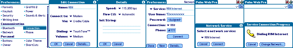

I think we need a small tutorial here on Palm OS 5 PDA
(mostly it is same for OS 4 I guess).
So that we go in a proper direction to try it get working:
Requirements:
1.Palm OS 5 PDA.
2.Cradle/Cable that comes with the Palm PDA.
3.USB Male<->Female Gender Changer.
4.RIM Phone/FWP.
5.USB Data Cable for RIM Phone/FWP.
How to do it:
1.Goto Prefs:
Select Connection(See Snapshot1).
Create a New Connecion (RIM in Snap shot).
2.Edit the Properties as ShownSee Snapshot 2).
a.Connect to -> Modem.
b. Via Cradl/Cable
c.Dialing ->Touch Tone.
d.Volume -> Medium.
3.Set the Details for the connection(See Snapshot 3)
Details:
Speed -> 115,200 bps.
Flow Control -> Automatic.
Close the app.
4.Goto Prefs again:
Select Network(See Snapshot 4):
Create a New Connection(Named here RIM Internet).
a.Service RIM Internet.
b.User Name: 093xxxxxxxx
c.Password: 093xxxxxxxx
d.Phone: #777
e. Select Done.
5.Connect the phone thru USB Cable.
a.Connect the data cable to RIM phone.
b.Connect the USB Port End to a USB Male<->Female Gender Changer.
c.Connect the Palm USB cable between the Palmop & the Gender Changer.
6.Now open your Web Browser (Palm Web Pro here)
as in (See Snapshot 5).
1.Select the Network Service: RIM Interenet (U created Above).
2.Dial the Connection.
Why doesn't it work???
*I tested it with LG 5230 with original LG Cable.
*We don't know the exact reason.
*What happens is when U try to connect
there is not even a blink of the light on the cable
(I used original LG cable which indicates Tx & Rx events by
Red & Green Lights respectively).
*Even Sending AT Commands won't reach the phone.
*The above works well with a Normal USB modem which means that
RIM phone+cable doesn't behave like a standard USB modem.
It requires the software drivers on windows to emulate the same.
*Likely solution is having a cable ciruitry that makes it behave
like a ordinary USB modem without requiring any drivers.
*Any one with the newer LG FWP which comes with a Direct USB port
can see if the above works with that. Most likley it should work.
Any one ?????????????
