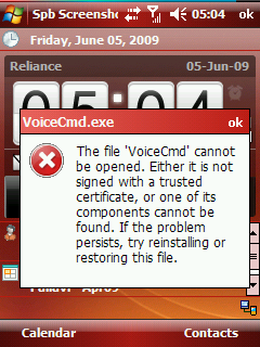

faiqg 0 Report post Posted June 5, 2009 I bought HTC Mogul via RIMWeb and the experience has been good so far. There are some issues which i am facing and havnt been able to find a solution here or anywhere. Can someone please answer them for me 1. Voice command not working. Shows up error message (see attached screenshot) that VoiceCmd cannot be opened. 2. I am not able to remove certain programs, which probably the previous owner installed. They are not visible in the Remove Programs list on phone or on ActiveSync. (Resco explorer, Picasa, Opera, MagicCall are some programs i dont want and free up some space) If these questions are already answered somewhere, please point me to them. I have been searching for a while now. Regards Faiq Share this post Link to post Share on other sites

Mufaddal 678 Report post Posted June 5, 2009 if u do a hard reset u will get rid off all the problems that u r facing . hard reset will wipe off all apps on ur device but if any apps are installed in memory card the exe files will still be there in meory card and the application can still be run from memory card what i feel is that u must be having icons of the apps in ur programs menu and they are not showing in remove prograrm lis if they are just icons then u can remove it by using total commnder and going to winodws /start menu and removing it Share this post Link to post Share on other sites
dkaile 1,051 Report post Posted June 7, 2009 Reload sprint original rom and voice command will work properly. Follow link in signature as to how to... Share this post Link to post Share on other sites
faiqg 0 Report post Posted June 9, 2009 Hmm so there is no way i can clean up applications from the phone apart from reloading ROM after hard reset. @mufaddal_km They are not just icons but applications. The phone is right now on Win Mob 6.1 Build 20931.1.5.0 created by Hetal. The ROM version is 3.08.666.1 which is dated 07/21/08. Share this post Link to post Share on other sites
dkaile 1,051 Report post Posted June 9, 2009 http://www.rimweb.in/forums/index.php?show...15023&st=85 Share this post Link to post Share on other sites
prafull4u 24 Report post Posted June 12, 2009 As you are using a customised ROM, those application are preinstalled with the ROM and will not show up in add remove program Better install Original sprint ROM, it not a daunting process all you have to do is to follow the thread by dkaile Everything is explained there perfectly.... Share this post Link to post Share on other sites
