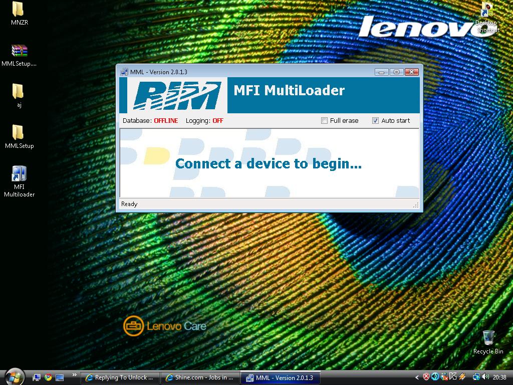

Hi V,
I know this is not the answer to your quesry however it seems you can help me,, i tried to follow the same process but after installing the MFI when i tried to run & connect my 8830 to wipe,,, it just keeps showing "CONNECT A device to begin",
Can you please help me to guide if i m missing to install something... i m using Windows vista 32x on my system...
Please review & advise.
NOTE: i have just attached a screenshot for your refernce.
Thanks,
A RJ
Don't know. I got a connected message, things happened for a while, and then said FAIL. The device was wiped clean not even the OS. Everything had to be installed from scratch.
