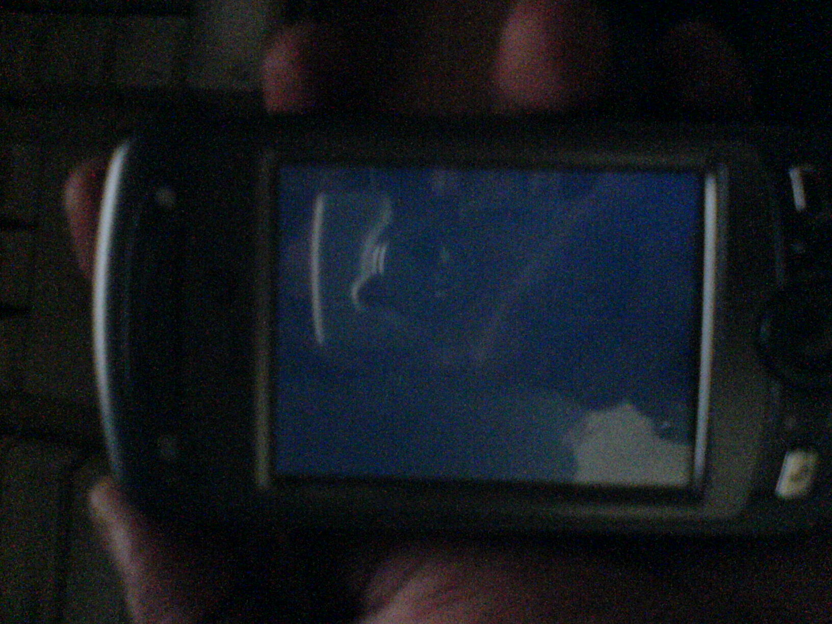

Guys ... need help with the Mogul .. never fallen ... never beaten ... treated gentlemanly way .... yet the #$%&@ behaved like .... #$% !! Attached screenshot, this is the only thing it is showing. Nothing else ... anything I can do except throwing it away and grabbing the iPhone 3GS when it launches in India ? That should be having a better quality? Opinion please, friends ...
when did it go kaput? How long have you had it? Where did you get it from?
The photo is so blurry, can hardly make out anything... What do u mean by almost dead... never seen such a problem all by itself.... what exactly happened and how did this problem start.... are u able to receive calls... or does it ring... did some water seep into it... did u use a non standard charger to charge it...
cant make out anything from the photo u posted
looks like water damage or screen damage to me from the pic
i would suggest u to take better pics of the phone both when switched off and switched on if u u want help
Try calling yr phone... If You call & it rings... but yr phone doesn't show anything... means... YR LCD display Cable has a problem. Try opening & closing keyboard FAST... might do the trick. If the cable has minor problem... supplementing it with a tape might help. If its broken/damaged u need new cable...

1. Problem started when phone was being used as a modem connected via USB. It was used such for extended periods, and I saw that orange light was blinking. It was hot to touch, and I immediately removed it and let it cool. Then, there were little signs of graphical corruption... as in that switching from portrait to landscape would be fine but then touch ability would be lost, and screen would be frozen - however, all functions would work - only screen frozen. When I return to portrait, everything ok.
Next day, that also vanished. I will take better pics. Phone rings if I call it, and I can use alerts number redial. Vibration, etc. everything fine, speaker works too. Only some problem related to the display ... I sense that there is some problem due to overheat and it will be limited to the display itself - I assure you rest everything works as expected - just I can not see anything - not even the boot screen and hard reset and bootloader (tri color) screens.
2. I keep my devices with great care - never dropped or any sort of damage inflicted upon. No water damage at all - never one drop. Trust me. :) Bought last year April from our Sadik bro ... when he bbrought these into India ... box packed QWest.
Regarding keyboard opening and closing, it is like this .... earlier (earlier meaning when the problem started) .. when I start to take out my keyboard slowly, there is a point when screen will shift into landscape even when the keyboard is not fully out. If I stop at that position, touch used to work on landscape also ... and then when I will slide the whole keyboard out, screen would freeze as described above. @Peter .. I believe you are right ... could it be that the heat damaged the display cable?
Nobody in Palika Bazaar opened it - when they came to know it is CDMA, they were like "we won't get parts" ... I told just open and see may be some problem that won't require parts ... but I guess they meant that they won't get cheap parts to replace my phone's genuine parts ... ;) I did not try Gaffar, due to past experience that they will charge heavy for simply opening and looking into the problem ... presently am in Kolkata ...
I took the pic in dark, so that I could show the screen backlight. Phone is indeed switched on in the pic ... never mind, I will post better pics tomorrow ... thank you friends ... your experience may just save my purchase ... it's just been a year and I am still like it's a new device ... :grin:

Ur display looks to be gone bad

Fired it up to take new photos ... found the display glowing in its original beauty .. May be your good wishes! After two months of constant blankness, the display fired to life today ... I do not know for how long ... so I am just using it to take my landline portal ID which was in there ... :grin:
OK, it is in portrait, and I have not yet tried landscape till now, fearing corruption. I will backup my things first, then experimentation ... will report findings later ... :)
Edited by shubhanyu
Well .. as soon as I changed it to landscape, display slowly faded away ... that's it. Now not even working for portrait ... just like before ...
OK, display is back ... it is becoming quite clear that the problem may be in the cable as was suggested ... now I won't dare change it to landscape ! :)
Display strip melted due to heat.. I think some earthing issue with electricity @ ur place...

The Mugen Power Battery could be the culprit for the overheating issue causing this breakdown... Try at an HTC Service Centre... The display strip used is common with many HTC Models being repaired by them, so you could be in luck...
i dont think display strip is common with any other HTC model... plz check. it will cost around 2500 rs.
Melting due to heat is rare.... Most common reason is opening & closing.... the strip might have had a bad close which might have bent it or streched it a bit to put some pressure & causing it to tear from 1 end...
The display strip is common with HTC P4350 and C800 models being sold in India and is available with them...
