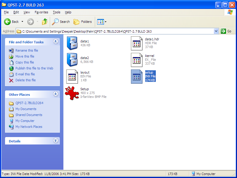

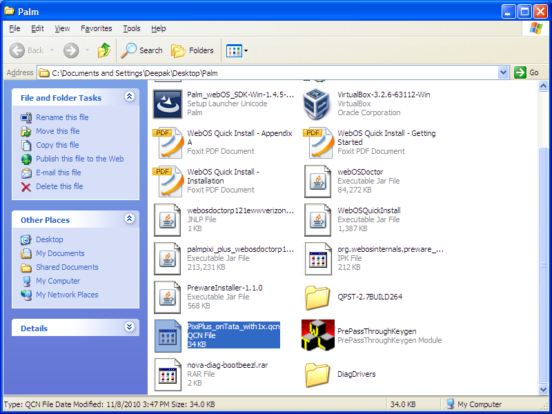

deepakchan 0 Report post Posted November 10, 2010 (edited) On 11/10/2010 at 4:39 AM, vijaymalhotra_2007 said: Deepak U post ur problem in only single thread not in multi thread ? What exactly problem u have faced? Sorry I shall stick to this thread from here on. On 11/10/2010 at 9:19 AM, ::Hitesh:: said: @Deepak:- you dont require that command if your diag mode is working, use the usb passthru and make USB1=DIAG and all other to none or disabled. then check in device manager in windows. it should show com port if drivers are installed. Thanks Hitesh. I shall check this and also vijay's post of using mpt 0d and get back to the forum with the exact problem if any. In the first step of the 2nd portion of the procedure, opening up qpst, how do I do that? I am presented only with these after unzipping the qpst package. Also ananth001 has sent me a .qcn file from a working Tata pixi plus with data. I do not know where to use this too. Edited November 10, 2010 by deepakchan Share this post Link to post Share on other sites
