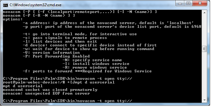

I am stuck at this point where you type "novacom -t open tty://" and type mpt d userserial at the -[J prompt. I have attached the screenshot of the error. I have set all the ports in usbpassthrough to none. If I put usb1=diag then even novacom command is not working. Where am I going wrong?
post-42092-0-40630100-1293194978_thumb.p
try it on another PC
it seems u are using Win7
try XP
Use this command in sdk
mpt d or mpt 0d
also your out put screen shows successful enable usb serial.
