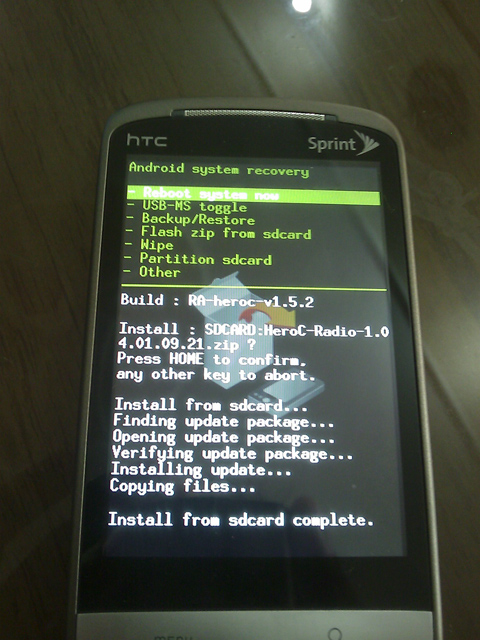

Just Flashed with the 1.04.01.09.21 ROM.
It showed success but when I actually viewed the Baseband, it still shows the newer one that is 2.42.00.03.10
Could someone help?

First Flash it and Press Proper Keys Combination to Actually Apply it.
Please see the attached pic. This is what I get after flashing the rom. It doesnt ask for any key combo!
u can downgrade and upgrade radio as many times as u want
all u have to do is just flash from recovery like any other rom
problem is that u have already downgraded your radio , but the radio u used isnt propelry signed thats y its showing 2.41 in baseband inspite u flashing 1.04
try this radio ( signed stock )
http://forum.xda-developers.com/showthread.php?t=644004
