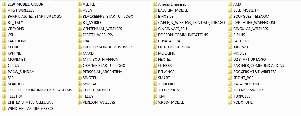

::Hitesh:: 1,763 Report post Posted May 7, 2010 Download this pack I have renamed almost every file with Operator name VSM Pack Screen shot 4 Share this post Link to post Share on other sites
@mitJ@in 256 Report post Posted May 8, 2010 Apart from Boot up Logo, what changes are made in the device after loading the VSM File of particular operator. Do it changed the Vendor info too in device? Share this post Link to post Share on other sites
::Hitesh:: 1,763 Report post Posted May 8, 2010 Amit ji, try to karo fir jano !!! If u load reliance VSM on verizon bb, verizon bb will look like reliance official phone. Bootup logo, wallpaper, appearance is changed as per operator vsm file. Share this post Link to post Share on other sites
@mitJ@in 256 Report post Posted May 8, 2010 THere are many files in Reliance folder given by you. Which file is for BB8830 ? Share this post Link to post Share on other sites
::Hitesh:: 1,763 Report post Posted May 8, 2010 (edited) ^^^ VSM-13781-003 ( RELIANCE INDIA ) ( VID 236 ) (320 X 240 ) Edited May 8, 2010 by ::Hitesh:: Share this post Link to post Share on other sites

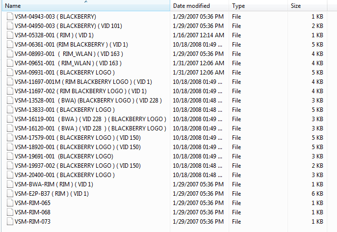

::Hitesh:: 1,763 Report post Posted May 11, 2010 just use this file with MFI VSM-13781-003 ( RELIANCE INDIA ) ( VID 236 ) (320 X 240 ) and your bb will be reliance , also u will have reliance ring tone if u have installed reliance OS Share this post Link to post Share on other sites
konquerror 21 Report post Posted May 11, 2010 ^^^Thanks for info...but I am trying to debrand it...means I don't want any operator stuff...not Reliance...not Tata..original Blackberry...then what file should I use in MFI? Share this post Link to post Share on other sites
::Hitesh:: 1,763 Report post Posted May 11, 2010 (edited) in 2nd upload, blackberry logo start up files are there, try them Edited May 11, 2010 by ::Hitesh:: 1 Share this post Link to post Share on other sites
