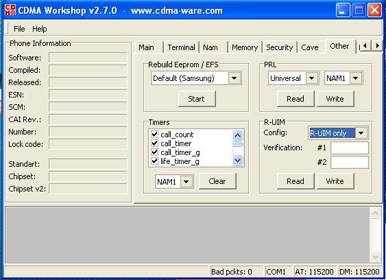

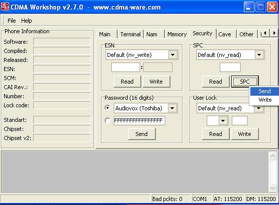

shripalkawdia 12 Report post Posted August 13, 2010 READ SPC WITH ATTACHED SOFTWARE THEN SEND SPC BY C.W. SEE 1ST PIC THEN WRITE RUIM ONLY BY C.W. SEE 2ND PIC FOR CDMA WORKSHOP 2.7 CRACKED SEARCH ON GOOGLE 1255_Unlocker.rar Share this post Link to post Share on other sites
