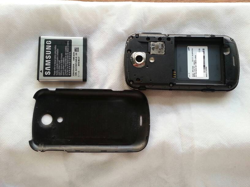

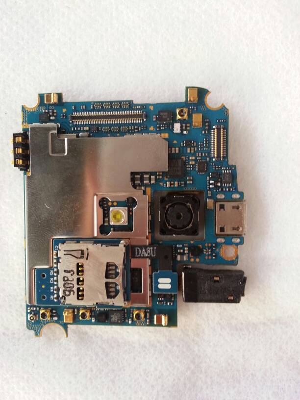

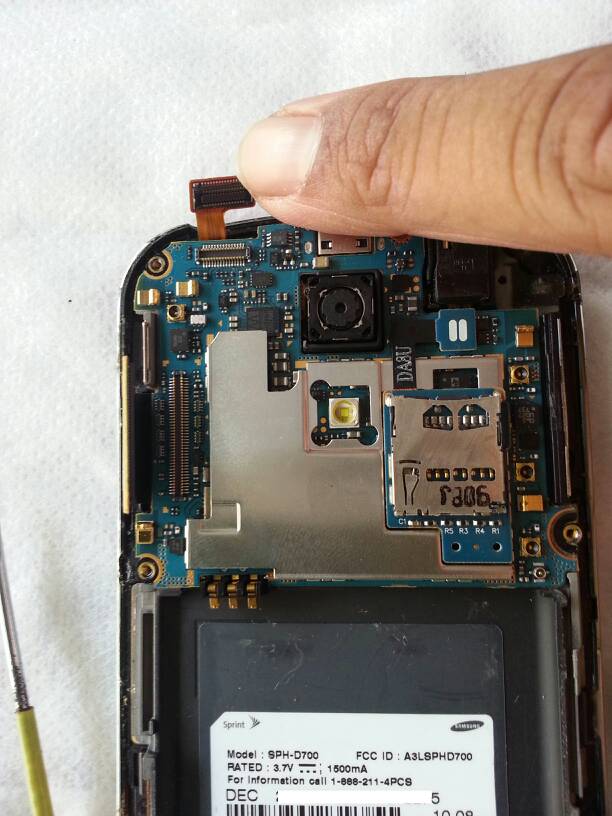

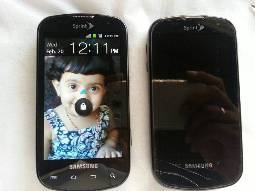

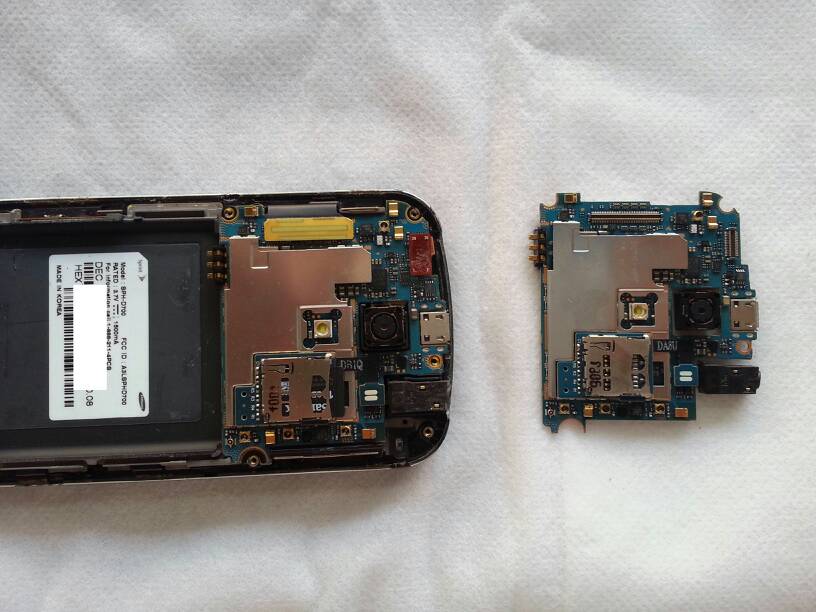

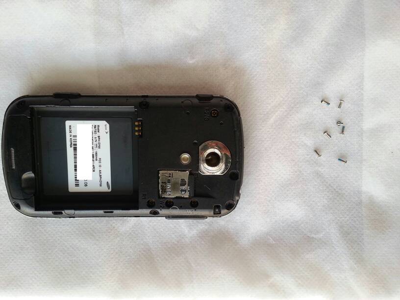

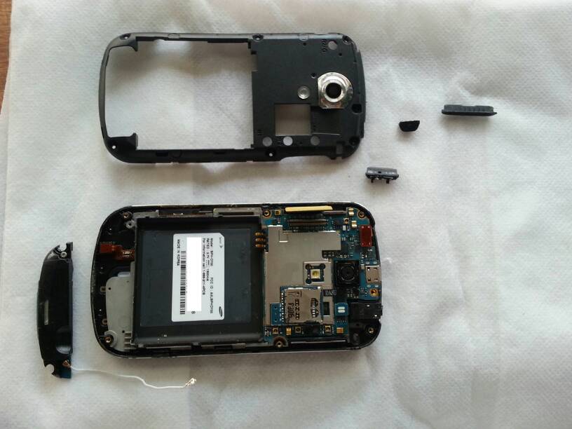

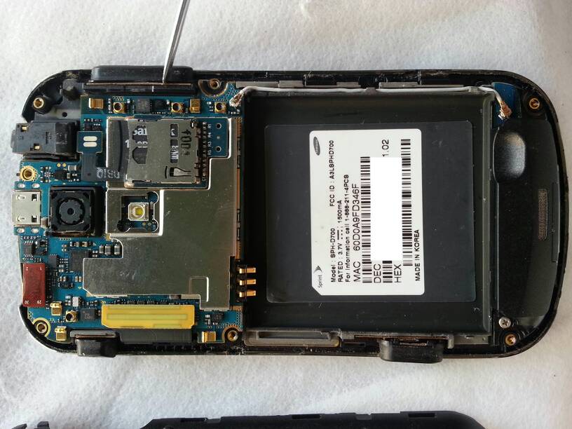

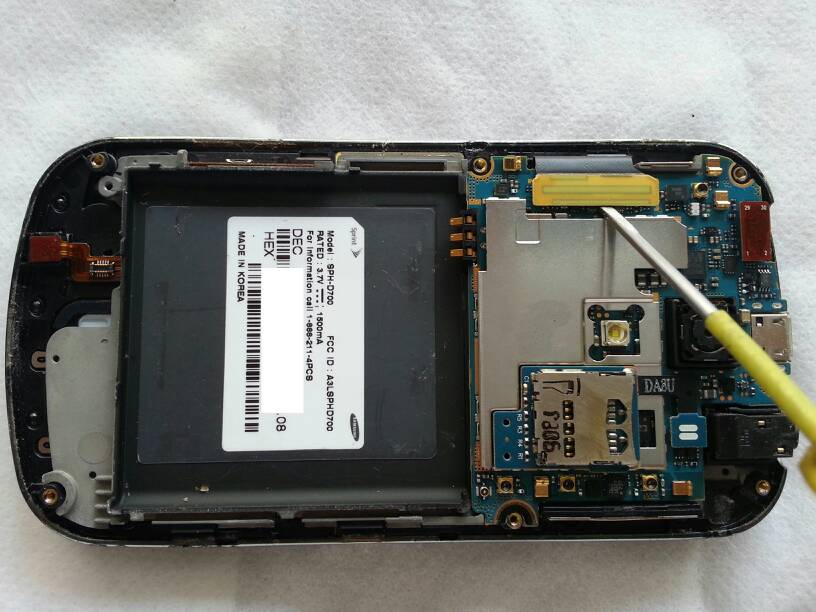

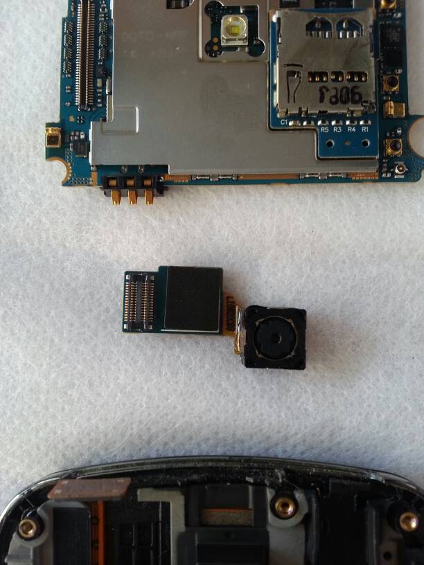

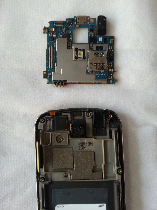

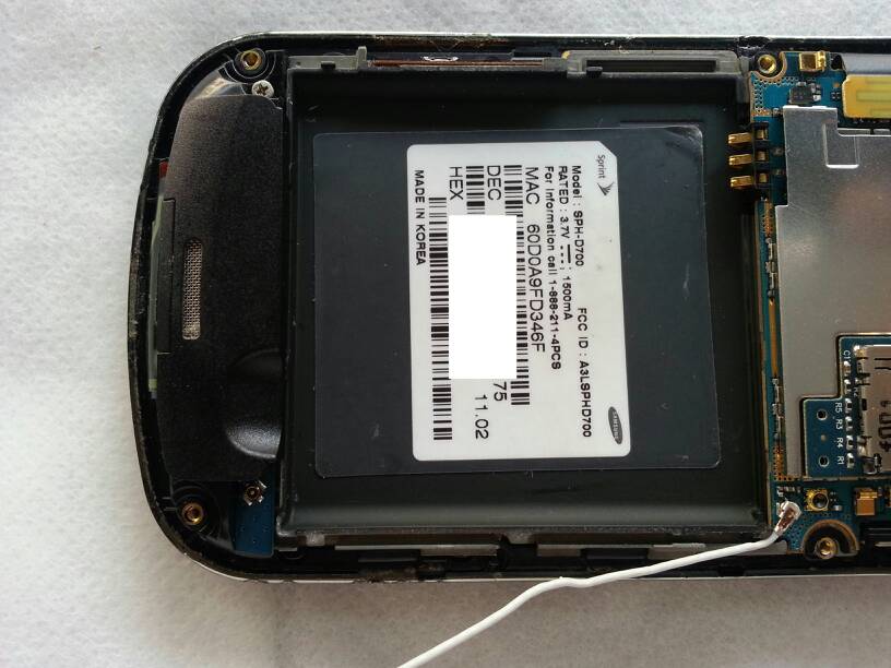

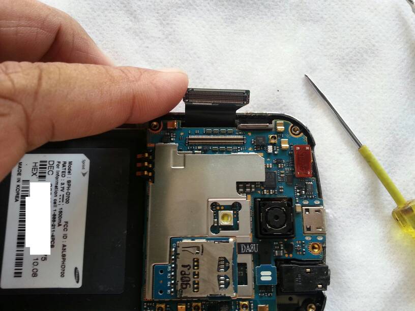

Vinod Nayak 443 Report post Posted February 20, 2013 (edited) Thanks to doc_anurag for giving me his Epic. Recently my mom's Epic had a cracked front glass. Recently the screen went from Orange to purple to dead black, can receive calls only. Today's strike gave me loads of time to swap the mother boards. Below are some pics. Left is my mom's phone. Back cover and battery removed. Main housing screws removed. Main housing removed with the side buttons, speaker and antenna connecting wires. Main connector connecting the screen removed. One more connector removed. Mother board removed to swap with moms phone. Sent from my SPH-L710 using Tapatalk 2 Edited February 20, 2013 by Vinod Nayak 6 Share this post Link to post Share on other sites
digitalnirvana 646 Report post Posted February 20, 2013 Kudos to doc_anurag! Share this post Link to post Share on other sites
Balram Dhanda 8 Report post Posted February 20, 2013 Ultimate one, @ P Vinod Nayak :- You did that Surgery ? Share this post Link to post Share on other sites
