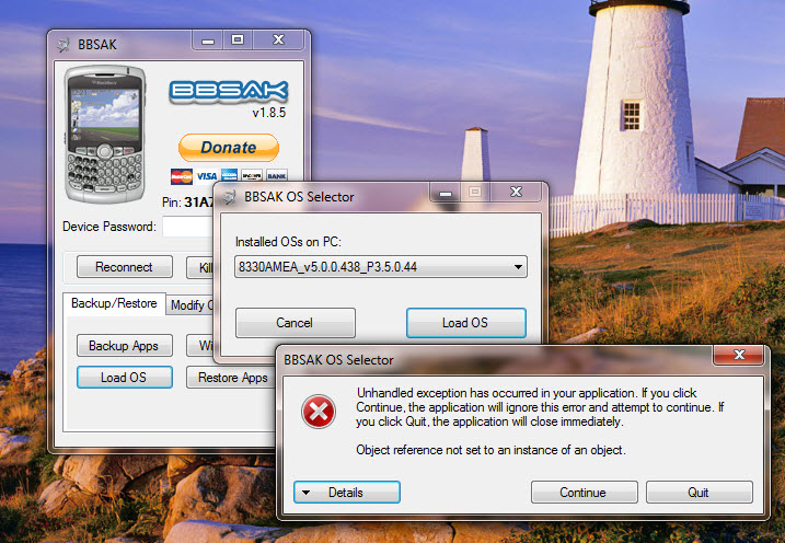

Berryberry 1 Report post Posted November 4, 2010 ^Thanks for your reply. I guess, I've run into some problems though. I backup-ed the phone, then downloaded BBSAK 1.8.5. I wiped clean the phone through BBSAK, and the phone did show the 507 screen. I then downloaded the 8330AMEA_PBr5.0.0_rel724_PL3.5.0.44_A5.0.0.438_Boost_Mobile.exe from BB website. Then installed the OS on the PC while the BBSAK was running. Then I clicked load OS and chose the OS from the drop down list. ^This is where the problem starts. I get an 'Unhandled exception has occured' error after this. Please see the attached screenshot. When I click 'continue', nothing happens. It just sits on that screen. What am I doing wrong here? Is there any other OS version I can try? Please help me out. My PC OS : Windows 7 Pro, (UAC is disabled), BBSAK does still detect my phone. Share this post Link to post Share on other sites
::Hitesh:: 1,763 Report post Posted November 5, 2010 1) on error 507 bbsak will not detect your phone, even BB dm will not detect. 2) if BBSAK is giving errors follow method no-2 close bb dm, and all BB software running (better to restart and start fresh) connect phone to pc go to "C:\Program Files\Common Files\Research In Motion\AppLoader" and delete Vendor.xml then from same folder run Loader.exe then just follow the wizard. Also this method is posted on the forum by Dr Mufaddal. more details can be found there. Share this post Link to post Share on other sites

Berryberry 1 Report post Posted November 5, 2010 ^Dear Hitesh, Thanks for the reply. Funny, I did somewhat similar. Since it wouldnt let me install through BBSAK, so googling a bit helped me pinpoint where the OS got installed on the PC. I did check Dr. Mufaddal's thread, and searched for the vendor.xml file. Only, it wasnt there! I infact did a search for it in the entire Research in motion folder (and not just the app loader), but it wasnt there ! :s Is that normal? :S Anyways, I used the loader.exe to install the OS. It installed fine. Now, the only problem I see is that it takes long, and I mean WAY LONG to boot. Almost close to 20-25 minutes.. Again, is that normal? Is there a workaround to this problem? Cos, if this stays, I'll be forced to downgrade again, cos this can be dangerous in an SOS situation if the mobile reboots and then wouldnt come alive for almost 1/2 hour! Share this post Link to post Share on other sites
