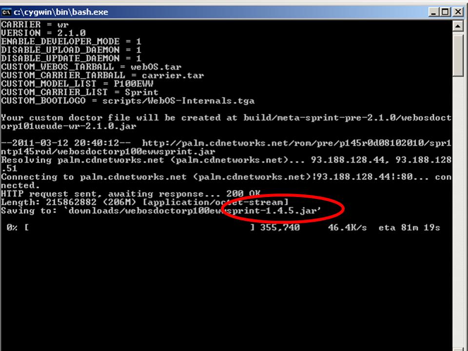

Bablus 66 Report post Posted March 12, 2011 Step 5: Now,it automatically downloads almost 450 Mb of data.So,have patience and wait till it completes.Once the webOS 2.1.0 JAR build is complete, it'll pop-up and initiate the doctoring/upgrade process. Follow the onscreen instructions.From here on,its just like normal doctoring. For some reason the file that got downloaded was "webosdoctorp100ewwsprint-1.4.5" The file name does not suggest that is webos2.1.. Or is it supposed to be that way only? and.. with respect to loading the rom http://www.rimweb.in/forums/topic/26928-palm-pre-simple-meta-doctoring-on-windows/ is that a good guide to follow? Share this post Link to post Share on other sites
cooldude9848 10 Report post Posted March 12, 2011 Step 5: Now,it automatically downloads almost 450 Mb of data.So,have patience and wait till it completes.Once the webOS 2.1.0 JAR build is complete, it'll pop-up and initiate the doctoring/upgrade process. Follow the onscreen instructions.From here on,its just like normal doctoring. For some reason the file that got downloaded was "webosdoctorp100ewwsprint-1.4.5" The file name does not suggest that is webos2.1.. Or is it supposed to be that way only? and.. with respect to loading the rom http://www.rimweb.in...ing-on-windows/ is that a good guide to follow? Have you erased your backup and turned off your palm profile before starting this process? About the method,its almost the same method of meta-doctoring,but with automated steps.It worked for me an many others. The final custom rom will be like 'webosdoctorp101ueude-wr-2.1.0'. It will be in the directory Local Disk C<cygwin<home<user(ur pc name)<meta-doctor/build/meta-sprint-pre-2.1.0/webosdoctorp101ueude-wr-2.1.0.jar It actually downloads 2.1.0 official pre2 rom and 1.4.5 official rom and merges them to a custom rom with activation bypassed.So if you saw 1.4.5 in cygwin ignore that and continue. But if the final output in the above mentioned directory i 1.4.5,better restart the process by going to official webos internals page. A NOTE ON "RE-DOCTORING": If this is not your first time through this process, you should do a "git pull" and a "make clobber" to ensure you have the latest scripts and a pristine build folder. From the command line (In Cygwin), type "cd meta-doctor" without the quotes and press enter. Then type "git pull" without the quotes and press enter. Then type "make clobber" without the quotes and press enter. Voila! You now have the latest scripts and a clean folder to build your doctor in. Share this post Link to post Share on other sites
Bablus 66 Report post Posted March 12, 2011 Backup turned off and erased.. But how does that matter.. I am still at the steps of Cygwin downloading rom.. Its at this stage that the rom that gets downloaded says 1.4... so.. I shall try ur tips of re-doctoring Share this post Link to post Share on other sites
Bablus 66 Report post Posted March 12, 2011 (edited) No difference.. Just to clarify my question when I run Semi-auto-Sprint-2.1.0 file.. The rom that is getting downloaded is called "webosdoctorp100ewwsprint-1.4.5" is that okay? or do I expect a file with sufix of 2.1? Edited March 12, 2011 by Bablus Share this post Link to post Share on other sites
cooldude9848 10 Report post Posted March 12, 2011 No difference.. Just to clarify my question when I run Semi-auto-Sprint-2.1.0 file.. The rom that is getting downloaded is called "webosdoctorp100ewwsprint-1.4.5" is that okay? or do I expect a file with sufix of 2.1? Its just going through the normal process..let it finish..wait till then. Share this post Link to post Share on other sites
