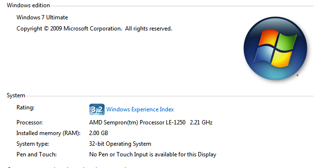

I am using MTS MBlaze BB,not getting smooth streaming of videos-Youtube,TV channels etc.
Here is my system config-
post-5499-0-67053900-1301081022_thumb.pn
Is it possible to increase the streaming speed?

You should try installing the latest version of Adobe Flash Player 10.2.153.1... Just released... http://get.adobe.com/flashplayer/
But it seems your AMD Sempron Processor 2.21 Ghz does not meet the minimum system requirement of this version mentioned here http://www.adobe.com...yer/systemreqs/
Still give it a try...

Your Slow Processor/graphics not meeting the system requirement of latest Adobe Flash Player OR Your MTS Mblaze Connection... OR Both...
Thanks a lot Rajan.You are always here to help me out...
Its working fine after updating adobe Flash player.
Is my processor really slow?Shud I upgrade my system?
