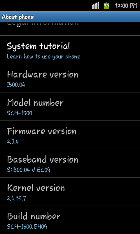

Finally updated my Fascinate to GB-EH09 based Rom posted Here
So far its working very fine since last two days, without any missed calls or so.
Better in terms of Signal Strength, Battery and Speed as compared to ED05.
