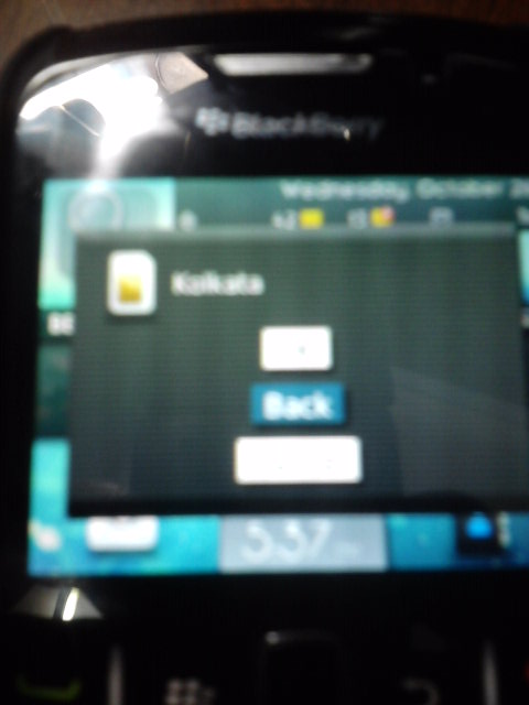

bhutoria_1989 1 Report post Posted October 21, 2011 Hi Guys, My Sprint Blackberry 8530 is now able to make and receive calls and sms on Reliance but I have some minor glitches that I would like to get resolved and some questions as well. They are: 1. After 3-4 Hrs a pop up is displayed with a Sim logo beside which my location i.e., Kolkata is displayed abd beneath there are 3 options Ok, Back & Cancel. Pressing any of these 3 options leads to complete reboot of the OS. It has happened 4-5 times yesterday. Now I have disabled GPS and will report more on that in the evening. 2. Whenever a caller calls the number is displayed instead of contact name even if it is saved in the directory. I found that the no. displayed is prefixed with a '0' and in the directory it is not and therefore it doesn't display the name. But if I edit the contact and prefix '0' then I am not able to send a message to any person. Only way to send SMS is by adding +91 before the contact. 3. A 10 Digit number is displayed in the Dialer screen as 'My Number' but it is not the number that I am using. Will it effect in any way if I edit it in MDN field after pressing ##SPC. 4. I am running Sprint OS and would like to install Reliance ROM from RIM website. Can this be done without hampering handset programming? 5. Lastly, 1X Data is also not working. Any tweaks to get it running? Thanks, Ankit Share this post Link to post Share on other sites

bhutoria_1989 1 Report post Posted October 26, 2011 As no one suggested any measure my problems have aggravated. I had disabled GPS and now also Data but the device continues to Reboot itself by showing a pop up. Right now it is in a continuous reboot cycle. Can Someone Please help it is getting unbearable. I have attached an image and a video. It is not of good quality but I hope at least someone understand what I am stating. HAPPY DIWALI Share this post Link to post Share on other sites

sunilj75 9 Report post Posted November 14, 2011 Dear Just change your blackberry id in ##spc from 2004 to 14655, your sms sending problem will be solved (no more error 98) 1 Share this post Link to post Share on other sites
bhutoria_1989 1 Report post Posted November 16, 2011 ^ Thanks Bro, Really it solved the problem. I am grateful. Share this post Link to post Share on other sites
bhutoria_1989 1 Report post Posted November 23, 2011 Update: After changing the BB Registration ID as suggested by Sunilj45 the phones's reboot problems has been solved as well. For the Past 1 week the phone has functioned flawlessly. Thanks to you guys. Hope it continues to work flawlessly..... Share this post Link to post Share on other sites
rajeshkparmar 0 Report post Posted March 14, 2012 Hi. i have blackberry curve 8530 and recently register the MEID. device is working fine with reliance but there are two issued,i am facing 1, still it will display the verizon network in network selection 2. and one dialog box appear after sometime and there is 3 button OK, cancel and back when i click any of these buttons it will restart the device - dialog box has simcard icon on left side Please any suggestion. Thanks Rajesh Share this post Link to post Share on other sites

bhutoria_1989 1 Report post Posted April 8, 2012 #rajeshkparmar Just change your BB Id in SPC to 14655, this did the trick for me Share this post Link to post Share on other sites
