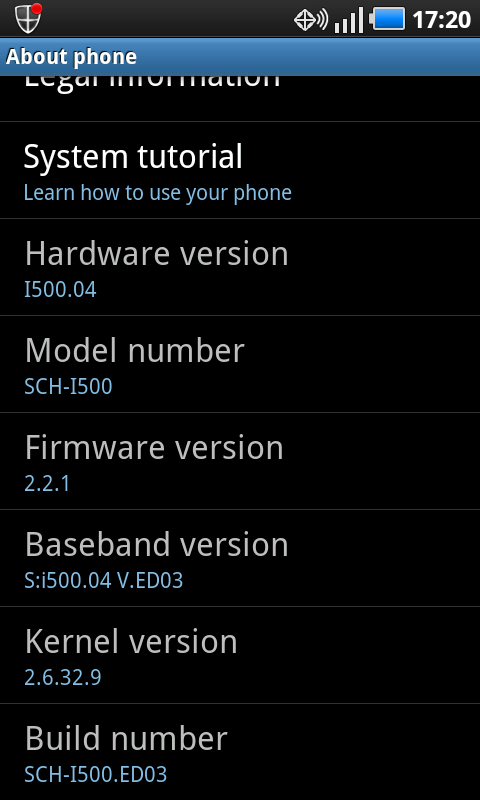

amitroutray 384 Report post Posted January 6, 2012 hi joshm, please help me out. i know you only can.. i want to be sure about my phone model first...bought it 2nd hand... without box.. its galaxy s i500 cdma verizon unlocked in india. i found out from "about phone" hardware version I500.04 model SCH-I500 Firmware version 2.1-update1 Baseband version S:i500.04 V.EA28 Kernel version 2.6.35.7 Build number SCH-I500.EA28 is it fascinate ? how do i know ? not mentioned any where... then how to upgrade it to gingerbread. please help thanks....amit Share this post Link to post Share on other sites
rajanmehta 4,056 Report post Posted January 6, 2012 ^ ^ ^ It's Fascinate. 1 Share this post Link to post Share on other sites
amitroutray 384 Report post Posted January 6, 2012 ^ ^ ^ It's Fascinate. thanx rajan, will i go with the above process. which u are mentioned. Share this post Link to post Share on other sites
sliver1 102 Report post Posted January 7, 2012 Yes you can definately go ahead. I upgraded my fascinate using this rom by following the step by step and very easy to understand instructions given by joshm. You can find the instructions in this post a few pages back. 1 Share this post Link to post Share on other sites
joshm 818 Report post Posted January 8, 2012 hi joshm, please help me out. i know you only can.. i want to be sure about my phone model first...bought it 2nd hand... without box.. its galaxy s i500 cdma verizon unlocked in india. i found out from "about phone" hardware version I500.04 model SCH-I500 Firmware version 2.1-update1 Baseband version S:i500.04 V.EA28 Kernel version 2.6.35.7 Build number SCH-I500.EA28 is it fascinate ? how do i know ? not mentioned any where... then how to upgrade it to gingerbread. please help thanks....amit see fascinate is a type of i500 which is made by samsung for verizon network in US , its a CDMA handset If urs in CDMA and i500 then you should be good to go with the above rooting and flashing methods that i have outlined plz note down ur MIN number mentioned in the settings > about menu , in case you mess up something by and large the process of rooting and updating ram is safe STILL IF ANYTHING GET MESSED DONT BLAME ME 1 Share this post Link to post Share on other sites
joshm 818 Report post Posted January 8, 2012 also try and stick to the stock EH03 first and see how your phone behaves Share this post Link to post Share on other sites
