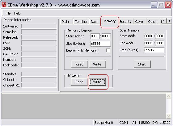

nishsuxx 193 Report post Posted May 1, 2012 (edited) ...he made a nv item txt file but didnt tell me how to put it on phone............ Check this thread: http://www.rimweb.in...n-registration/ Do as instructed till point 6 [How to / Step by Step:]. After that click on Memory tab > Click on Write > Select the NV item text file > Click Ok Close the Application, It will ask set Send Mode Reset, Click Yes otherwise reboot the phone manually. That`s It Disclaimer: Don't hunt me down if you break anything Edited May 1, 2012 by nishsuxx 1 Share this post Link to post Share on other sites

::: VA ::: 531 Report post Posted May 1, 2012 ...he made a nv item txt file but didnt tell me how to put it on phone............ Check this thread: http://www.rimweb.in...n-registration/ Do as instructed till point 6 [How to / Step by Step:]. After that click on Memory tab > Click on Write > Select the NV item text file > Click Ok Close the Application, It will ask set Send Mode Reset, Click Yes otherwise reboot the phone manually. That`s It Disclaimer: Don't hunt me down if you break anything Thanks bro Share this post Link to post Share on other sites
