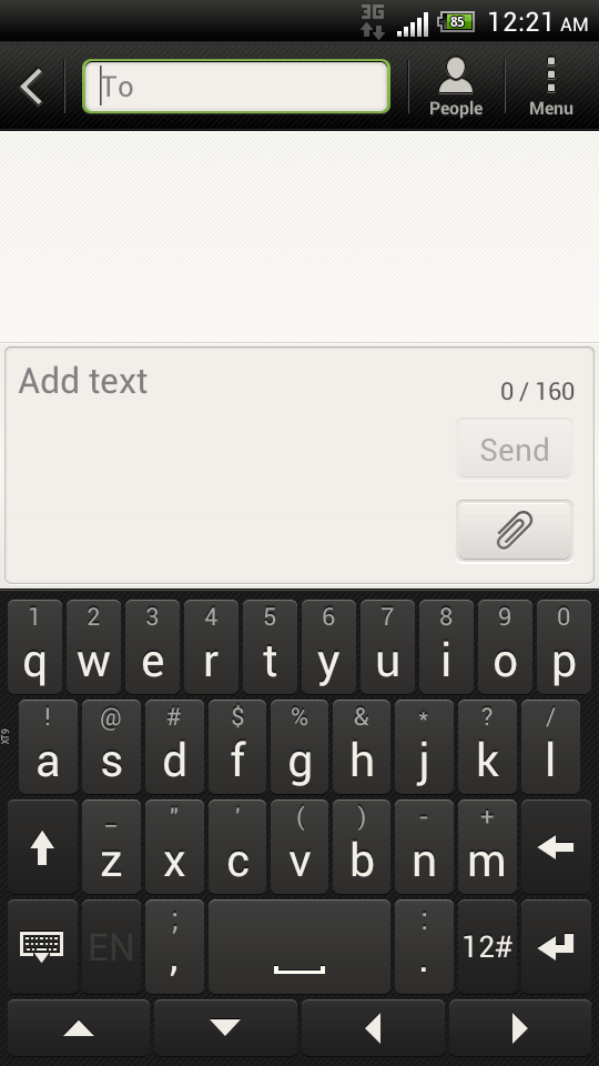

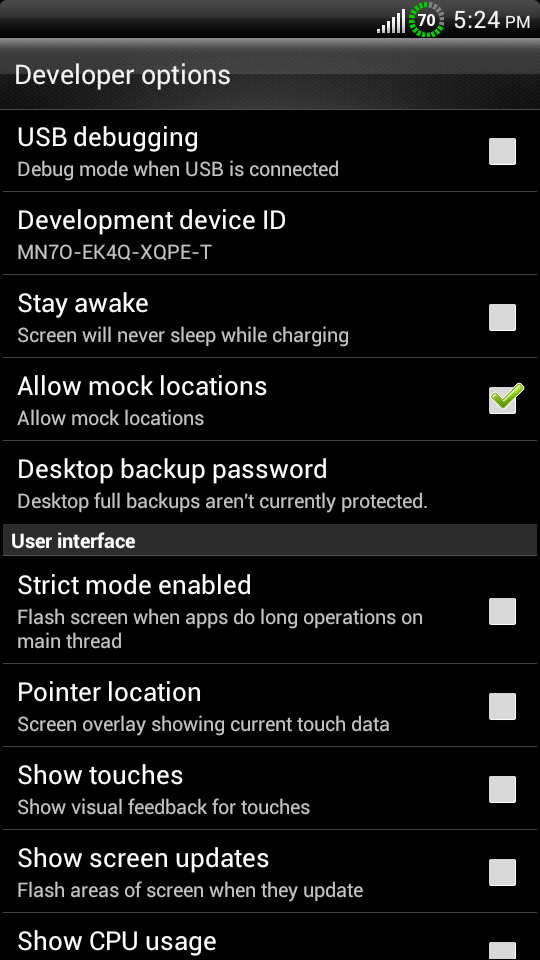

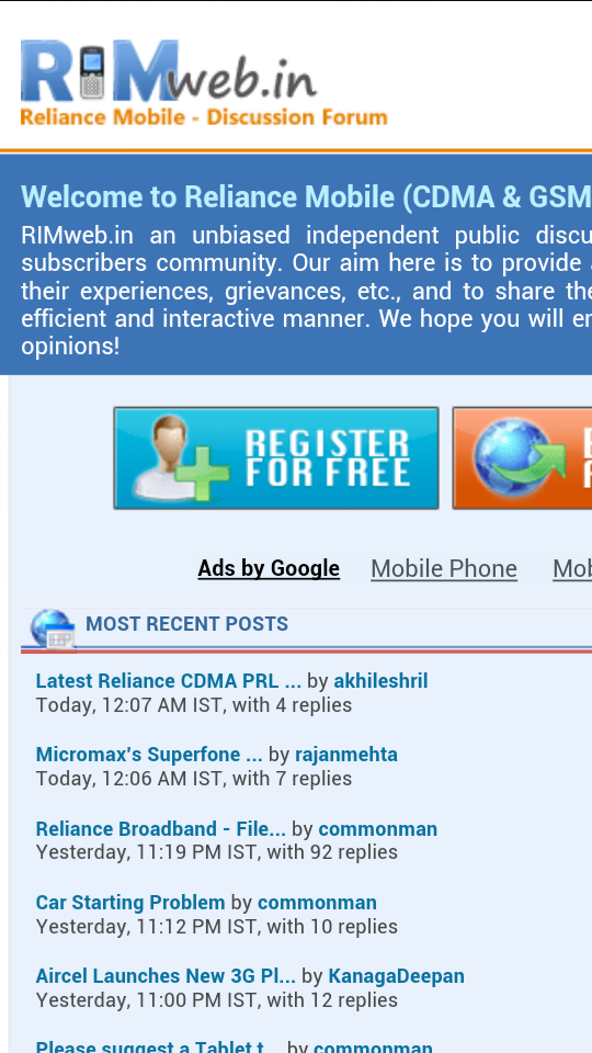

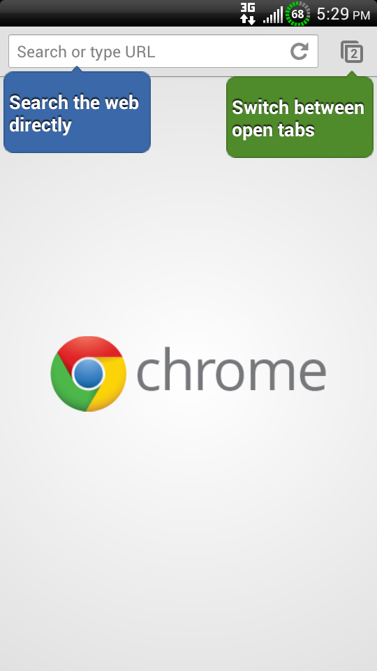

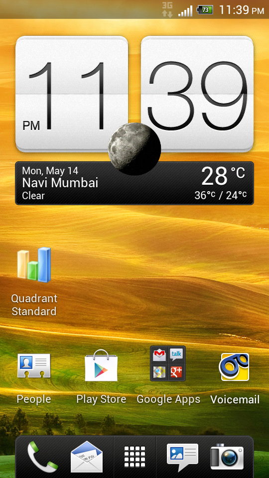

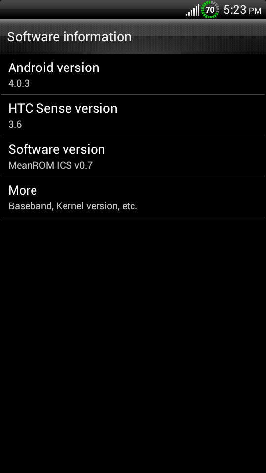

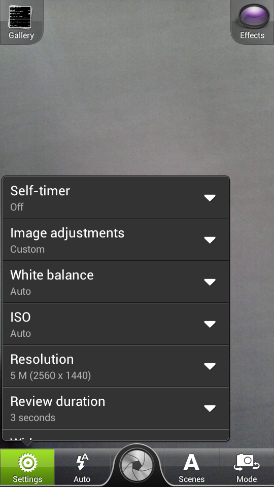

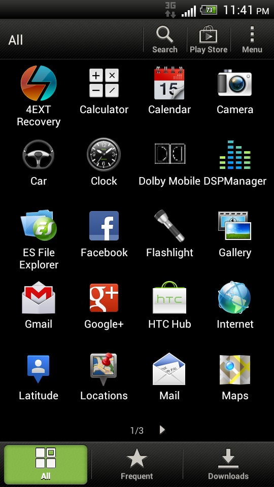

Some Screen Shots:

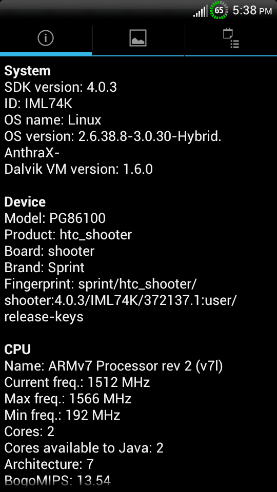

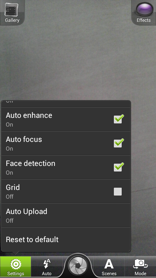

post-4104-0-17803800-1336913727_thumb.pnpost-4104-0-57642700-1336913736_thumb.pnpost-4104-0-48033300-1336913740_thumb.pnpost-4104-0-50984600-1336913743_thumb.pnpost-4104-0-05848800-1336913745_thumb.pnpost-4104-0-11721500-1336913746_thumb.pn
post-4104-0-72789200-1336913748_thumb.pnpost-4104-0-02940800-1336913756_thumb.pnpost-4104-0-36903200-1336913763_thumb.pnpost-4104-0-72400100-1336913774_thumb.pnpost-4104-0-23830900-1336913809_thumb.pnpost-4104-0-42815700-1336913811_thumb.pnpost-4104-0-17688300-1336913814_thumb.pn

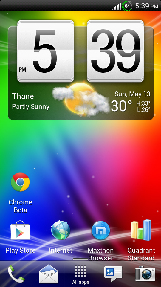

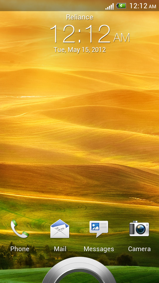

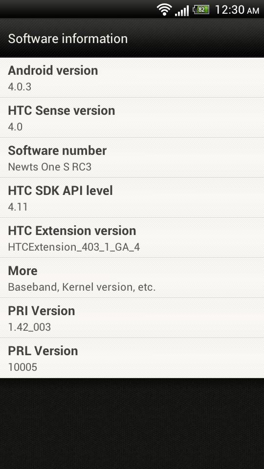

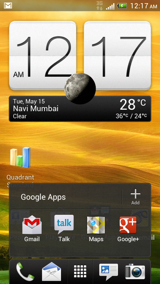

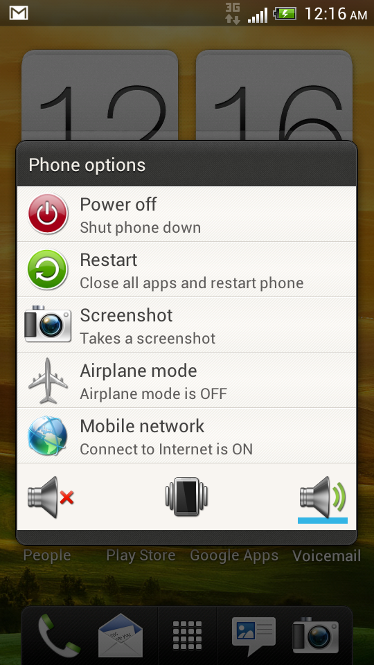

Screen Shots:
post-4104-0-51812700-1337022965_thumb.pnpost-4104-0-43272500-1337022969_thumb.pnpost-4104-0-53918500-1337022981_thumb.pnpost-4104-0-01413800-1337022986_thumb.pnpost-4104-0-96890000-1337022992_thumb.pnpost-4104-0-16617900-1337023005_thumb.pnpost-4104-0-95381100-1337023007_thumb.pnpost-4104-0-63204800-1337023009_thumb.pnpost-4104-0-91490300-1337023012_thumb.pn

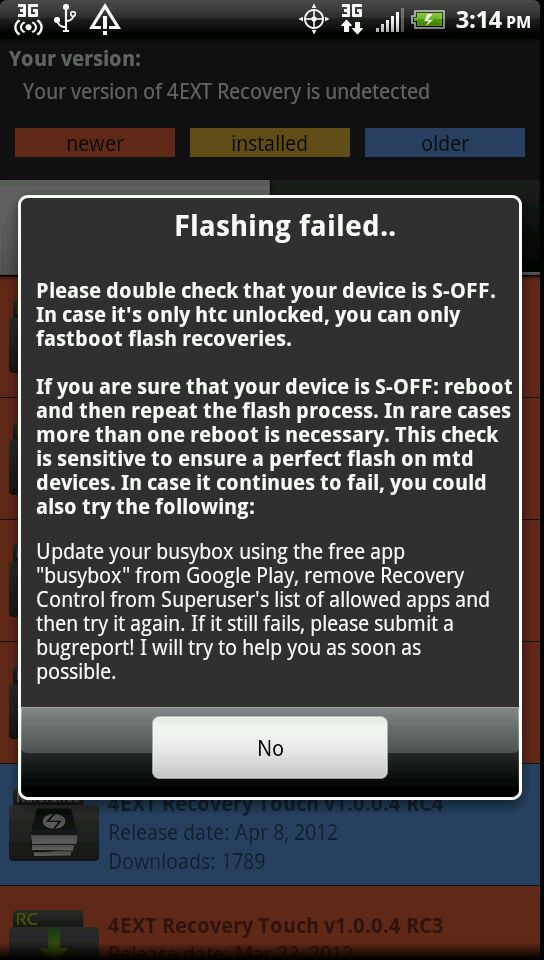

Rajan ji getting the attached error while updating.
Any pointers..
post-77159-0-92661900-1338112223_thumb.j
Edited by PKC19
You may not be actually S-OFF and selected that option.
Are you rooted? And did 4Ext Touch Recovery ask for super user permission while flashing it from phone? If So, give it.
Also select Smartflash (S-On) in 4Ext Touch Recovery installer while flashing it from the phone (If your device is S-ON with HTC Dev Unlock).
Also keep the data on as it downloads some files for detecting the device model during installation.
I am S-ON
No it is not rooted.It isnot asking for super user permission.
It downloads the files after file download is complete it starts the installation process and then the above message comes.
Root the phone, do HTC Dev Unlock if you haven't already and then try again with the pointers in earlier post.
