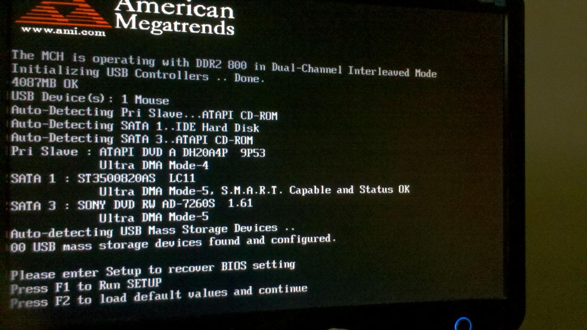

tanveer 59 Report post Posted May 28, 2012 (edited) I have a dual boot windows 7 and ubuntu PC. Since last 2-3 days, it reboots on its own and I see the screen attached. If I press f2, I can boot into any of the systems but then the system reboots again. What can be the problem and possible solutions? I hope my hard disk is not failing. I am tired of corrupt hard disks Specs of my desktop intel Core 2 duo 2.4ghz processor 4 GB DDR 2 ram Asus motherborad Edited May 28, 2012 by tanveer Share this post Link to post Share on other sites
Genius 817 Report post Posted May 28, 2012 There is nothing that we can tell by your screen shot ... It's normal I think the problem lies in your PC CPU fan or SMPS fan - or your system is getting heated by other means. Needs Chilling Share this post Link to post Share on other sites

ami1 237 Report post Posted May 29, 2012 (edited) BIOS is not reporting any problem - its only saying it couldn't load saved settings. This happens either on hardware change OR because BIOS CMOS battery is down so it can no longer keep BIOS settings saved and loads defaults every time. There's nothing wrong with any hardware or OS or windows/linux Bootloaders Do the following:- 1. Press F1 to go into BIOS and then select option to "Save and Exit". Then reboot. 2. If you still get the same message try removing your USB mouse and rebooting and do F1 >> Save again once. 3. If you still get the message then replace your BIOS CMOS battery There's no issue if you keep using the PC with F2 load defaults every time till you get time to replace cmos battery. Its not critical. Edited May 29, 2012 by ami1 Share this post Link to post Share on other sites

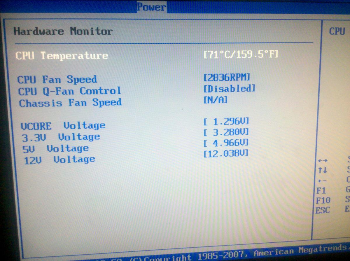

tanveer 59 Report post Posted June 6, 2012 I tried to disconnect the mouse. Did not work. I checked the cpu temp. Attached SS Please opine Share this post Link to post Share on other sites

tanveer 59 Report post Posted June 7, 2012 Is the temperature ok?? Share this post Link to post Share on other sites
rajanmehta 4,056 Report post Posted June 7, 2012 No Share this post Link to post Share on other sites
