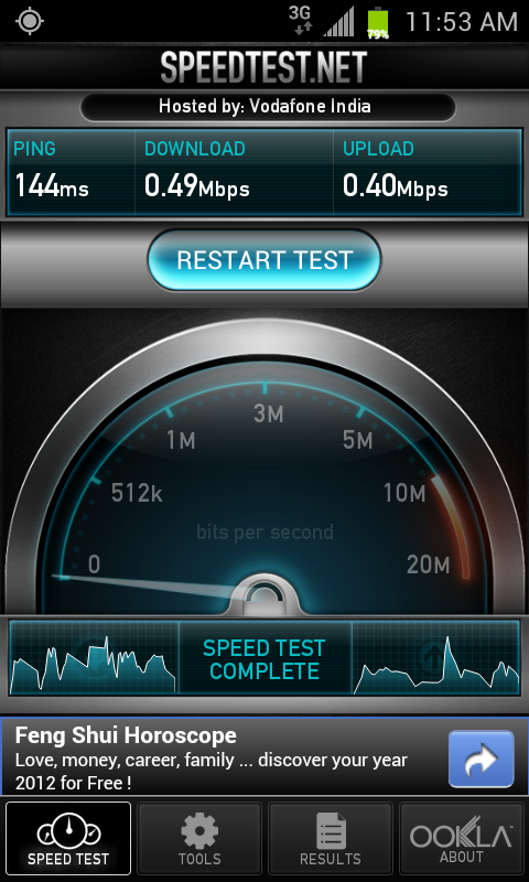

dkaile 1,051 Report post Posted August 14, 2012 (edited) The Reliance network on EVDO is really going from BAD to WORSE. It is giving pathetic EVDO speeds in my city. Earlier I used to constantly get about 1MBps (even that is quite low) but now I never get more than 0.5Mbps at Meerut. Reliance should wake up and pay attention to their network otherwise loyal customers like us will very soon shift from them. A screenshot of the EVDO speed at Meerut on my S2 is attached - Comments please especially from Tier 2 city EVDO customers. Edited August 14, 2012 by dkaile Share this post Link to post Share on other sites

Arun 795 Report post Posted August 14, 2012 Tower must be VERY close to you? I got around 2.5 mbps too when I was in Mumbai hotel in Bandra and yes it was showing full signal. Share this post Link to post Share on other sites
kshah 452 Report post Posted August 14, 2012 I remember posting thread about EVDO speed long back, in ahmedabad it has been poor since - if not more about 2 years. There are very few locations where speed exceeds 1 Mbps. Most of the time it is 600-800 kbps. Share this post Link to post Share on other sites
rajanmehta 4,056 Report post Posted August 14, 2012 Tower must be VERY close to you? I got around 2.5 mbps too when I was in Mumbai hotel in Bandra and yes it was showing full signal. 500 meters approx. But even otherwise, speeds are good/bearable in Mumbai at most places. Share this post Link to post Share on other sites
@mitJ@in 256 Report post Posted August 14, 2012 @dkaile - Sir Sprint Proxy to nahi lagi hui? Share this post Link to post Share on other sites
