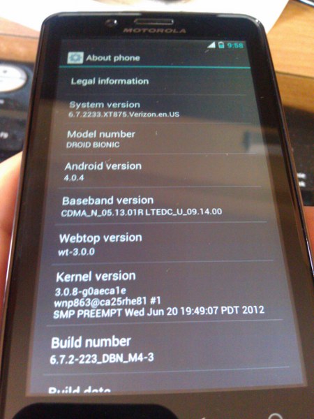

kundalus 24 Report post Posted June 21, 2012 Hi! Some good news for Bionic users, A ICS leak has surfaced via cheescake app. The app is said to be able to scan Motorola servers which is used to store their internal roms. Some users at droidhive have been able to install this leak and its said to be working fine except front cam. The ICS is flashable and boots into ICS. Below is the link to the ICS ROM http://d-h.st/wO6 (courtesy: husker_fan @ droidhive) It is usable as of now but would suggest if we can wait for further on it as P3 has already said it is rootable and he is working on it. More details is expected in a day or two and we should have a flashable ICS rom with everything fixed. Share this post Link to post Share on other sites
KapilAgrawal 340 Report post Posted June 22, 2012 (edited) ICS for Motorola Droid Bionic leaked, Some people report it to be stable. Version 6.7.2233. We should have official ICS by next month end or a stable leak. Update the leaked version at your Risk. http://forum.xda-developers.com/showthread.php?t=1724541 Edited June 22, 2012 by KapilAgrawal 1 Share this post Link to post Share on other sites
kundalus 24 Report post Posted June 22, 2012 the ICS build for Bionic is very stable and its possible to roll back to .902 from this leak. Its also possible to preserve root using voodoo root keeper. Will try it out tonight on the bionic and update it here. Share this post Link to post Share on other sites
kundalus 24 Report post Posted June 22, 2012 have successfully booted to bionic ICS build. Will update a review soon.... Share this post Link to post Share on other sites

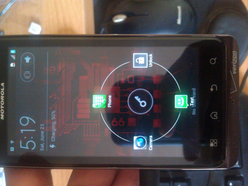

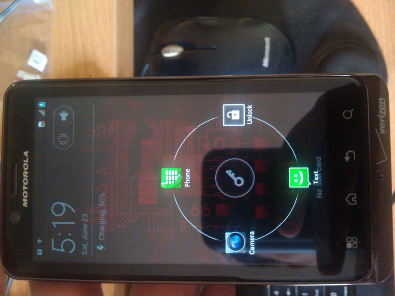

kundalus 24 Report post Posted June 23, 2012 Hi! guys, Bionic ICS leak .2233 is here. I found a few change in the new ICS leak ROM worth a mention. The phone also works on CDMA UIM card without any hack. Somehow i managed to get GSM working on it but the network slipped and is does not connect to gsm network as earlier. Burst Camera...Yes...The camera has a burst mode with stock app. You can take 6 images at a time at 4MP and the outcome is rally nice. It takes 6 images in almost 1 sec and the outcome is also really great. Also the stock camera app has a feature to stop camera shutter sound which is difficult to find in stock roms. Motorola smart actions, one of really nice apps if you want to create customization as per your requirement like turning on bluetooth at certain time, switching off Mobile data, connecting wifi, etc and is really nice and worth a try. Another good feature is lockscreen, lock screen is really nice with 4 shortcuts and also silent/ringing mode on top. Other enhancement are pretty same and not really much changes than other ICS roms, Moto has tried surprisingly implemented home app similar to ICS launcher. 1 Share this post Link to post Share on other sites
