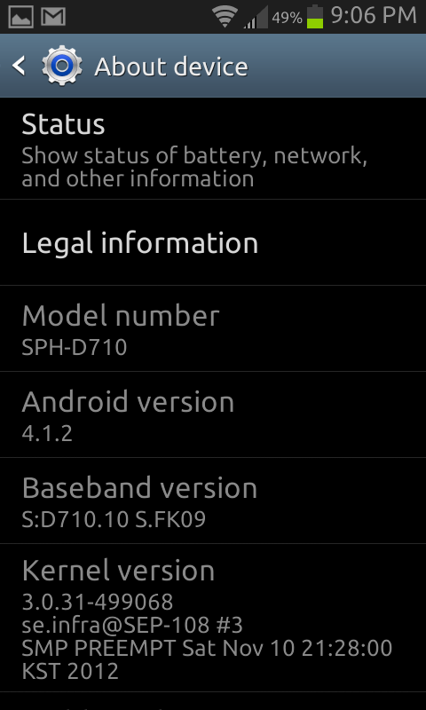

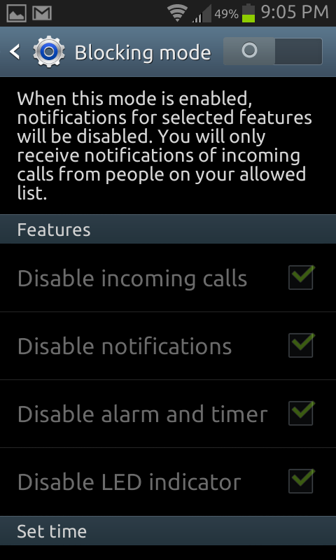

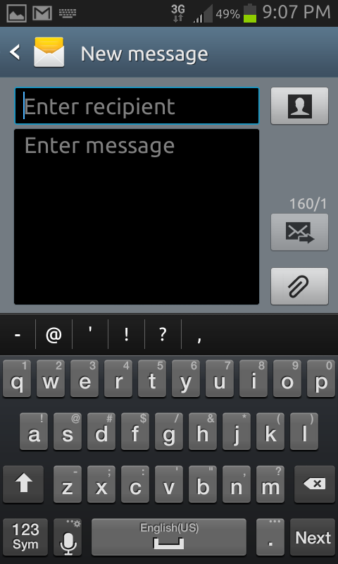

FK09 JELLYBEAN LEAK FOR SAMSUNG GALAXY SII EPIC 4G TOUCH - 20/11/12

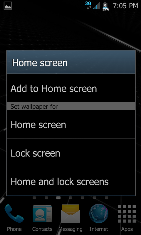

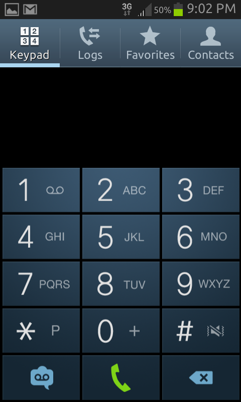

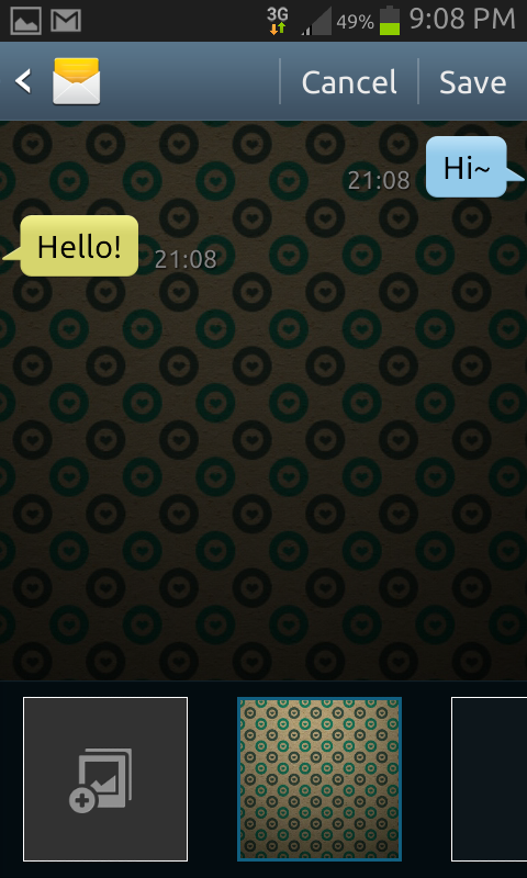

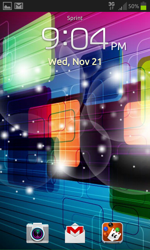

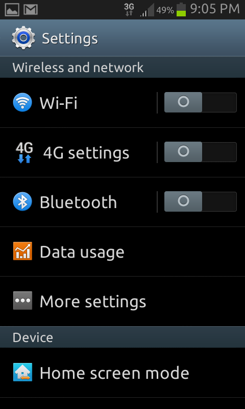

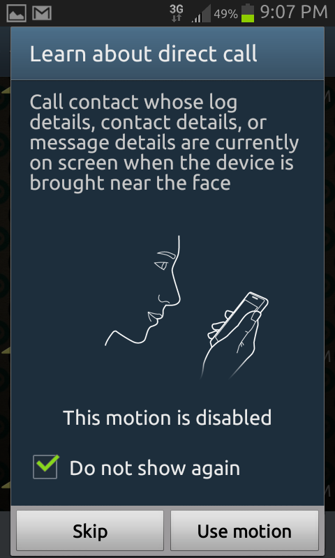

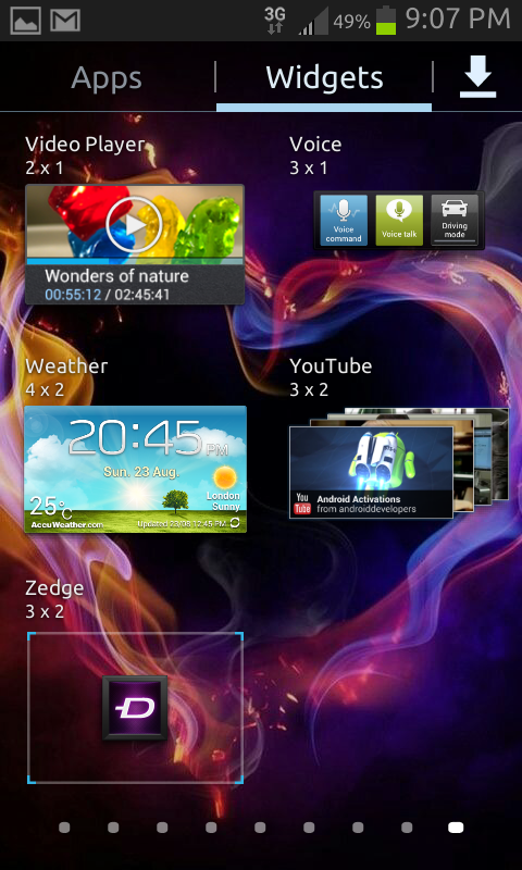

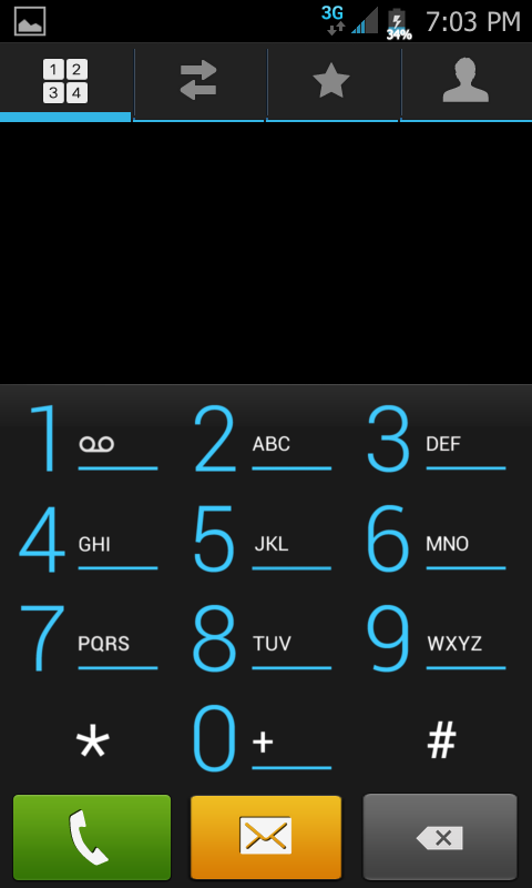

Ok !!!! since yesterday night i have been using the JB leak , and its by far stable enough, Barring TWO calls related issues which i have mentioned below and which can be by and larger easily sorted ( may be not 100% )
So sharing the First Properly working and really awesome LEAK of JB for EPIC 4G TOUCH
Personal Review : its awesome , so many options and so damnh smooth and crisp looking , i have fallen in love with my E4GT again ;), If you havent tried it already then go and download and come back later to Thank me ( for leeching and posting the link ;P , all i did was simplify the flashing process )
post-75231-0-02858000-1353512587_thumb.ppost-75231-0-36418100-1353512725_thumb.ppost-75231-0-78723100-1353512552_thumb.ppost-75231-0-70162400-1353512567_thumb.ppost-75231-0-62515700-1353512617_thumb.ppost-75231-0-55625700-1353512640_thumb.ppost-75231-0-93802200-1353512649_thumb.ppost-75231-0-45767600-1353512672_thumb.ppost-75231-0-34294500-1353512679_thumb.ppost-75231-0-78525100-1353512689_thumb.ppost-75231-0-99864200-1353512707_thumb.ppost-75231-0-98599800-1353512746_thumb.ppost-75231-0-99848900-1353512755_thumb.ppost-75231-0-99352400-1353512773_thumb.ppost-75231-0-50676100-1353512792_thumb.p

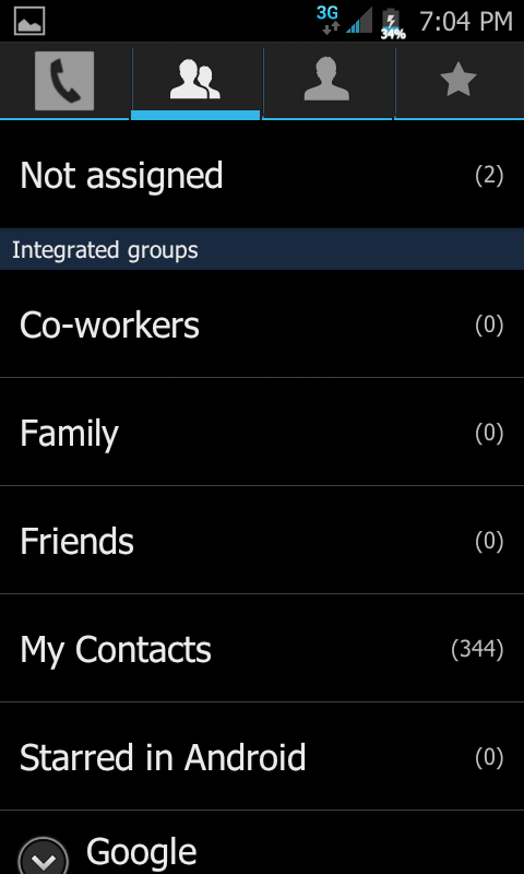

Please read carefully - this is important if you are planning or have flashed the Fk09
the most ( and i hope the only ) evident bug in Fk09 is phone freezing , and becoming totally unresponsive if a call is received from or made to a contact in your phonebook with a pictures.
The easiest method is
1.. download contact picture remover app from playstore and install it
2.. switch off your data connection
3.. run the app and it will remove all pictures from your contacts
4.. once you do this > go to settings > accounts > google > and tap the gmail account in which you have stored all your contacts > UNCHECK the SYNC CONTACTS option
5.. and thats it , you can now switch on the data
Plz note from now on whatever contact you are gonna create in your phone , will only be stored in phone only and it wont get updated to your address book in gmail account , so plz keep it in mind
Once a new leak or official OTA comes which has the above bug fixed you can start the contacts syncing again. , till then you wont be able to see the pictures of your contacts on ur phone.

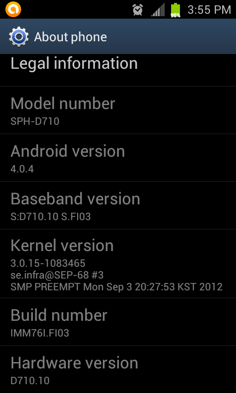

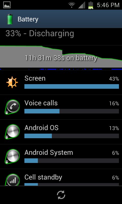

HOW TO UPDATE YOUR EPIC TOUCH TO THE LATEST ICS LEAK - FI03 - as on 14-09-12
I am using FI03 myself and i can safely say its not at all a battery HOG as the other ICS updates before this.
Signal strength is also better.
Try it

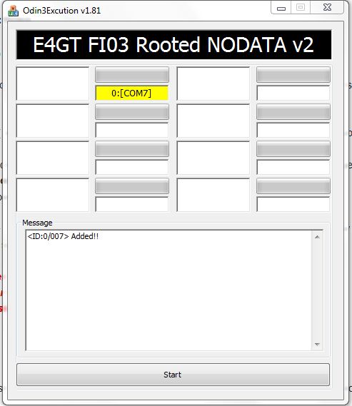

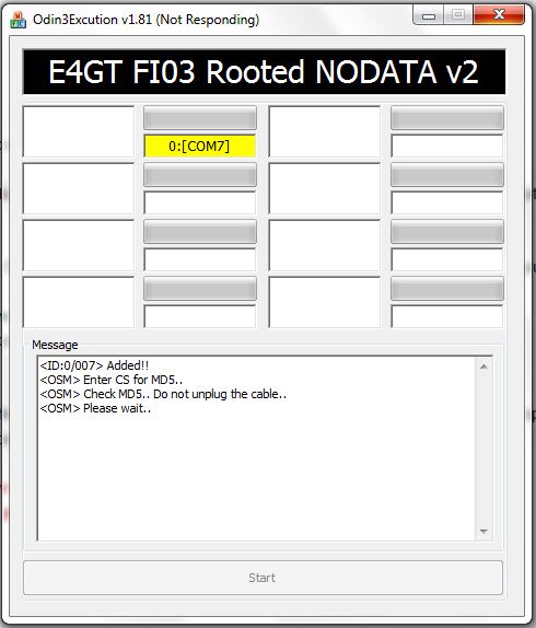

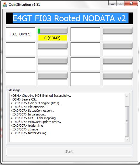

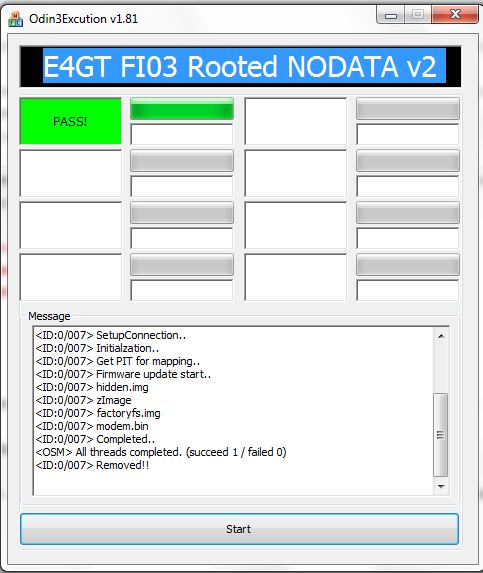

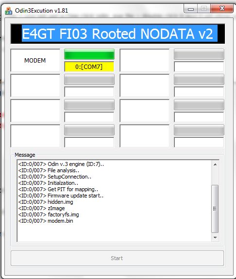

STEP BY STEP FLASHING INSTRUCTIONS
1.... If you havent installed SAMSUNG USB DRIVERS then do it now - link is there above.,
2... If you were on any previous rooted build then its better to backup your apps ( with mybackup root ) and contacts ( with either mybackup root or super backup) on your SD card.
3.... unzip the above mentioned files ( whichever suits you ) using 7zip > you will get a One click odin .exe file > double click it and it will show you a odin window
4.... Power down phone Wait for capacitative button lights to turn off .( please note its better to let the phone to get completely turned off )
Simultaneously Press and Hold [Power] and [VolDn] until a confirmation screen appears,
after that Press [VolUp] to enter Download mode
5.... Now you are in download mode > connect your PHONE with the PC using the usb cable > your phone will show in a yellow box in the just opened odin window. with a yellow COM PORT NUMBER ( please make sure that you are using a good usb cable )
If you dont see a yellow port number on ODIN then reboot your PC and start over
If you still dont see your phone after connecting then remove phone from PC ,
Uninstall the previously installed usb drivers
reboot PC
Reinstall the same drivers
and try again
6.... hit start - in a few minutes the flash will complete and PASS or success will display on ODIN window in green color.
Onec done , either the phone will reboot itself or you can reboot it urself.
Now upon reboot , you are on stock FH03 - Rooted - with all your user data still intact if you used FILE 2 or totally stock if you used FILE 1
Have fun !!!

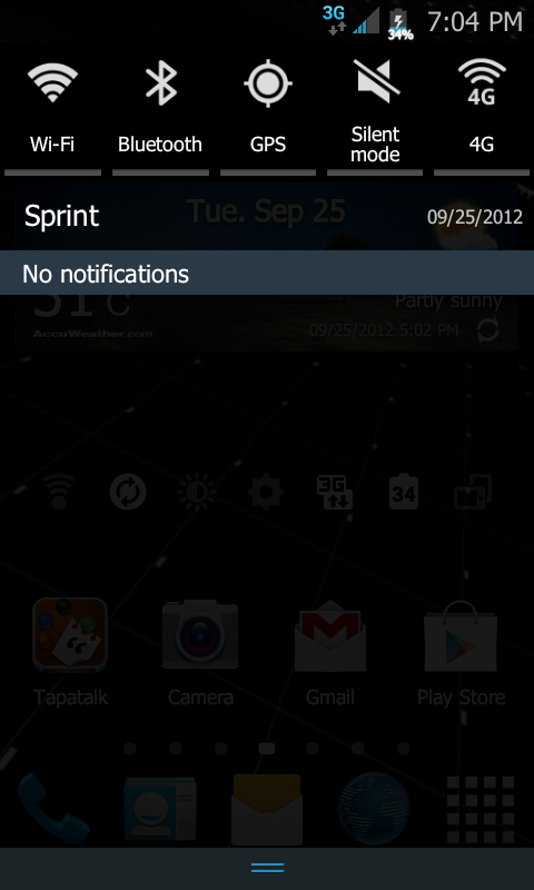

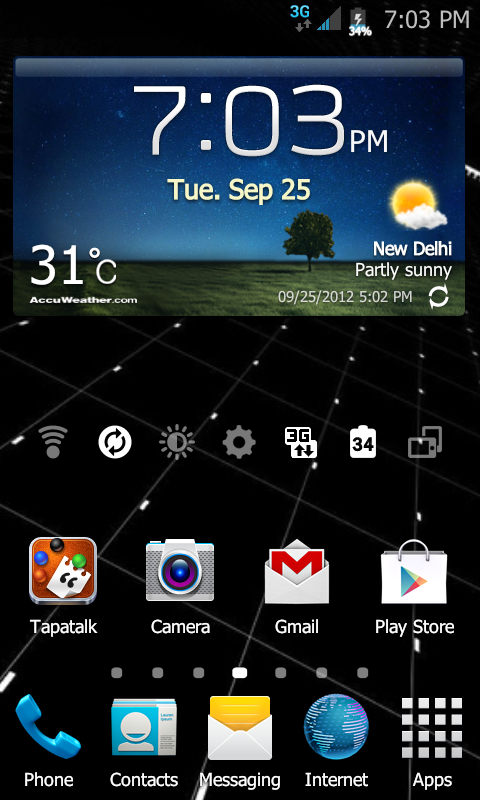

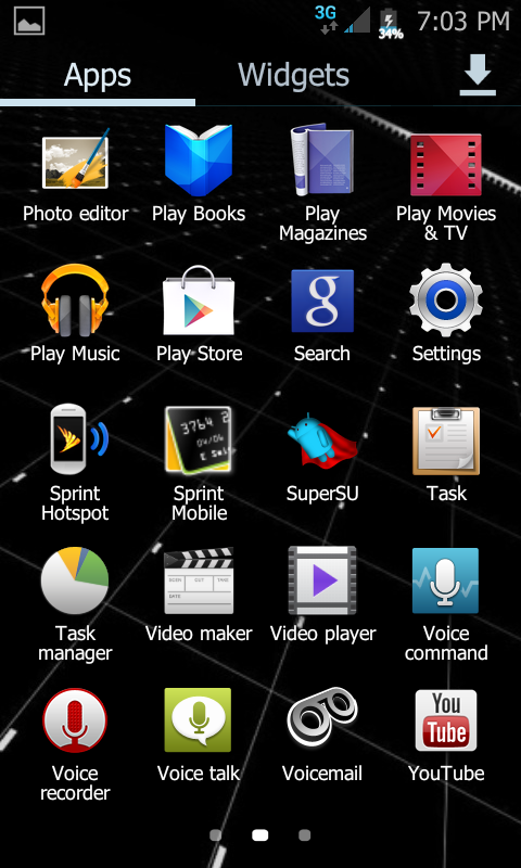

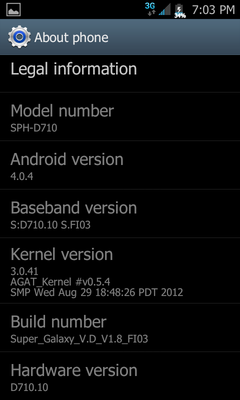

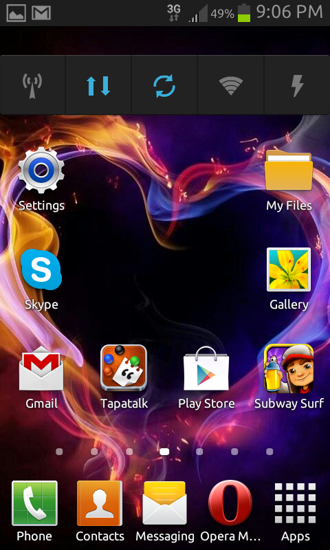

HOW TO UPDATE YOUR EPIC TOUCH TO SUPER GALAXY ROM V1.8 - FI03 based - as on 25-09-12
Ok from past 10 days i have been testing a lot of ROMS ( still giving ICS a shot , havent given up on it ;P ) ,
Out of the 4 that i have tested i found SUPER GALAXY ROM as the best
Highlights :
1.. Very smooth , very very smooth
2.. Idle battery consumption is practically zero ( when there is no 3G or Wifi or sync in the background )
3.. Fi03 based - as most of you who have flashed stock rooted FI03 are aware that its the best leak till date.
4.. Other features as outlined by the DEVELOPER socialsp
  • De-Odexed ICS 4.0.4 Official FI03 (Thanks to Sextape for the leak)
  • Rom themed with Blue ICS
  • Samsung Galaxy S3 Launcher ported for Epic 4g Touch
  • Added some awesome APPS I found around the forum
  • Added Samsung Galaxy S3 Shutdown Animation
  • Added Samsung Galaxy S3 Power on sound
  • Added Kobridge Tweak Pack v3.5(Thanks to Kobridge)
  • Added Custom Recovery re packed by agat63(Thanks)
  • SGS3 Themed dialer
  • Many more that I don't remember right now
post-75231-0-76334700-1348581960_thumb.p post-75231-0-97002300-1348581970_thumb.p post-75231-0-01048800-1348581979_thumb.p
post-75231-0-69388600-1348581991_thumb.p post-75231-0-58228100-1348582000_thumb.p post-75231-0-56499900-1348582012_thumb.p
post-75231-0-16890700-1348582021_thumb.p post-75231-0-18607900-1348582028_thumb.p post-75231-0-24725100-1348582034_thumb.p

Joshm I am now updated to FI03. ThanX for your useful tutorial. :signthankspin:

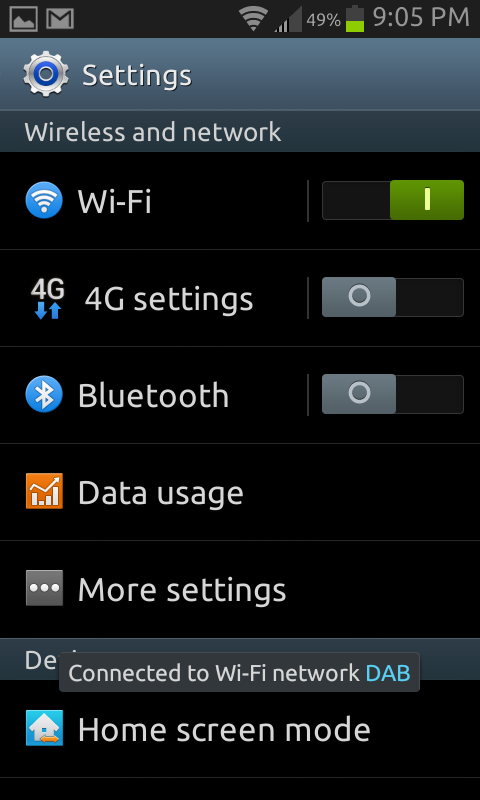

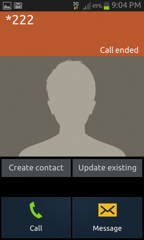

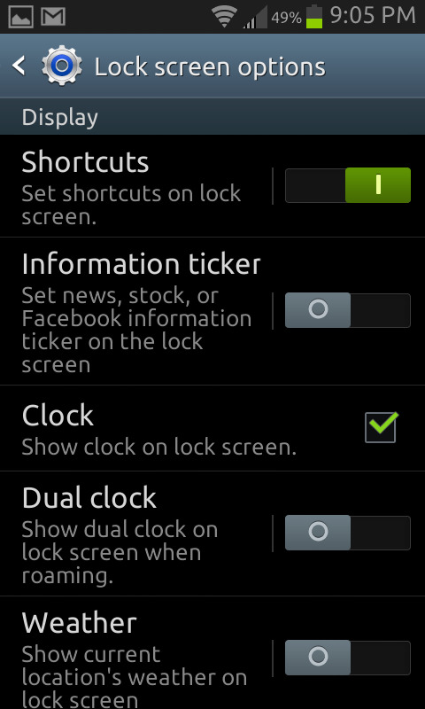

some screen shots may help others.

@ Amit : Awesome work with the images , helps a lot :)

That didnt go so smoothly for me ..um ..After ODIN green signal, my S2 was just showing the 4G logo for a very long time ... about 20 minutes ..So in spite of the warning that the 4G logo takes an unusually long time, I was forced to do a battery pull ..and re-start the process.
This time after the green signal, during the boot-up, I disconnected the phone from the PC
It worked. The Phone booted successfully and data and everything was intact.

Battery feedback
Fi03 stock rooted, most of the bloat ware removed.
