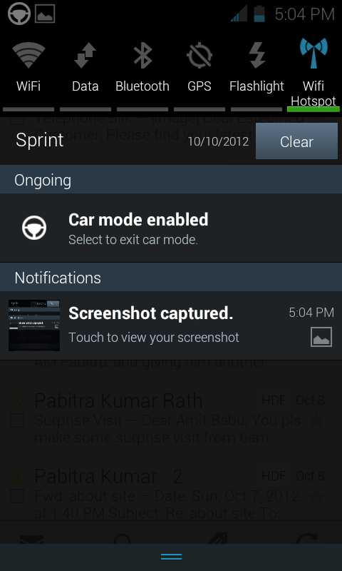

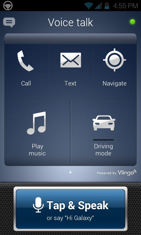

but one thing today I am conforming that it is a fault of Port only. bcoz today when I am busy with my Epic, suddenly something coming out frequently and not let me do any thing.
Here I am posting the Images.
post-69747-0-77078200-1349893482_thumb.p
post-69747-0-44760100-1349893962_thumb.p
I think why this car mode is enable. this msg only comes after it fitted in the car dock only. Then I insert the Charger and adjust it slightly by thinking is there any thing loos there. then suddenly a beep sound is coming and the phone started charging and also detected by PC. But three days back it is not there. that time also I am checking this procedure. Now I think probably it is a fault of the port.

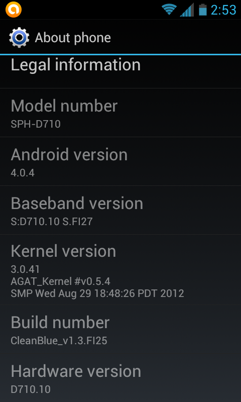

post-69747-0-81012700-1350034676_thumb.p
Successfully Flashed. Thanks again Josh. :SI:
