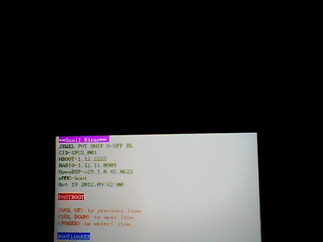

Hello,
Few days ago on xda some users successfully SOFF there phone, and slapped HTC, for there crap bootloader unlocking, I tried it and its working.
This will work on hboot 1.15 or even 1.19 latest OTA updated HBOOT.

In short how its works :-
We will intensionally brick our phone so that we can go in QC mode by flashing defected block :)
once its get bricked. We will flash old hboot 1.12 and then can do soff with lazy panda :) (as for now lazy panda only works with hboot 1.12)
please follow the step by step instructions on the above thread, If anyone got stuck, I am here to Help :)
Once you got hboot 1.12. you can run feedpanda.
I was on viperrom 2.0.2, feedpanda gives me success. I run it from linux. No need to go 1.13.
First, i tried from windows, but i got bricked. then i run evo4g lte unbricker.
I got sucess on linux on 2.13 hurray. I can see feedpanda need hboot 1.12 and rooted, for linux. 100% tested i tried it two times and got sucess. smile.gif
I guide it not noob friendly though. But It can be achieved and there is always a risk you can bricked your ph permanently. Though its a rare case.
