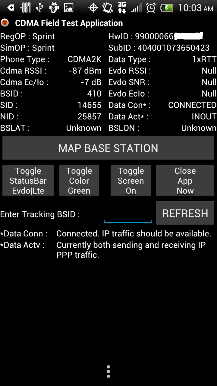

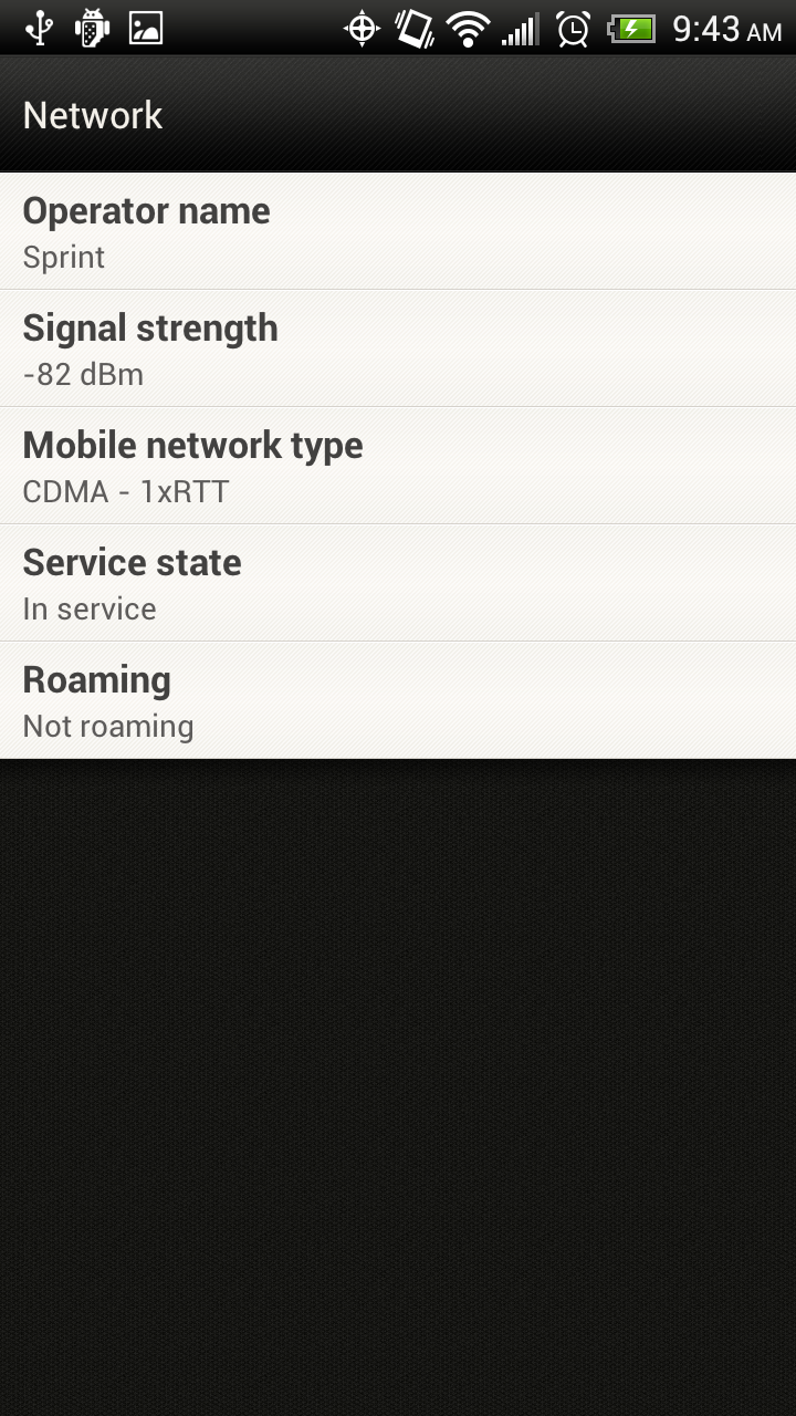

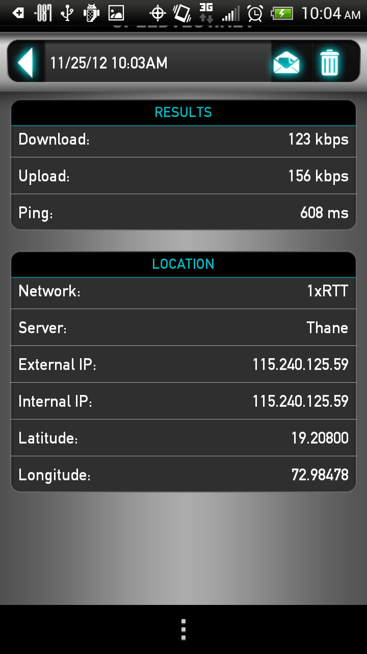

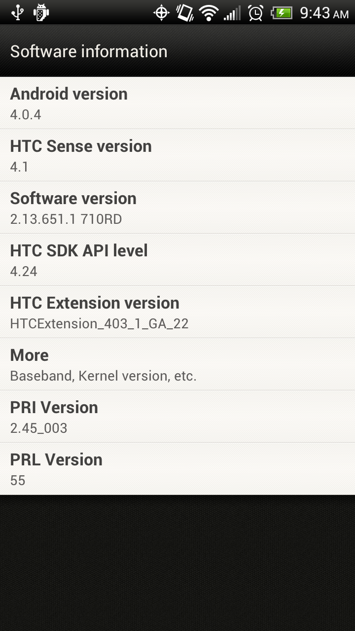

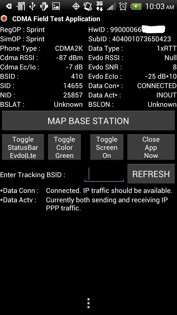

phonegeek 588 Report post Posted November 25, 2012 (edited) I was earlier posting my query on EVO 4G LTE thread but it seems that it would be appropriate here to post it since its more complex now. Hope, mode would allow this. Also, kindly move my earlier posts in this thread. Problem: I am not able to get EVDO network. Problem Description: I have Sprint EVO 4G LTE on Stock ROM(rooted). The MEID is registered and Voice, SMS and 1x are working properly. I am subscribed to MobileNet94 plan. Observations: As soon as I turn on the phone, the network starts to show 1x-RTT instead of EvDo-rev.A:8 which appears on my wife's phone. I believe whoever is using Reliance CDMA and have EVDO coverage must be getting EvDo-rev.A:8 only, irrespective of whether they use data or not. What I tried: 1. Configuring the PPP and EVDO user/pass using the dump file. 2. Manually configuring the user/pass using DFS and QPST. 3. Uploading 10005 and 55 PRL using CDMA WS, QPST and DFS. 4. Downgrading radio version for all available radios. I am now clueless as what could be the issue for not getting the EVDO network. Guys, please help.... Update : Screenshots from cdma field test app and speedtest. Edited November 25, 2012 by phonegeek Share this post Link to post Share on other sites
rajanmehta 4,056 Report post Posted November 25, 2012 Since last few days, data network is instantly going to 1X in Thane. This is even happenning with Full signal strength approx. 50 meters away from tower. Not sure whether this has got anything to do with your issue. Your signal strenth is very weak. Since you've tried everything & assuming EVDO Username/Password are correct in phone, these are further random suggestion to try. ##3282# Edit Mode Enter MSL Code which should be 000000 EVDO Check whether DDTM is disabled and Preferred Mode is CDMA HDR. Exit and reboot. One another thing. After rebooting put phone in airplane mode and then normal. Reboot again. Share this post Link to post Share on other sites
phonegeek 588 Report post Posted November 25, 2012 Since last few days, data network is instantly going to 1X in Thane. This is even happenning with Full signal strength approx. 50 meters away from tower. Not sure whether this has got anything to do with your issue. Your signal strenth is very weak. Since you've tried everything & assuming EVDO Username/Password are correct in phone, these are further random suggestion to try. ##3282# Edit Mode Enter MSL Code which should be 000000 EVDO Check whether DDTM is disabled and Preferred Mode is CDMA HDR. Exit and reboot. One another thing. After rebooting put phone in airplane mode and then normal. Reboot again. Done, DDTM disabled, CDMA HDR mode and also did airplane toggle. No resolution This is not only happening in Thane but in Mumbai too. Share this post Link to post Share on other sites
