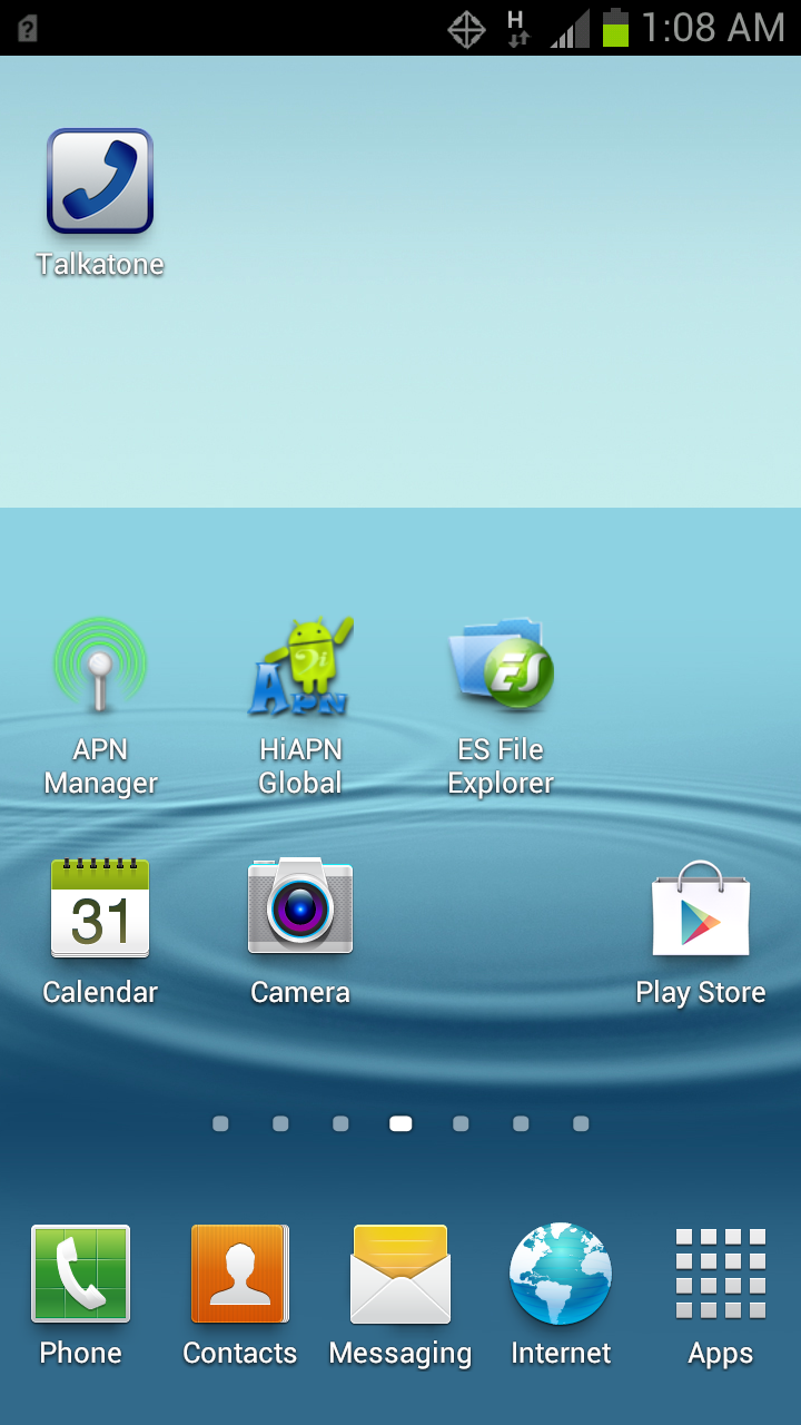

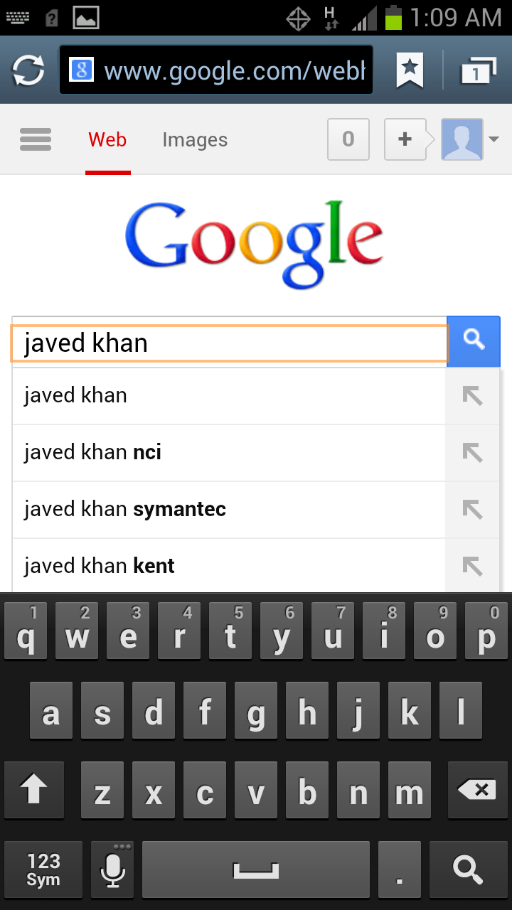

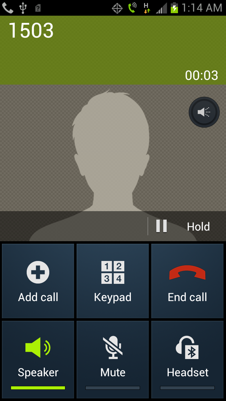

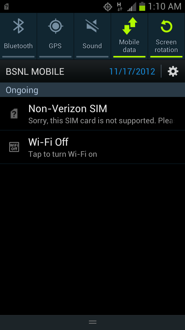

javed91214 67 Report post Posted November 18, 2012 Verizon S3 GSM DATA, CALL & MSG working without any issue here is complete tutorial with attachment where u can get data on GSM. Requirement : ICS VRLF2 , root , ES file explorer , HiAPN Global. Process: install file explorer & hiAPN start hiAPN - click on "Click to Backup APNs" goto File explorer - HiDroid_Net - HiAPN- here u found one xml file "apnlist_backup.xml" open xml file with ESNote Editor- & edit 1st line <?xml version='1.0' encoding='UTF-8' standalone='yes' ?><apns><apn name="bsnl" numeric="310004" mcc="404" mnc="066" apn="bsnlnet" u can also replaced with attached xml file. again start hiAPN - click to restore APNs- reboot ur phone after 15-30 mnt u'll get data icon 3g/H+ on notification area. Good Luck.. apnlist_backup.rar 1 Share this post Link to post Share on other sites

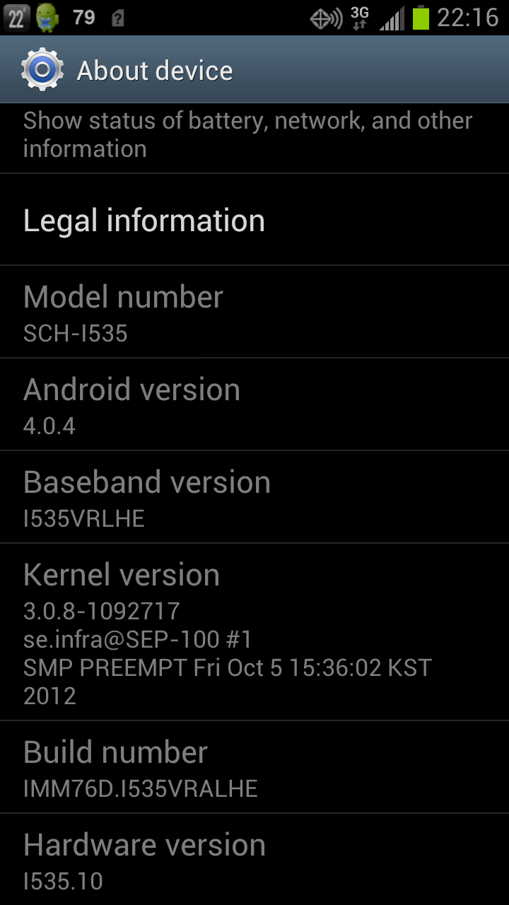

sliver1 102 Report post Posted November 21, 2012 im using verizon s3 i535 and both cdma and gsm is working fine for me. Cdma is my primary use. Still have used gsm for some calls and havent tried data though. Did auto select apn via hiapn. In settings and mobile network it shows idea internet. Share this post Link to post Share on other sites
