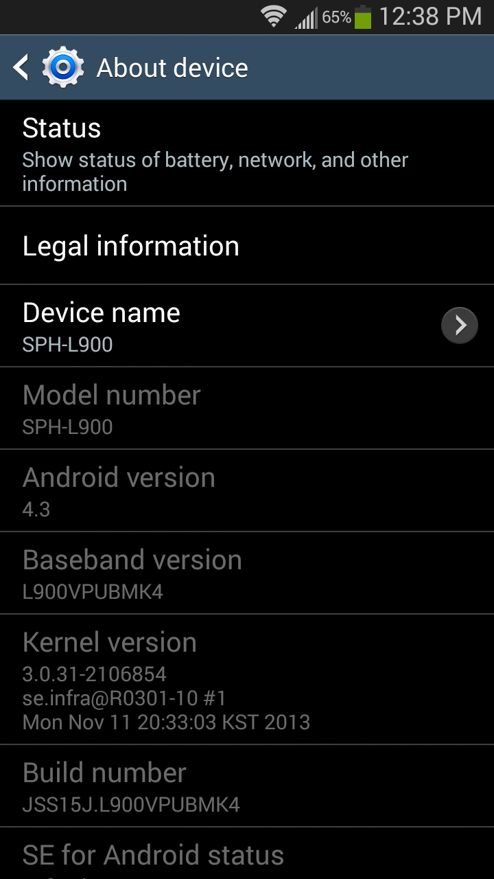

puneet_si 1 Report post Posted November 28, 2013 (edited) Any one tried updating? Updated to 4.3 through zip (knox-free) available at XDAdevs (didn't receive any OTA notification), seems to be working fine so far. EDIT: Facing the Youtube issue (as Javed has mentioned), i tried doing what DK and Doc have suggested but i see no Multimedia option under the 'Others' menu (in ##3282# menu). Am using a Sprint note 2, any pointers? Screenshot_2013-11-18-12-12-53.png Was also able to sort this issue after updating to 4.3 (Multimedia option appeared and proxy changed to 0.0.0.0) Edited November 28, 2013 by puneet_si Share this post Link to post Share on other sites

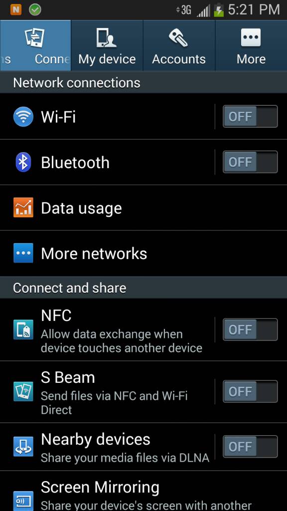

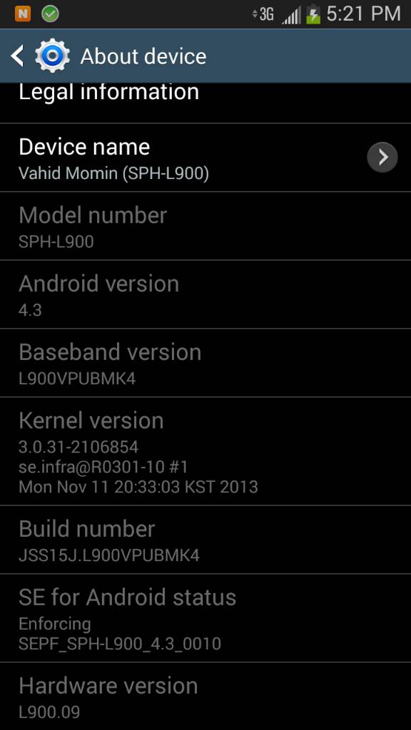

vahidmomin 66 Report post Posted December 7, 2013 Installed deodex 4.3 MK4 from http://forum.xda-developers.com/showthread.php?s=700d488a9ce3ebb341dcb0dc3a12d895&t=2541395 Still showing error of Activation not completed. Looking for hotspot , no hotspot in it. Any suggestion for activation and hotspot? Sent from my SPH-L900 using Tapatalk 2 Share this post Link to post Share on other sites
::Hitesh:: 1,763 Report post Posted December 8, 2013 ^^^ hope you applied hostpot patch thru zip, avilable in rom link you took mk4 Share this post Link to post Share on other sites
vahidmomin 66 Report post Posted December 8, 2013 Ya.applied bt still no hotspot.dont know wts going wrong.... Sent from my SPH-L900 using Tapatalk 2 Share this post Link to post Share on other sites

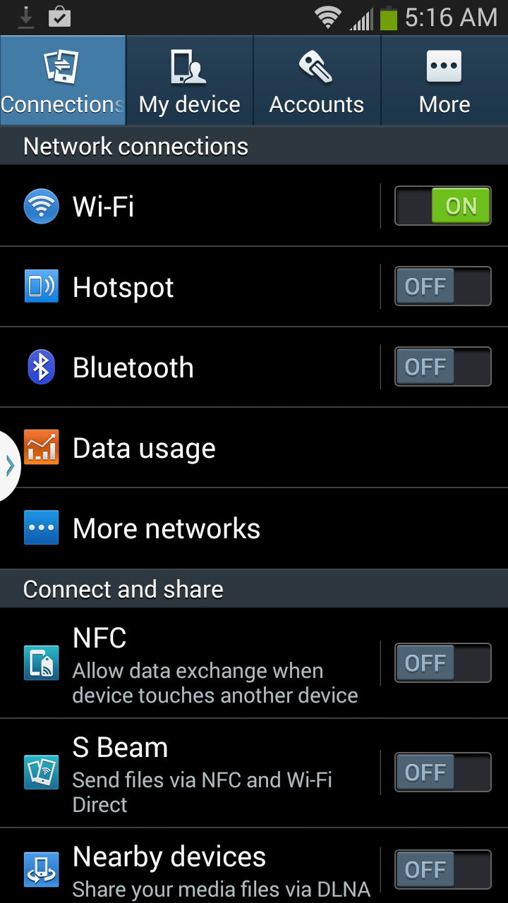

::Hitesh:: 1,763 Report post Posted December 9, 2013 there are two version of MK4 I used and wifi hotspot work fine MK4 4.3 Deodex Full Rooted 12/4 Share this post Link to post Share on other sites

ankurcshah 112 Report post Posted December 9, 2013 It's a flash through recovery, jsut flash cwm 6.0.2.5 and wipe data factory reset,wipe cache,wipe dalvik cache and flsh this, then flash the wifi patch tar through odin (PDA SLOT) and you are good to go! Looks good for now, I miss the data toggle in note 2 Share this post Link to post Share on other sites
