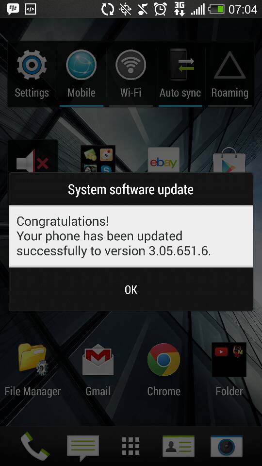

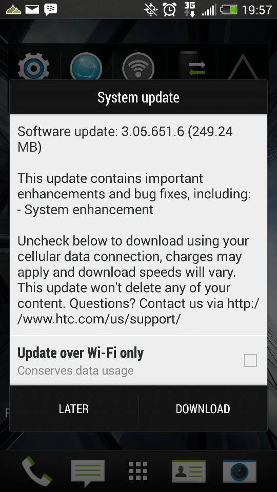

basheerbr 18 Report post Posted January 15, 2014 My Sprint HTC one shows new software update. Anyone install this updation? Sent from my HTCONE using Tapatalk Share this post Link to post Share on other sites
basheerbr 18 Report post Posted January 16, 2014 <p>I update this</p><p> </p><p>Sent from my HTCONE using Tapatalk</p><p> </p><p> </p> Share this post Link to post Share on other sites

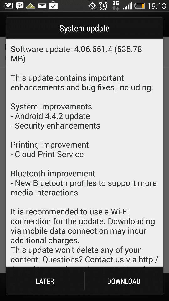

basheerbr 18 Report post Posted February 1, 2014 Sprint HTC one Kitkat update started<br /> <br /> <br /> Sent from my HTCONE using Tapatalk<br /> <br /> Share this post Link to post Share on other sites
