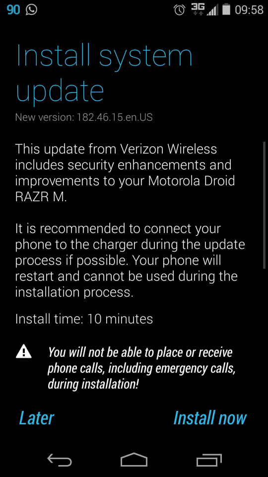

venbab 26 Report post Posted September 17, 2014 (edited) I received the attached system update notification today for version no. 182.46.15.en.us. Verizon has released this update on 9th September it does not update the rom version, it comes with some security enhancements, when checked on the internet this is what I got "this update brings in some Google security enhancements, added stability to the operating system and a better-quality messaging app over the previous build'. As anybody got this update here and updated their phones to the latest version, if yes what are the outcome of this update and is voice & data working properly after this update. Edited September 17, 2014 by venbab Share this post Link to post Share on other sites

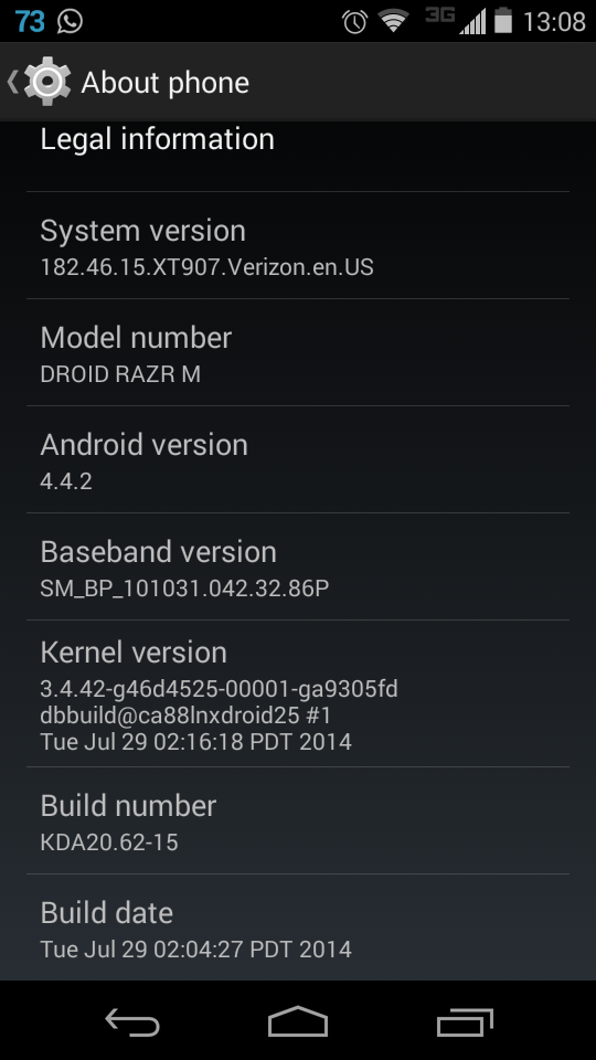

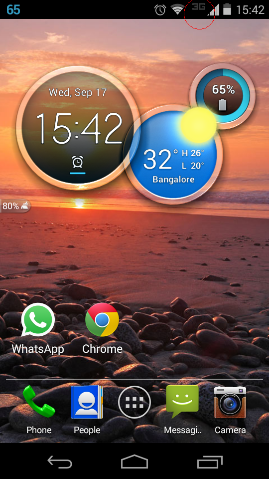

venbab 26 Report post Posted September 17, 2014 (edited) I took the risk and updated the phone as per the above mentioned update. There is no changes in the functionality of the phone voice, data & tethering all working fine. See attached screenshot of about screen after update. Eidt: The only difference is, earlier when connected to wifi it used to show faded 1x symbol next to the wifi symbol but now it shows 3G symbol as shown in the below image. Edited September 17, 2014 by venbab 2 Share this post Link to post Share on other sites

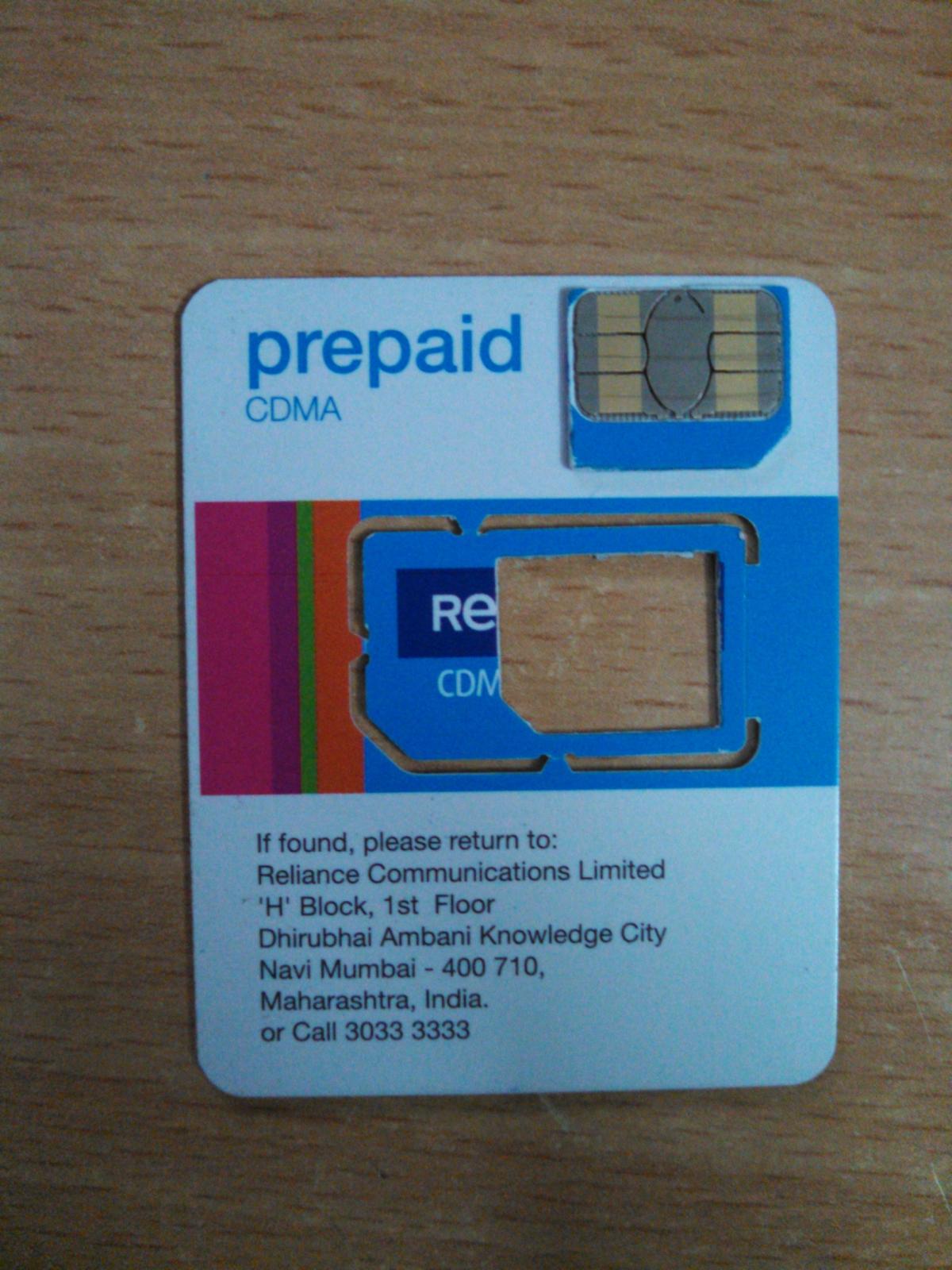

venbab 26 Report post Posted September 20, 2014 One of my colleague has the same phone and data was not working on his old sim on this phone. He bought a new sim card with series RGERUC0008***** and data is working now. Please find attached photo of the sim card. On this phone data works only on the sim cards with smaller design cards and does not work on the old design cards (Credit card sized cards). Share this post Link to post Share on other sites

slightee 5 Report post Posted September 21, 2014 On 9/20/2014 at 5:56 AM, venbab said: One of my colleague has the same phone and data was not working on his old sim on this phone. He bought a new sim card with series RGERUC0008***** and data is working now. Please find attached photo of the sim card. On this phone data works only on the sim cards with smaller design cards and does not work on the old design cards (Credit card sized cards). sim.jpg Did you friend add any APN settings for getting any data? Share this post Link to post Share on other sites
