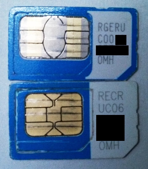

venbab 26 Report post Posted December 29, 2014 I just tried a SIM with series RECRUC06xxxxx, but it still did not show APN options. Are there other ways to ensure 3G if APN does not show? Venbab i have RECRUC611, but no option show there I have mentioned above that sim cards with series RECRUC05 or higher will work based on the other users experience, however I have used 3 different sim cards with RGERUC0008***** series on 2 different handsets and have got APN add option on all sim cards. If I am correct, 3G will not work on this handset without APN. Share this post Link to post Share on other sites

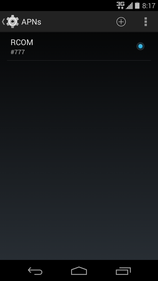

user.name 2 Report post Posted January 8, 2015 After many research finally i got the way to use reliance evdo on STOCK KITKAT (TESTED ON DROID RAZR M). 1- First of all you need a blank reliance reliance standard omh ruim having series starting from RGER UC XXXX. Picture for reference - 2 - visit reliance store and transfer your cdma no to the new RGER UC XXXX series RUIM. 3 - insert new into handset, then go to SETTINGS>MORE>MOBILE NETWORKS>ACCESS POINT NAMES. now you can see a + sign in top. picture for reference - 4 - click on + sign and fill the setting as below - name - RCOM apn - #777 proxy - leave blank port - leave blank user name - net password - net server - leave blank MMSC - leave blank mms proxy - leave blank mms port - leave blank mcc - 404 mnc - 00 authentication type - PAP or CHAP apn type - leave blank apn protocol - leave blank bearer - leave blank then save the settings and select the RCOM profile. hurray.. enjoy.. just enable the data. FOR ANDROID 4.1.2 - need sim series RCER UC05 / RGER UC (RECR UC06 NOT WORK) FOR ANDROID 4.4.2 - RGER UC (RECR UC06 NOT WORK) 1 Share this post Link to post Share on other sites

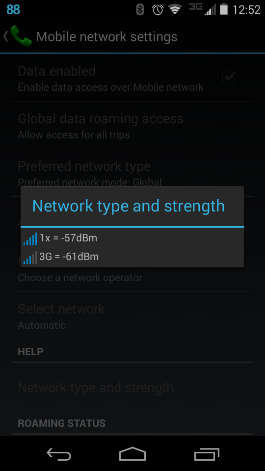

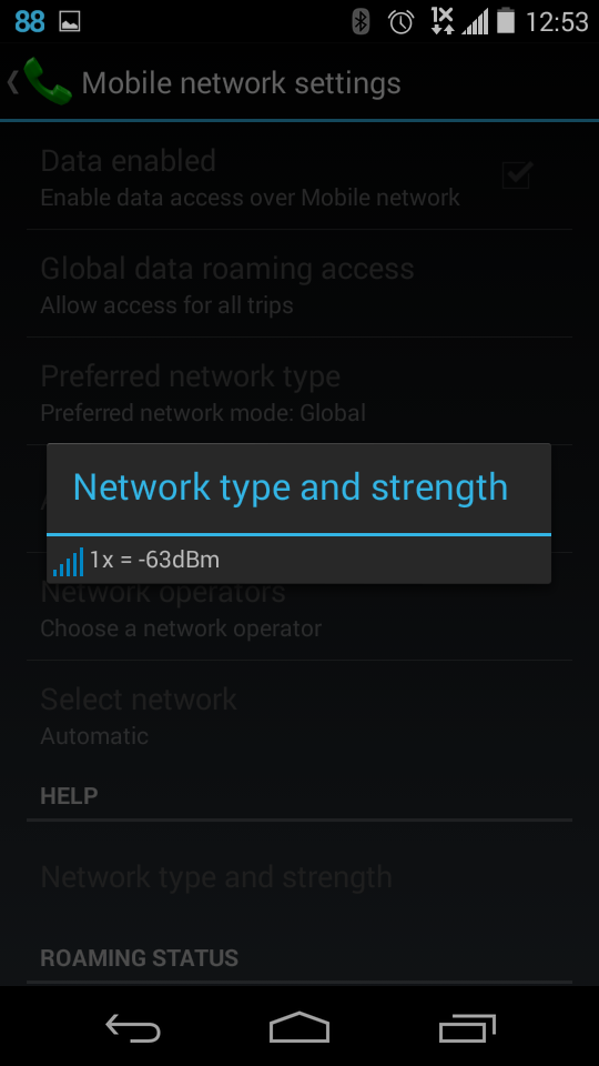

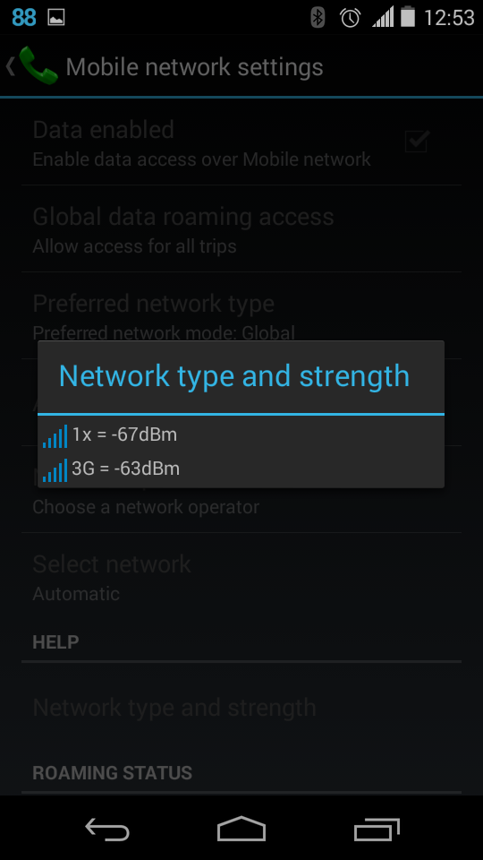

venbab 26 Report post Posted March 12, 2015 (edited) Off late My Droid Razr M is always only on 1x and it very rarely gets into 3g. Whenever I am on wifi the netwrok type and strength shows both 1x & 3g as in the below image It shows both 3g & 1x signals as soon I switch off the Wifi network. But it shows only 1x in a short while and latches onto only 1x signal Anyone else facing this problem. Also during my recent trip to Chennai the data connection was disconnected as soon as I entered Tamil Nadu and it was restored back only after I entered Karnataka. Can anyone help me out with a solution for the above problem. Edited March 12, 2015 by venbab Share this post Link to post Share on other sites

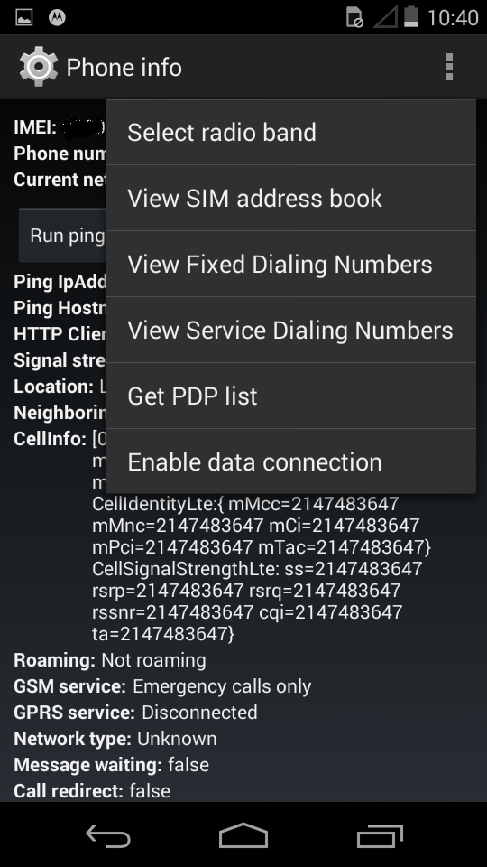

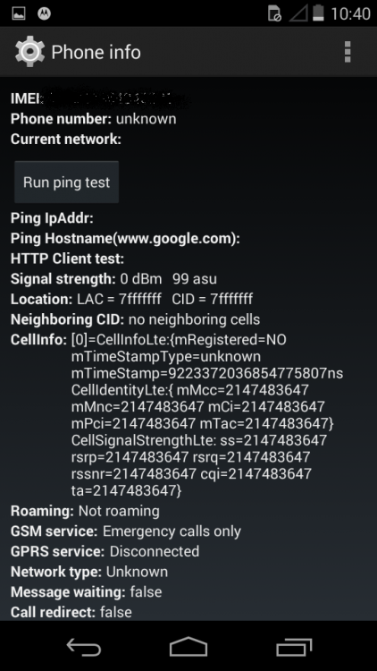

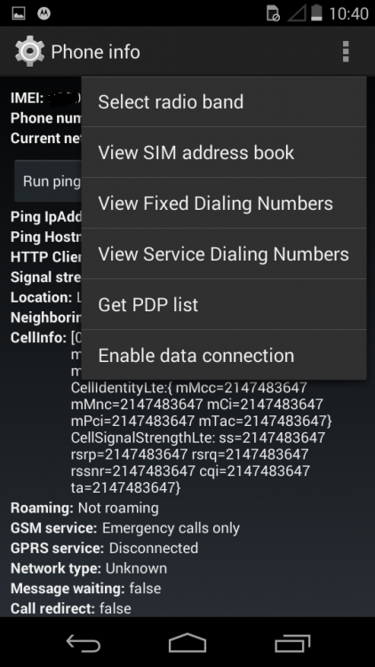

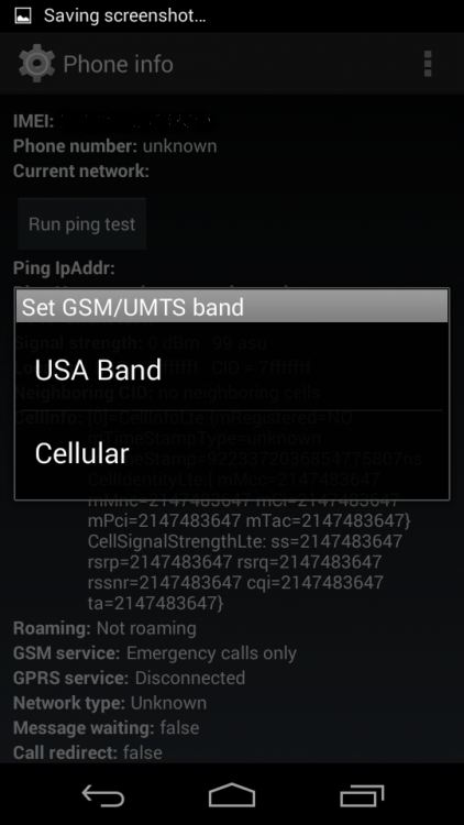

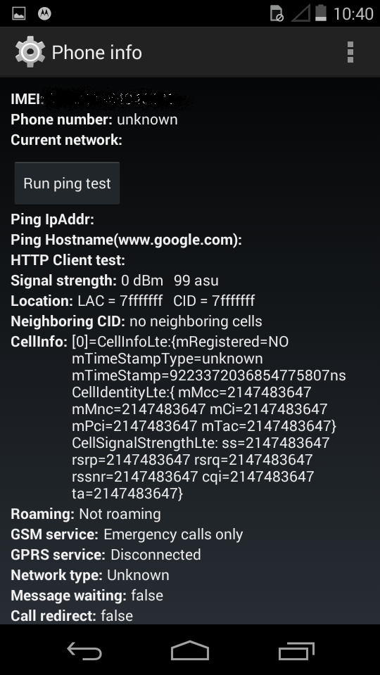

amtrag 20 Report post Posted July 12, 2016 (edited) Gurus please help me. I was using GSM sim with this handset and it was working fine with voice & data both. Just out of curiosity, I entered the Network testing menu - see first picture. Then I changed the radio band to "USA band". - see pics 2 & 3. Now, I have tried all permutations & combinations of radio band (i.e. USA Band & Cellular) with different "network types". But it is just not connecting to the network. The sim is OK because the same sim works in other handsets. I even did hard reset but still no luck. Edited July 12, 2016 by amtrag Share this post Link to post Share on other sites
