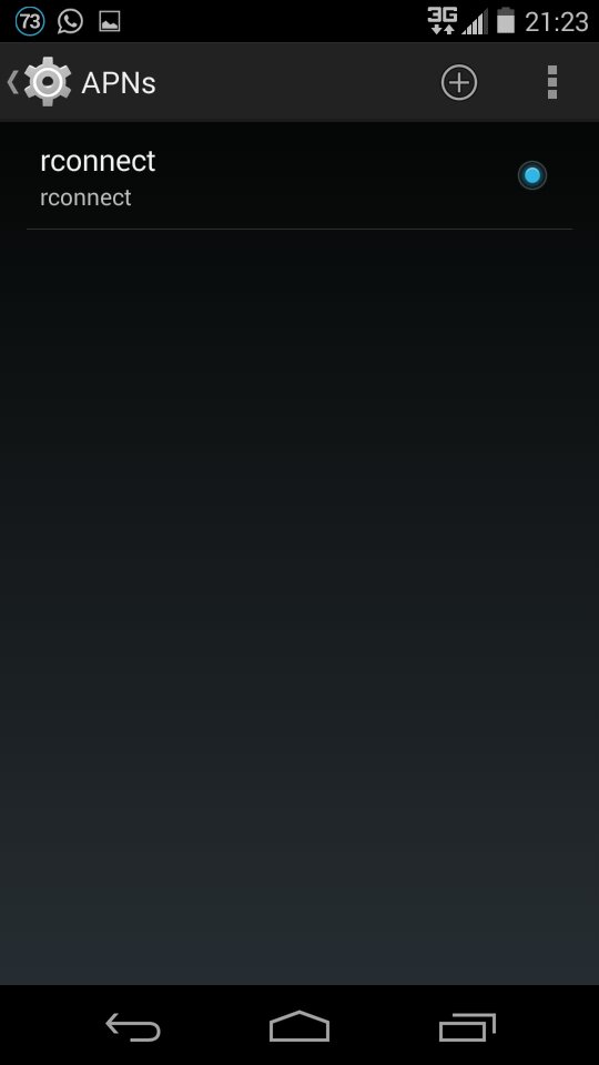

drmadhu 87 Report post Posted May 29, 2014 Below is screen shot seen that apn is manually add by (+) symbol Share this post Link to post Share on other sites
nmp 2 Report post Posted May 29, 2014 Dear Vijay ji, Thank you very miuch for reply. @nmp downgrade is not possible for razr m and also root is not release for kk.For data change ruim card and check apn settings mannually add if apn setting mannualy add than ur able to get data.Gotosettings->More->Mobile Network->Access point names there if u seen + symbol ur data is works in KK otherwise not possible.Sent from my LG-LS980 using Tapatalk When I go to Settings,>>...>>Accesspoint names, I cant see any + symbol. There is a menu in the top right panel When I click that, it says reset to default. NO other option. I tried that. Still no network I wish nobody gets this heartache. Someone please help.. Vijayji, any suggestions? Thanks, Share this post Link to post Share on other sites
