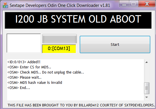

ni0987 179 Report post Posted February 16, 2014 Root+recovery on 4.1.2 without downgrade I200_JB-SYSTEM_ICS-BOOTLOADER.zip source I downloaded this file, checked its md5. extracted the huge single .exe file, put my stellar to ODIN/download mode connected with PC, fired the exe, clicked on 'Start' and it halts saying: 'md5 hash value is invalid'. Please check the attached shot. I have tried it many time, downloaded this file many times but the result is same. some basic info: Android Version: 4.1.2 Baseband: I200VRBMA1 Hardware: I200.04 I don;t know what other information should be checked. Friends, please help me root this stellar. Share this post Link to post Share on other sites
dr.faramroze 703 Report post Posted February 27, 2014 Root+recovery on 4.1.2 without downgrade I200_JB-SYSTEM_ICS-BOOTLOADER.zip source I downloaded this file, checked its md5. extracted the huge single .exe file, put my stellar to ODIN/download mode connected with PC, fired the exe, clicked on 'Start' and it halts saying: 'md5 hash value is invalid'. Please check the attached shot. I have tried it many time, downloaded this file many times but the result is same. some basic info: Android Version: 4.1.2 Baseband: I200VRBMA1 Hardware: I200.04 I don;t know what other information should be checked. Friends, please help me root this stellar. The reliable method as a daily driver is what i have given a page backwards. This embedded odin file is not compiled by Samsung so MD5 issues will occur. There are ways to run this without MD5 but still data will go off anytime. For using 4.1.2 on the Stellar, root and use the flashable zip because it only changes the system partiton and aboot, sbl, modem,recovery etc remain as 4.0.4. Share this post Link to post Share on other sites
