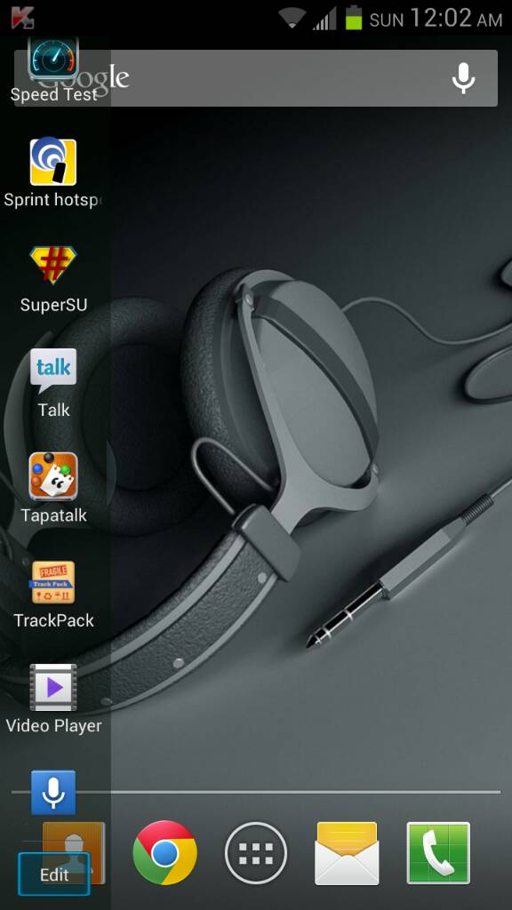

Vinod Nayak 443 Report post Posted March 24, 2013 After 2 days of testing I managed to get this ROM working. I'm still under testing to see if it's got any bugs. Till now only one, managed to sort it out through author. Will post more about this in a few days. Till now it's one of the best ROM I have ever come across for Sprint S3. Sent from my SPH-L710 using Tapatalk 2 Share this post Link to post Share on other sites
phonegeek 588 Report post Posted March 24, 2013 Which ROM? Sent from Samsung S3 using Tapatalk 2 Share this post Link to post Share on other sites
Vinod Nayak 443 Report post Posted March 24, 2013 M.O.R.A 4.1.2 ROM THIS ROM IS ONLY FOR SPRINT VERSION OF S3. http://forum.xda-developers.com/showthread.php?p=37149249 Do a clean install. Copy ROM into external sd. Make a Nand first. Wipe cache and dalvik cache, UNDER Mount and storage use format Internal sd. Install from external sd. Now it will take some time to boot since data has be formatted. So wait for it. IMPORTANT. ONCE BOOTED GO TO LOCK SCREEN AND SELECT AOSP. If you don't do this within the first boot. Your phone will get stuck in LOCK screen in landscape mode and you can't get out or won't be able to come out of it until you reflash the ROM. Please read through the site first and then go ahead. Sent from my SPH-L710 using Tapatalk 2 Share this post Link to post Share on other sites
ankurcshah 112 Report post Posted March 24, 2013 It is M.O.A.R Vinod sirji 1 Share this post Link to post Share on other sites
Vinod Nayak 443 Report post Posted March 24, 2013 Oops my bad Sent from my SPH-L710 using Tapatalk 2 Share this post Link to post Share on other sites
