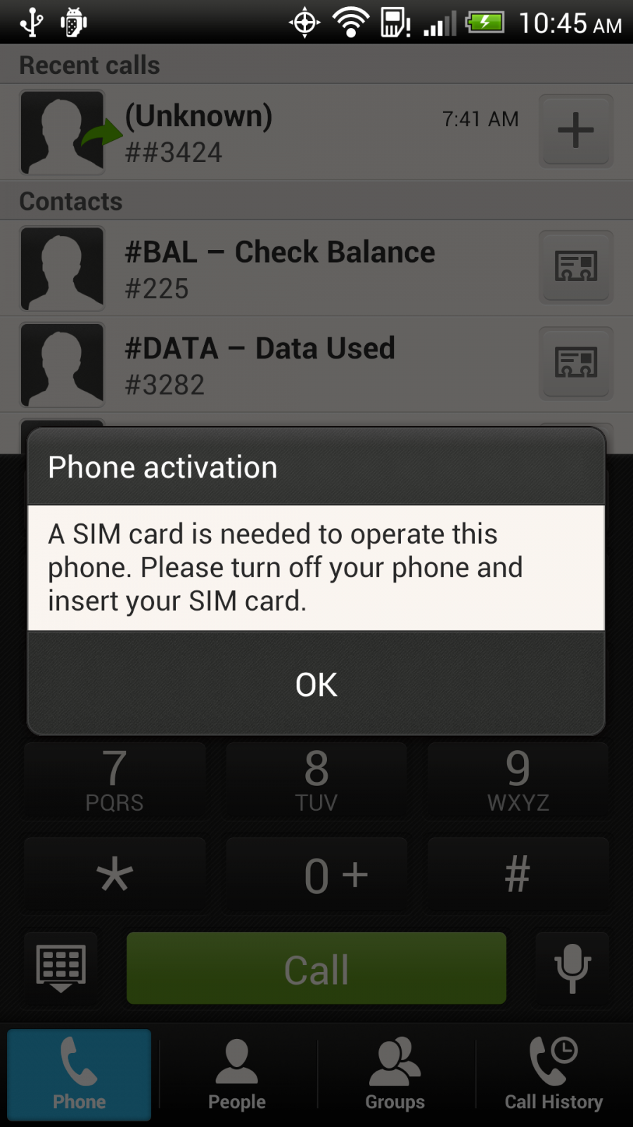

dev997 62 Report post Posted October 2, 2013 Hello Gurus, I am trying to do radio programming of Verizon Droid DNA for reliance cdma according to the instructions provided here: http://www.rimweb.in/forums/topic/35995-tutorial-flashing-your-cdma-handset-after-meidesn-registration/ Even after everything is done successfully, I am not able to get connected to *228. I am quite experienced with this process and has done prog for couple phones earlier too, but the process is not working for the DNA. I am getting a signal on CDMA mode but no 'reliance' banner. This let me think that nam, prl etc are written but there is still something I am missing. When I try to call *228 or *22898 or any no for that matter, I get 'no sim' error as shown in the screenshot attached. Requesting immediate help or suggestions to solve this for our beloved gurus. Thanks in advance !! Share this post Link to post Share on other sites
::Hitesh:: 1,763 Report post Posted October 2, 2013 Solution is already mention in your screen shot ! you need SIM card , even for using in nv mode, SIM card is required. Rom won't let u dial until it sees SIM . Or u need a mod to bypass this, which I am not aware of. Sent from Xparent ICS Tapatalk 2 3 Share this post Link to post Share on other sites
