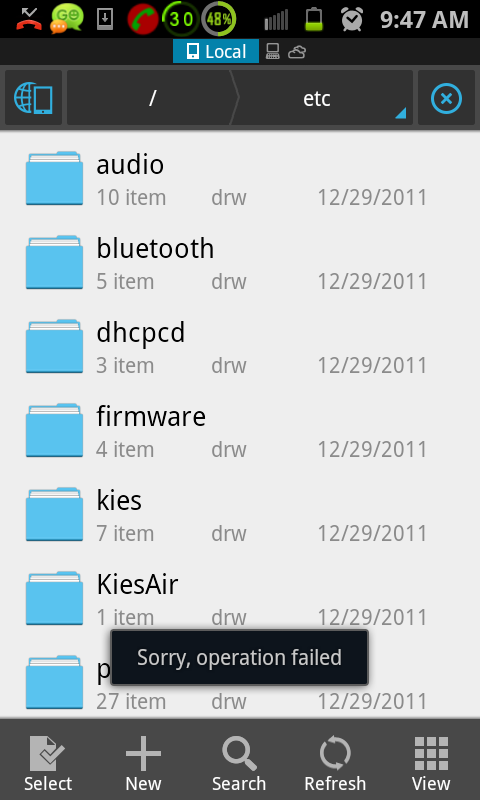

Hi, I tried doing above to find init.d support for my ET4G. I can access system root files (as phone is rooted) , but it is not allowing me to create a folder in 'etc' folder. It says "Sorry, operation failed". I am using ES File explorer.

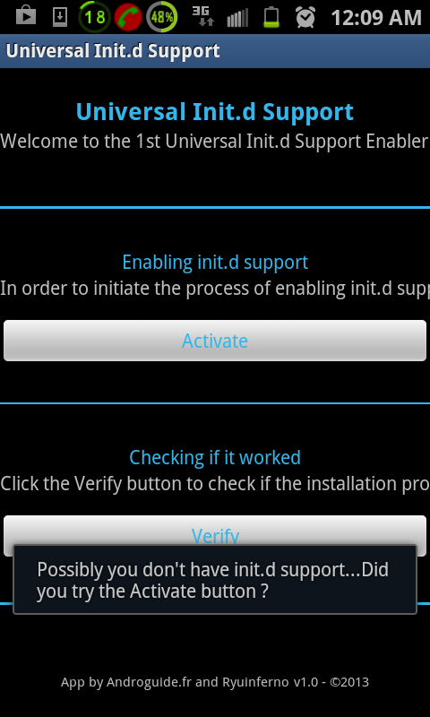

After following, steps 1, 2 & 3, it goes exactly the way it should. But, step 4 gives me result that it is not done.
Message is as follows.
post-5509-0-33607900-1375417792_thumb.pn
It says "Possibly, you don't have init.d support...Did you try the Activate button ?"
I have tried Activate button multiple times, & after 4 or 5 seconds, it shows me "Done".
What am I missing here ? I am on Stock Rom. 2.3.6, Baseband Version S:D710:10:S:EL29
I am facing problem of heavy battery drain & weak signal reception.
Can anyone help me with above ?

See if your efs has been granted su permissions, your root directory requires r/w permissions to alter/create folder.
Check and get back.
Have you installed busybox?
Edited by Vinod Nayak
See if your efs has been granted su permissions, your root directory requires r/w permissions to alter/create folder. Check and get back. Have you installed busybox?
It's done :)
Yes busybox was installed.
ES Explorer root permission was not given ( I had to figure it out later on) & then, change permission or root folder to be RW, then only it allowed me to create a folder "init.d" & place above mentioned file.
After rebooting, there was no test.log file I could find in root / data.
Then, I reinstalled above apk "Uni-init v1.0.apk" & clicked on Activate & it did the trick..
While validating it gave me message that "SUCCESS ! You have init.d support !"
So, I guess I am there.
But, IMPortant question. Will this automatically lead to improved battery life or some other settings / programming required ? Let us know that if yes.
