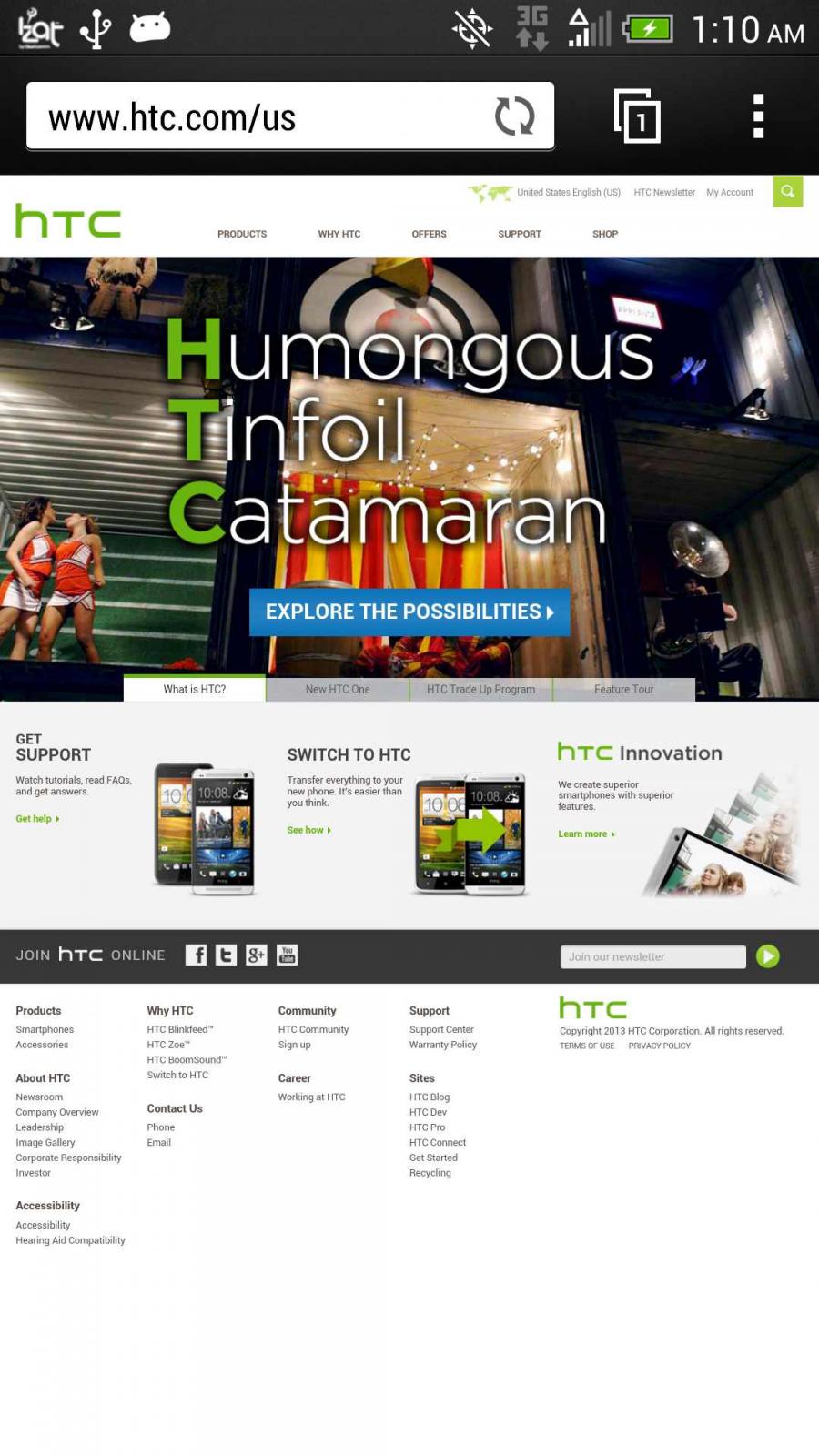

st_7 138 Report post Posted August 9, 2013 (edited) Tried this 2 weeks ago Call and SMS was working Coverage is like come and go every single minutes Data never worked for me Always Showed Triangle on coverage means Roaming ! but calls & sms are being charged locally!!, why does it still need roaming? Even data is working too, pls check the screen shot Edited August 9, 2013 by st_7 Share this post Link to post Share on other sites
