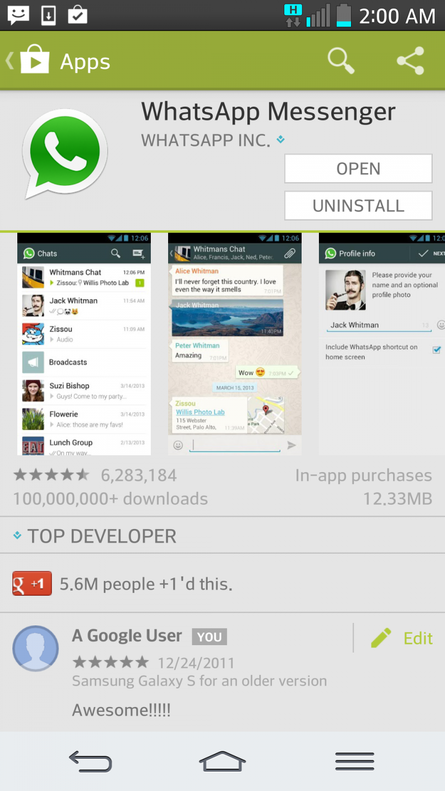

Vinod Nayak 443 Report post Posted January 4, 2014 (edited) Credit to it's original developer... http://forum.xda-dev...d.php?t=2596175 Finally managed to unlock GSM part of LG G2 LS980 Root Required Install Rom Tool Box Lite Run Rom Tool Box Lite and select Build.prop editor ro.carrier=spr (NOT SPR)ro.build.target_operator=spr (NOT SPR)persist.service.crash.enable=1 save, exit and reboot. Its as simple as that. GOT THE DATA TO WORK Install Telinfo from playstore and use it switch between GSM SIM and CDMA NV Edited February 2, 2014 by Vinod Nayak 7 Share this post Link to post Share on other sites
Vinod Nayak 443 Report post Posted January 4, 2014 (edited) Install TWEAKKER INTERNET MMS app and set APN of your GSM provider for DATA to work. SYSTEM UI CRASH, reboot to recovery, wipe cache. This should take care of it. Else revert back to stock ZV7 build. Edited January 5, 2014 by Vinod Nayak Share this post Link to post Share on other sites
Jat 11 Report post Posted January 4, 2014 Hmm...any Crashes and loop after edit of Build.prop? As I can see in your screenshot that the signal strength is quite low and at XDA many have reported that device goes into crash and loop at full/high signals after editing of Build.prop. Have you experienced any of that or none coz maybe the signals are always low in your area for the GSM carrier you are using. Share this post Link to post Share on other sites
