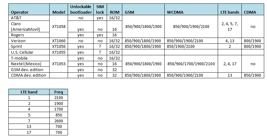

nishsuxx 193 Report post Posted February 17, 2014 I got this from XDA some time back .. dont have the link 1 Share this post Link to post Share on other sites
