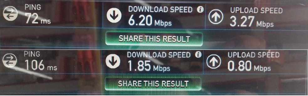

Vinod Nayak 443 Report post Posted March 9, 2014 There are values related to Sprint chameleon in the subscriber folder, i feel that adds a few properties in the default build. when i first downloaded the file, those files under subscriber folder were present when i copied it and over wrote the one in my phone. I tested in GSM and NV mode connected to my laptop at office, below are the results for speedtest.net: Now when i asked the author about posting it here and XDA, the author told me hes already posted here in our site, but got this message from a moderator which is mentioned below: Hi, this is just to inform you that you may need to remove files or folder rather that are(is) revealing much more information about the owner(from whom you got these files from) than it is needed. The information such as his sprint a/c number & a/c type as such. So, I recommend you to remove the folder 'Subscriber' folder from 'OMADM' folder in the carrier folder. You may remove the entire 'Omadm' folder as it only contains 'Subscriber' folder. You may try & check if wifi tethering is working or now by just putting 'Wifi' folder from this carrier folder(that you linked) in to carrier folder of your phone. It may work, hence you remove all the other folders & upload only that wifi folder. I don't have LG G2 right now otherwise I would've tested. And also if I may ask you what happened when you put the build.prop from Sprint customer that you got on XDA-Developers forum(yes I know that you asked for build.prop for wifi tethering on XDA-Forum, I've seen that thread). Prashant • 9:52 AM So i agreed to test the same mod without the subscriber folder files. i completely deleted the "OMADM" folder which hadthe related folder and files and rebooted. The mod still works like a charm with everything else working without any flaws. Though i checked all the files in the deleted folder, i still feel all those files are required to activate and get the hotspot working without messing other application. Because those files also have some chameleon data related values which i feel are added properties in the build.prop. Once the properties are added in build.prop, unless you delete it manually those will still be there & thats the reason my phone is working without any flaws even at this moment. Before anyone could actually download the original mod from here, the OP had already removed the files related to subscriber folder because i confirmed that the mod works without those files in it. I had told about this mod to garynsa, he tried the mod and it failed. Now that leaves us with only one conclusion. all the files that were present in the first upload still works like a charm. now this can be confirmed again by anyone who are ready to test it. HOW TO TEST: 1 Take a backup of the system/build.prop file. 2 Copy and paste the folder present in this post carrier.rar 3 Reboot and TEST. 4 Compare backed up build.prop and the one thats currently present in the phone after copying the mod. Please post your experience if you happen to test 1 Share this post Link to post Share on other sites
