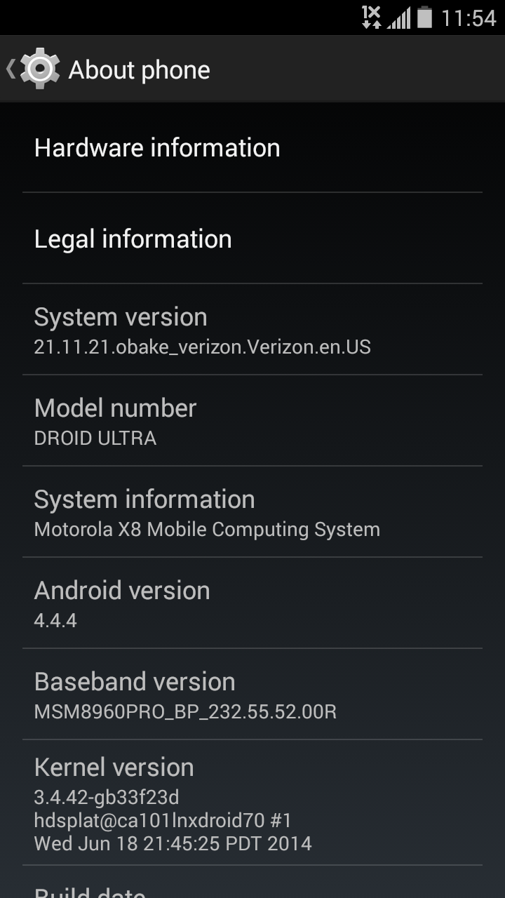

javed91214 67 Report post Posted July 22, 2014 everything is working fine , no need to unlock boot loader or root . just needed modded sim card . pl refer my screenshot. Share this post Link to post Share on other sites

javed91214 67 Report post Posted July 23, 2014 modded sim is the best solution , after reboot no signal lost. data also working 4.4.4 Share this post Link to post Share on other sites
