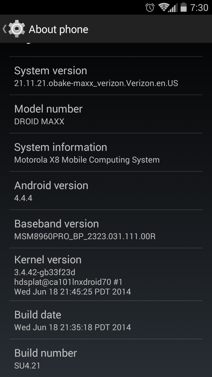

ashi1980 4 Report post Posted October 18, 2014 Hi ashi I'm not technical person plz explain process of radio downgrad how to setup adb in my PC if u have any tutorial link plz pm me I have xt 1080 with same prob my phone build date is 18 June 2014 can I downgrad radio sorry for my bad English Thanks Hitesh !!! You rock !! Just downgraded my Droid Maxx XT 1080 using your procedure and now it is working fine with TATA CDMA sim even after reboot. Awesome !!! You saved my phone.. Thanks a tonn... I think I've solved the issue on droid maxx... After 4.4.4 i was unable to use cdma after restart unless i used gsm sim n then swapped it with cdma sim... Somehow, 4.4.4 update brought a bad radio.. Specially for wifi.. Many places wifi won't connect where earlier it would connect before update.. So, i thought of downgrading the radio.. I downgraded it... N not sure about the wifi problem is solved or not... As I'm yet to use it at all the places.. But now cdma sim works even after restart.. Confirmed working.. Restated twice... Here is the link to radio http://forum.xda-developers.com/showthread.php?t=2674867 I'll post more details.. Your bl was unlocked? No, my bootloader is still locked and yet this patch worked. Now my tata cdma sim works even after reboot .... CONFIRMED Thanks again.. Yes you can downgrade radio of your phone.. ADB setup instructions can be found here http://forum.xda-developers.com/showthread.php?t=2588979 and radio downgrade instructions page link is already given on the first post of this page i.e. http://forum.xda-developers.com/showthread.php?t=2674867 Share this post Link to post Share on other sites

hiteshkkk1 327 Report post Posted October 18, 2014 Thanks Hitesh !!! You rock !! Just downgraded my Droid Maxx XT 1080 using your procedure and now it is working fine with TATA CDMA sim even after reboot. Awesome !!! You saved my phone.. Thanks a tonn... I think I've solved the issue on droid maxx... After 4.4.4 i was unable to use cdma after restart unless i used gsm sim n then swapped it with cdma sim... Somehow, 4.4.4 update brought a bad radio.. Specially for wifi.. Many places wifi won't connect where earlier it would connect before update.. So, i thought of downgrading the radio.. I downgraded it... N not sure about the wifi problem is solved or not... As I'm yet to use it at all the places.. But now cdma sim works even after restart.. Confirmed working.. Restated twice... Here is the link to radio http://forum.xda-developers.com/showthread.php?t=2674867 I'll post more details.. The Radio download link is not working can you please upload the files to some dropbox... or provide any other link... !! Download here http://dl.dropboxusercontent.com/1/view/qtepdzwflrd6lc7/droid%20maxx/4.4_19.6.3%20radio.zip Link is working perfectly, downloading now,will upload to Dropbox Sent from my Falcon_CDMA (Moto G) Share this post Link to post Share on other sites

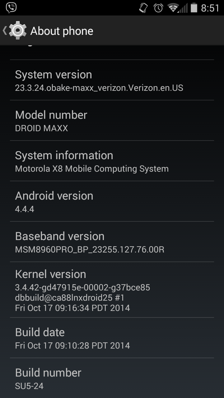

ashi1980 4 Report post Posted November 3, 2014 Update: Earlier my phone was not updated. It showed Update successful but actually it was not. Next day my phone again showed me that an update is available for your device and downloaded a 140 MB update. After checking in About Phone, I got to know that the previous update was failed. Then I reflashed my droid maxx with 4.4.4 radio and installed update again. Now it worked and CDMA sim and data working fine now. Share this post Link to post Share on other sites
slightee 5 Report post Posted November 3, 2014 Update: Earlier my phone was not updated. It showed Update successful but actually it was not. Next day my phone again showed me that an update is available for your device and downloaded a 140 MB update. After checking in About Phone, I got to know that the previous update was failed. Then I reflashed my droid maxx with 4.4.4 radio and installed update again. Now it worked and CDMA sim and data working fine now. Screenshot_2014-11-03-08-51-52.png Were you able to get WiFi tether working on this version? Share this post Link to post Share on other sites
ashi1980 4 Report post Posted November 3, 2014 No, wifi tether is still not working. Update: Earlier my phone was not updated. It showed Update successful but actually it was not. Next day my phone again showed me that an update is available for your device and downloaded a 140 MB update. After checking in About Phone, I got to know that the previous update was failed. Then I reflashed my droid maxx with 4.4.4 radio and installed update again. Now it worked and CDMA sim and data working fine now. Screenshot_2014-11-03-08-51-52.png Were you able to get WiFi tether working on this version? Share this post Link to post Share on other sites
