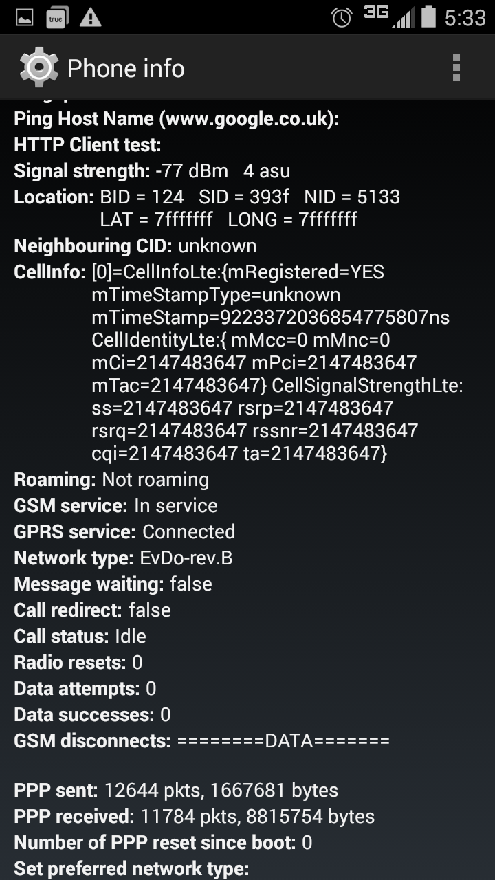

::: VA ::: 531 Report post Posted May 31, 2015 Bought a moto droid maxx Verizon with intentions of using rev b on it. Purchased a new CDMA reliance omh connection of recr uc06 . HSD activated through SMS. No clue about rev b? Speed is around 512 to 700 kbps so it must be rev a. You can use OpenSignal app from the play store. It clearly shows you EvDO Rev.A while connected to Reliance. BTW: Did you activate the SIM via *228 directly on the phone? I am in Pune too. Let's sync up. forum member aneeshmbabu posted a screenshot of droid maxx in which he has enabled evdo rev b and here are the settings he has posted to do the same in dfs ______________________ In DFS Tools,setting HDR SCP force AT config to -> RevB_MFPAand [0] Sub2 PL <- enable [1] EC CH <- enable [2] EA CH <- enable [3] EFT CH <- enable [4] Sub 3 RT <- enable [5] Sub 1 RT <- enable [6] Enh Idle <- enable [7] Gen M-M <- enable BCMS [0] <- enable App Sub MFPA <- enable Quote MultiQuote Share this post Link to post Share on other sites
vakharia 23 Report post Posted June 1, 2015 Great! What is the "Set preferred network type" value? Unfortunately your screenshot does not capture that part? Is it "CDMA (auto prl)? Share this post Link to post Share on other sites
aneeshmbabu 10 Report post Posted June 1, 2015 cdma auto prl.. 1 Share this post Link to post Share on other sites

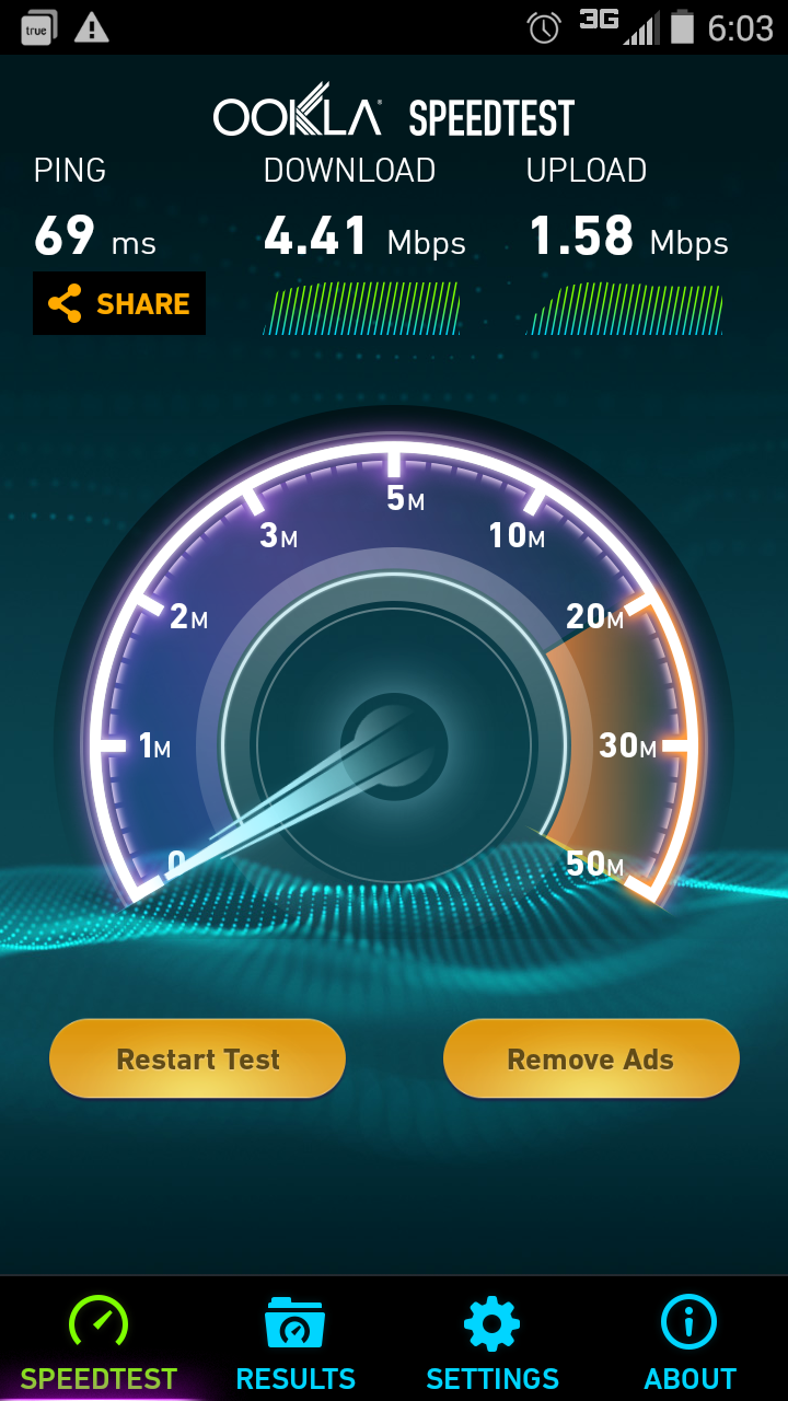

::: VA ::: 531 Report post Posted June 23, 2015 all droid maxx users should give this a shot. seriously its not a placebo effect. i have two chargers. one is motorola moto x dual usb which supports 1150 mah charging and another is my ipad charger which is 2 amp. i tried using them both for continuos duration of a week at least. checked them with ampere app to see the amount of charge passing through. the ipad charger not only charges it much faster as the phone accepts charge between 1200 mah to 1450 mah approx. the phone even holds the charge much longer (one and a half day easily with constant data & occasional wifi/bluetooth) . where as with the motorola charger it takes around 800-900 mah charge and loses it within 24 hrs. its worth giving it a shot if you have a 2 amp charger. Share this post Link to post Share on other sites
