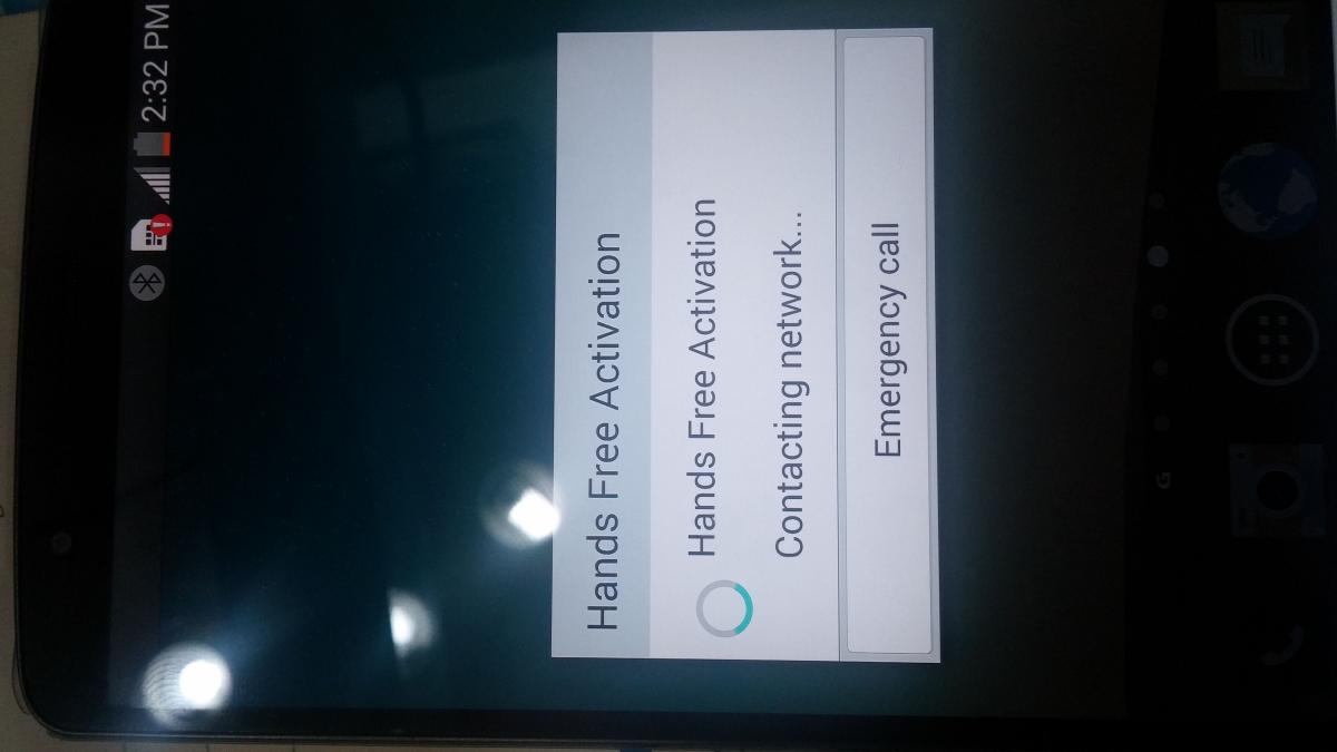

kmc251 73 Report post Posted September 3, 2014 (edited) Hi... i have a Sprint Lg G3... as soon as i connect to internet this annoying thing appears and says Handsfree activation.. can someone pls help how to stop this thing... SOLVED !! just Rename LGstartupwizard.apk... Which is located at /system/priv-app and you are done... Edited September 5, 2014 by kmc251 1 Share this post Link to post Share on other sites

ankurcshah 112 Report post Posted September 3, 2014 Rename LGSetup.apk to .bak. I havent checked by myself,but quite sure it would work. u should be Rooted ^@ Vijay: yes it can Share this post Link to post Share on other sites

kmc251 73 Report post Posted September 4, 2014 (edited) On 9/4/2014 at 7:33 AM, gauravjc said: same method of LG g2 should work ... pls try ! had tried that... but didnt worked... @ankur... its not LGsetup... but LGstartupwizard.apk... Which is located at /system/priv-app did the trick.... thanks everyone... Edited September 5, 2014 by kmc251 Share this post Link to post Share on other sites
ankurcshah 112 Report post Posted September 4, 2014 Lgstartupwizard. Apk Rename it and you are done Thanks to kunal sir. He confirms that it is done Sent from my SM-N900P using Tapatalk 2 Share this post Link to post Share on other sites

RohanM 0 Report post Posted November 2, 2014 Will this method works for LG G2 ? Lgstartupwizard. Apk I am gettting same pop up but only when I get conected to any wifi .. for GSM data no such issue. Will this work for LG G2 ? Share this post Link to post Share on other sites

runesone 0 Report post Posted April 20, 2015 help i cant change it its saying its read only on my sprint lg g3 ls990 Share this post Link to post Share on other sites
ankurcshah 112 Report post Posted April 21, 2015 On 4/20/2015 at 3:31 PM, runesone said: help i cant change it its saying its read only on my sprint lg g3 ls990 Use es file explorer and then change to RW mode. And then change file nameSent from my Motorola Droid Turbo using Tapatalk 2 Share this post Link to post Share on other sites
