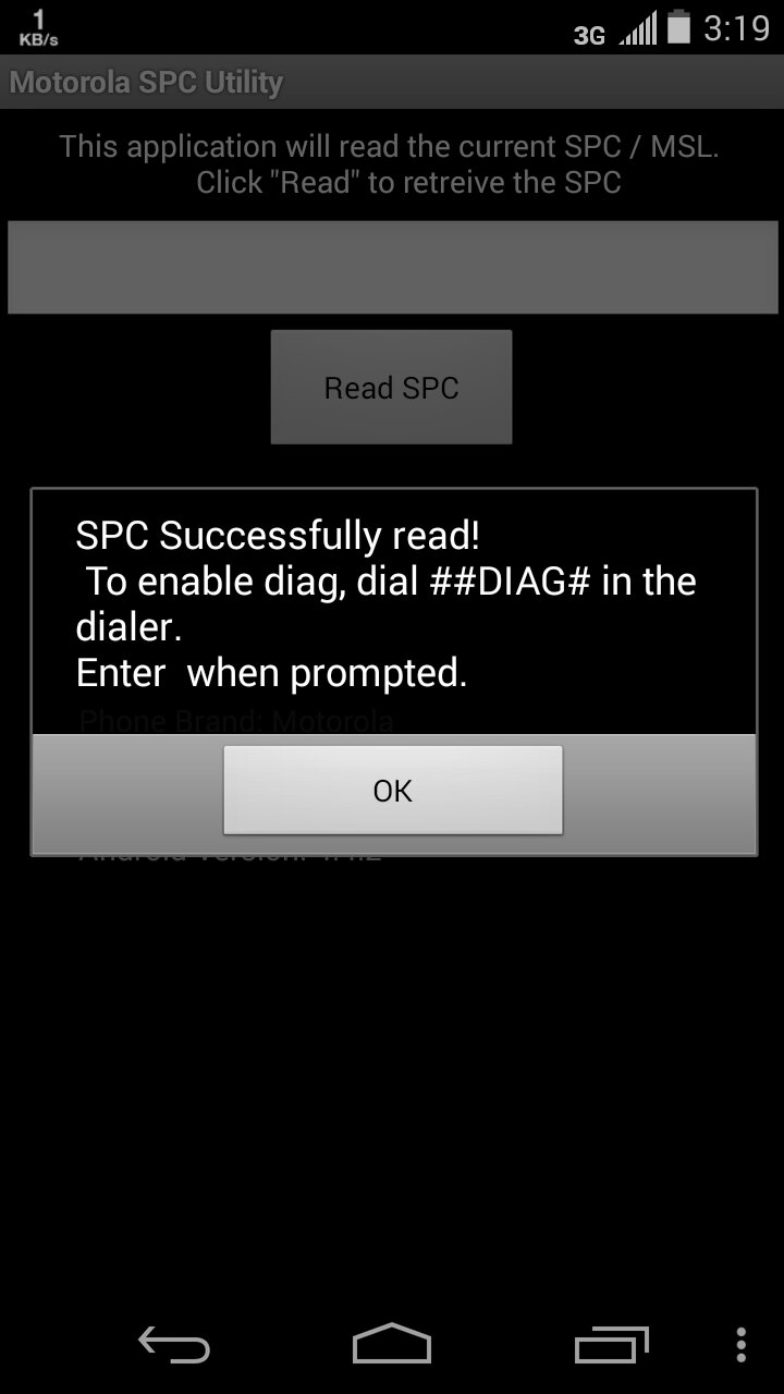

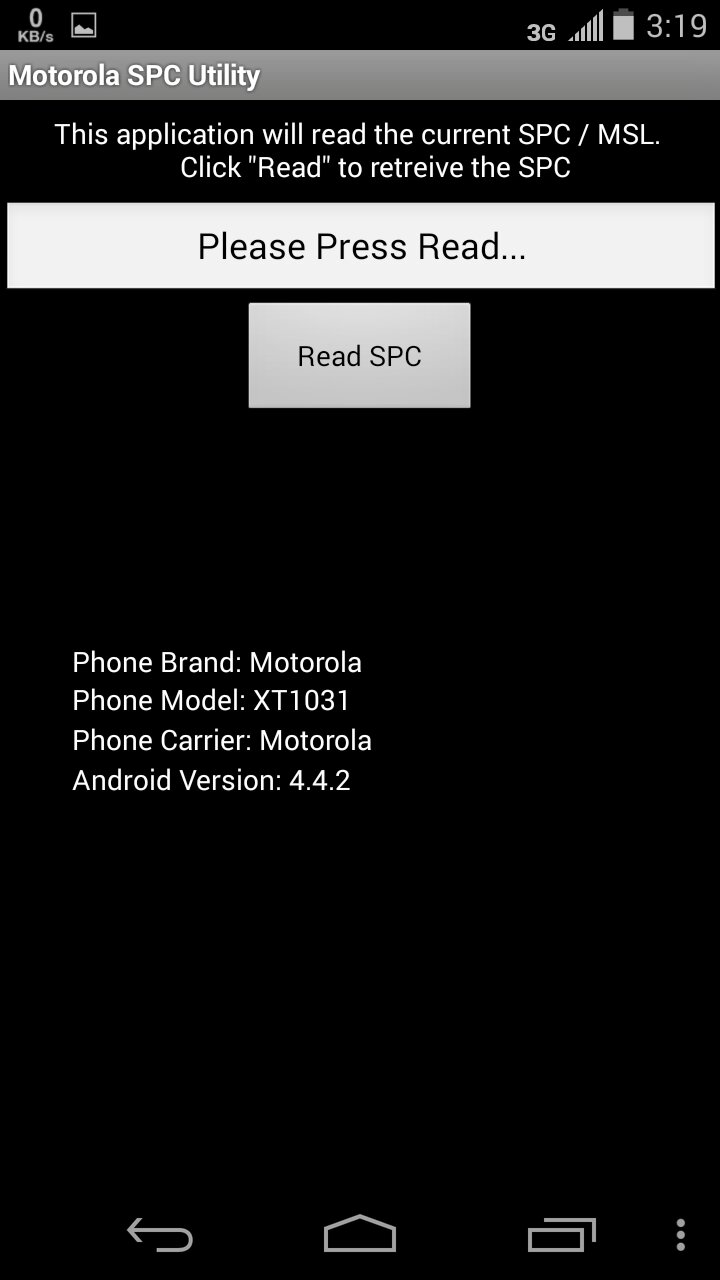

::Hitesh:: 1,763 Report post Posted September 23, 2014 So I did the big mistake of upgrading from 4.4.2 to 4.4.4, without taking note of spc.. my phone is not rooted, and I am not sure what to do.. Hitesh please advice I believe the solution is to do something twrp recovery which I have never used. So requesting detailed advice. thanks Dear Hitesh Bhai Please help me I have same issue I have also not noted SPC and I do not know SPC in such condition what can i do Please help meRight now there is no easy way to go back to 4.4.2 and also I don't have any solutions for spc on 4.4.4 So wait till apk developer updates its app for 4.4.4. Also as your phone is registered on reliance. You can get your spc from person who did registration. Mostly it was done zero before doing reliance programing. Hi Hitesh Bhai, i have done the PRL update and data settings after the update, everything is working fine except i keep on getting the activation message. I tried skipping many time, but still its poping up. pls help. Please read the first post again, solution already posted there. Posted using Moto G on Reliance CDMA Share this post Link to post Share on other sites
::Hitesh:: 1,763 Report post Posted September 24, 2014 Tried downgrade from 4.4.4 to 4.4.2, everything went fine after trying for 34hrs non stop. But bad new is can't read spc. Sent from my XT1031 using Tapatalk 2 Share this post Link to post Share on other sites
