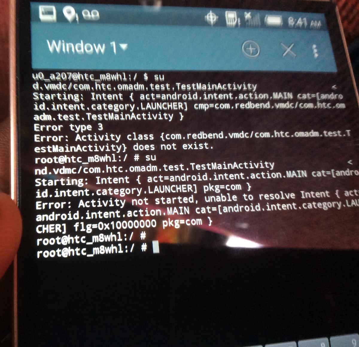

Hello
Trying to unlock HTC 510..
Getting error:
Error type 3 Error: Activity class {com.redbend.vdmc/com.htc.omadm.test.TestMainActivity} does not exist.
