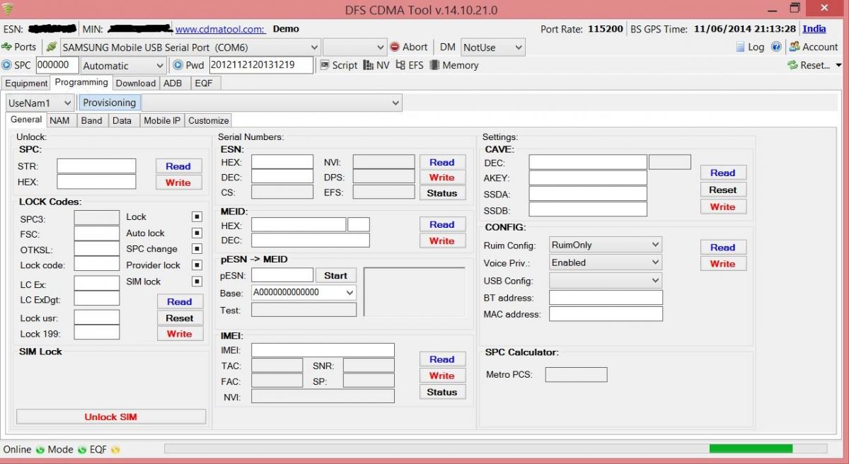

RIM-JPR 2 Report post Posted October 3, 2014 Hello I need help of all technical experts here.... While playing with codes i done ##786# hard reset. I thought only data will be deleted, but it completely wipes out RCDMA RUIM settings also. I manage to make it to RUIM only using DFS & entering SPC & 16 DIGIT password. After restart it shows signal of reliance. I m able to make & received calls & text messages, just by changing it to RUIM mode. But NO DATA both 1x & EVDO are not working on it.... Pls suggest what to do for getting DATA back. I m on NC5 Stock Rooted... Thanks Share this post Link to post Share on other sites

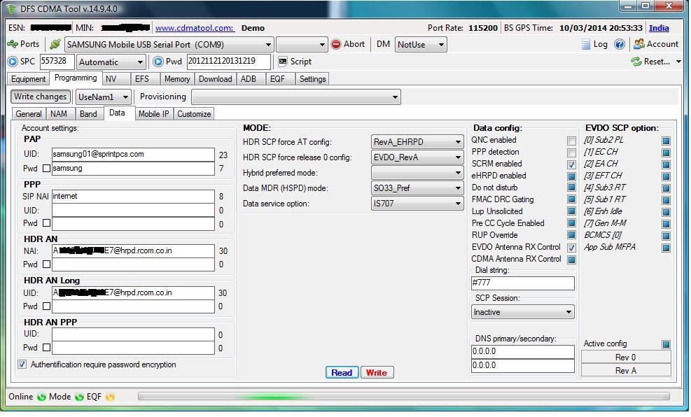

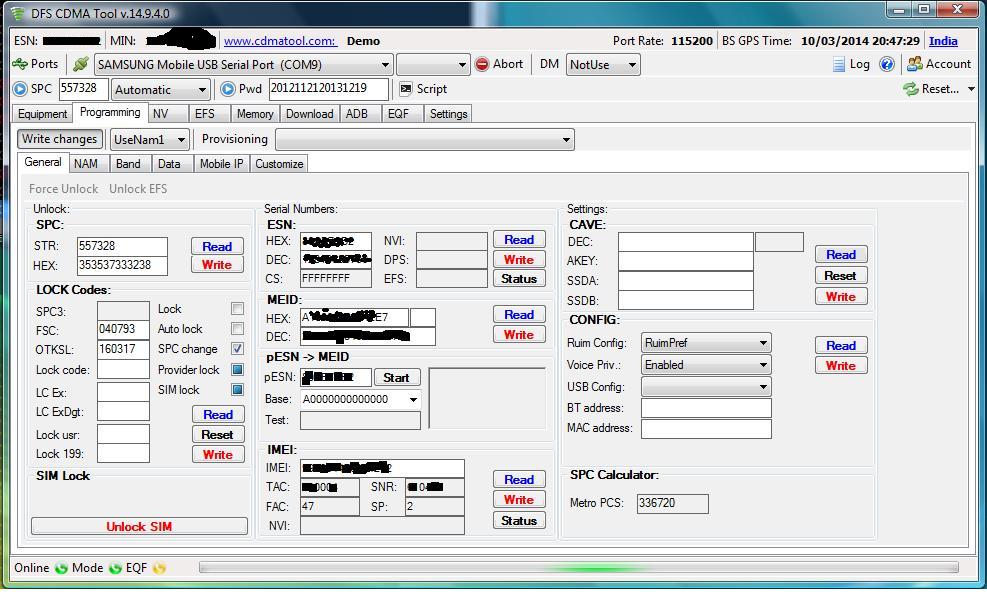

RIM-JPR 2 Report post Posted October 3, 2014 (edited) Hello Parin Sir I have made it RUIM PREF, but no luck.... Pls see SCREENSHOTS using DFS.... Edited October 3, 2014 by RIM-JPR Share this post Link to post Share on other sites

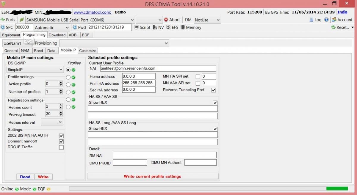

RIM-JPR 2 Report post Posted October 4, 2014 Get it working..... Just using DFS MIP tab Just change Mobile IP to Simple IP from dropdown & active profile set to 0 instead of 1 & write it & rebooted. Thats it... Done 3G sign comes back & got data working... Thanks Share this post Link to post Share on other sites

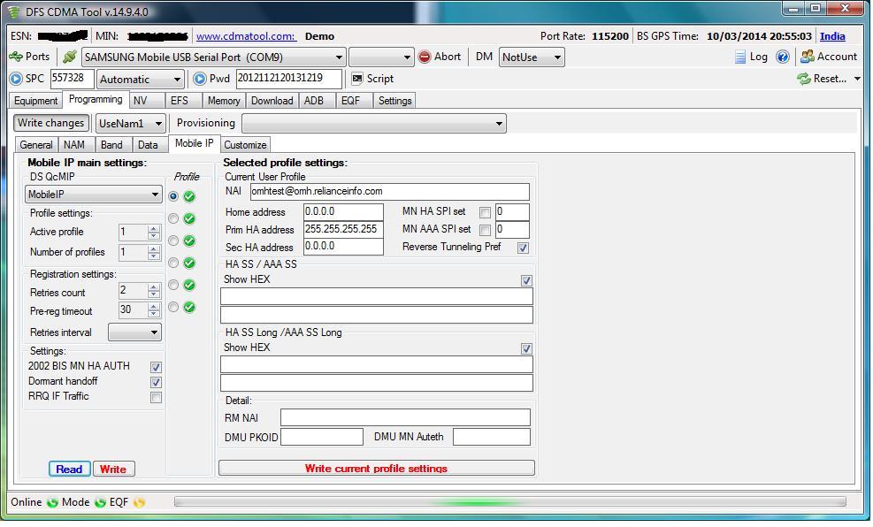

phonegeek 588 Report post Posted October 10, 2014 Well, I am really annoyed by this handset which is not letting data work on it Here is what I have done and remain successful. 1. Done RTN, programming with NV dump, wrote MDN/MIN, changed to RUIM Mode, made active profile as 0. 2. All above and changed to India mode in Korea mode. 3. Done RTN, deleted all the MIP profiles. I dont know how to diagnose what is wrong with the handset. Looking forward to all your suggestions. Share this post Link to post Share on other sites
RIM-JPR 2 Report post Posted October 11, 2014 Using dfs connect phone, select mip tab & press read button at bottom. Select simple ip from dropdown Active profile 0 Disable all profiles to red & again press write & than reboot. Let me know if it works..... Share this post Link to post Share on other sites

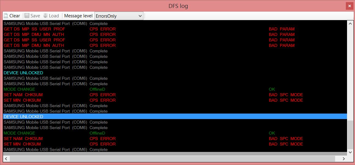

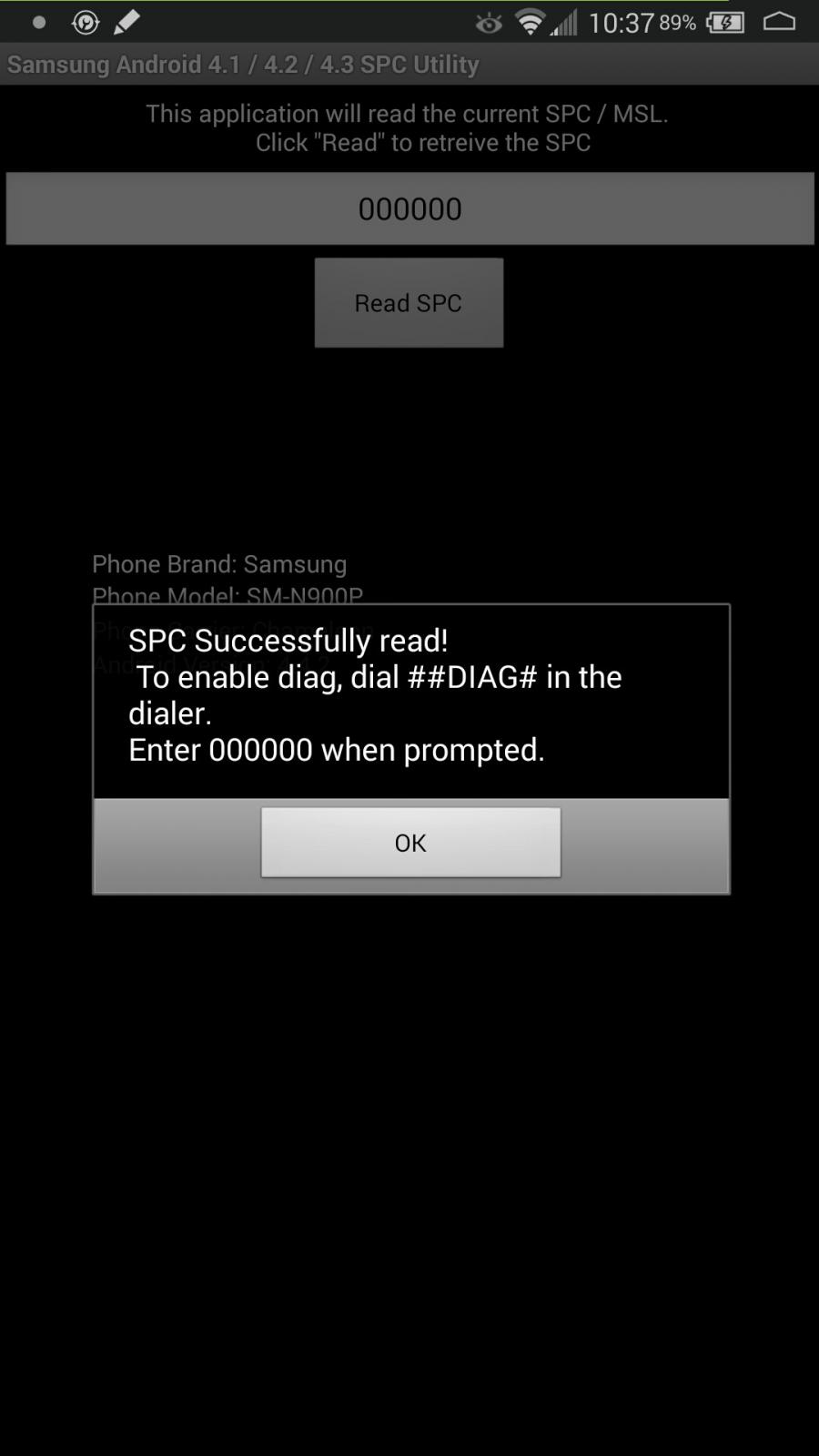

pmthokku 0 Report post Posted November 7, 2014 hi, Please help me: Not able to follow steps in the forums for getting data on RUIM sim (voice working). I used Mr. Vinod Nayak's spc utility to get the spc and put in DIAG mode (selected PDA and in usb setting selected DM+MODEM+ADB). Sent along spc and 16 digit password via dfs and get message DEVICE UNLOCKED. But get error message when i try to write or when i read certain items (like SPC). I also don't understand the steps suggested by dr. faramroze (do normal NV programming with obsolete nv data, write MIN etc). Before I did all this, I rooted (towel root), upgraded to 4.4.2 nc5, installed twrp, installed xnote 16 version for sprint note 3. Thank you. Share this post Link to post Share on other sites
RIM-JPR 2 Report post Posted November 7, 2014 (edited) hi, Please help me: Not able to follow steps in the forums for getting data on RUIM sim (voice working). I used Mr. Vinod Nayak's spc utility to get the spc and put in DIAG mode (selected PDA and in usb setting selected DM+MODEM+ADB). Sent along spc and 16 digit password via dfs and get message DEVICE UNLOCKED. But get error message when i try to write or when i read certain items (like SPC). I also don't understand the steps suggested by dr. faramroze (do normal NV programming with obsolete nv data, write MIN etc). Before I did all this, I rooted (towel root), upgraded to 4.4.2 nc5, installed twrp, installed xnote 16 version for sprint note 3. Thank you. Do ##72786# (SCRTN)Connect with DFS Enter SPC & 16 DIGIT PSWD Go to Programing/General Read Config Set it to RUIM PREFERRED & than press Write button & Reboot Now ur handset will get signals Now switch off mobile data & than Go to ##DATA# Edit Enter MSL Go to More Select korea mode set Select &enable india mode Exit from data menu Reboot now & check it may work... Edited November 7, 2014 by RIM-JPR 2 Share this post Link to post Share on other sites
