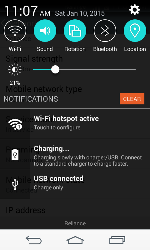

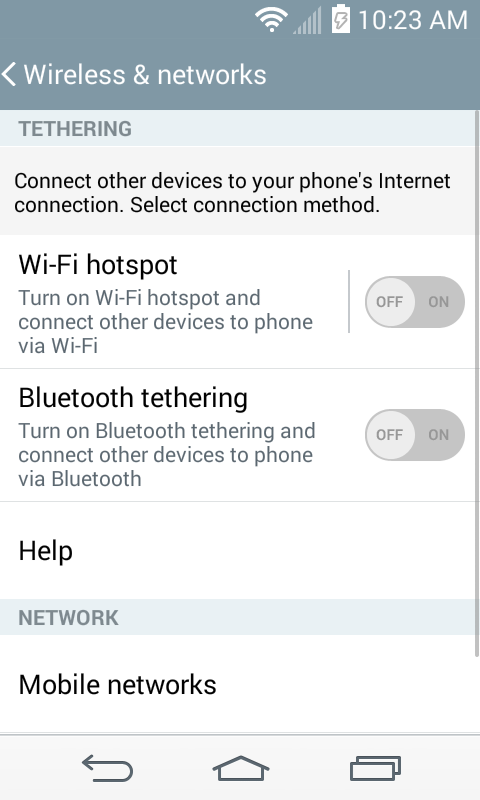

varkey 51 Report post Posted January 10, 2015 (edited) Enable OMH/EVDO/Wifi-Hotspot on Spring LG Tribute LS660 To get the SPC, we need to activate the device on Ting (a Sprint MVNO operator in the US). Use a referral link to Signup on Ting so that you get a $25 account credit. You may use mine if you'd like -- http://bit.ly/varkeyting Proceed for activation and it will ask you for the MEID and ICC ID, both are available on the box. Go through the steps, enter any US address (maybe use the address of a package forwarder or something). You will be asked to add a payment method, don't worry they won't charge you immediately. Create or use an existing Amazon account for this. Add a virtual credit card and link it to Ting. Once this wizard completes you will get an email with the SPC. You don't need to do anything on the handset. Now you can go to the device settings page in Ting and delete the device. Once we have the SPC, we can get the device activated directly on Sprint so that the Wifi Hotspot and other features get enabled. Go to http://bit.ly/sprintact and select "I'm a new customer and I want to activate my Sprint Prepaid phone." and go through the wizard. You need to enter your MEID and it will ask you to confirm the ICC ID. (You may have to wait sometime after you deleted the device from Ting for this to work) Go to the next page, enter the details (use any US address where Sprint has service). Choose the cheapest plan and when it asks for payment, select the pay later option at the bottom. Finish all the steps and you will get an email with your new Phone number. Now power on the device, connect it to WiFi and let it activate. This may take some time as it downloads couple of things. Once the activation, PRL update, firmware update etc is complete you would be able to use the device. Go to the settings menu and see if the Wifi Hotspot sub menu is enabled. Now we need to enable DIAG mode and then RUIM. @Vinod Nayak has made an excellent tutorial on this, so I am not posting it again. Please check the thread -- http://www.rimweb.in/forums/topic/36748-how-to-change-mode-from-nv-to-ruim-in-any-cdma-phone-using-dfs-free-version/ (You may also want to change the SPC 000000 to remember to easily.) You can insert the Reliance CDMA RUIM and it should register to network with call and SMS. I used a mini SIM which was cut and didn't have any problems. Few users reported that it did not work with a cut sim. So YMMV. When enabling data it threw an error for me and few others. To get data working, I am not sure of the exact change but few of the changes that I had made before it started working are below. I used QPST 2.7.411 for Step 2. (I will update the post with more info once I have the exact changes required). Changed the NV MCC MNC to 404 00 Disabled Sprint Mobile IP profiles and created a new one and activated with NAI as NET Changed NV Mode to SimpleIP Known Issues Handsfree activation popup on every restart. To make it go away immediately, enable Airplane mode, wait few seconds, it would display an error and disappear. Now disable Airplane mode and you can continue using the device (well, until the next restart )I will update the post with more details as we learn about them. I thank everyone who participated in the other thread, for their inputs which helped us in reaching this stage. Edited January 10, 2015 by varkey 19 Share this post Link to post Share on other sites

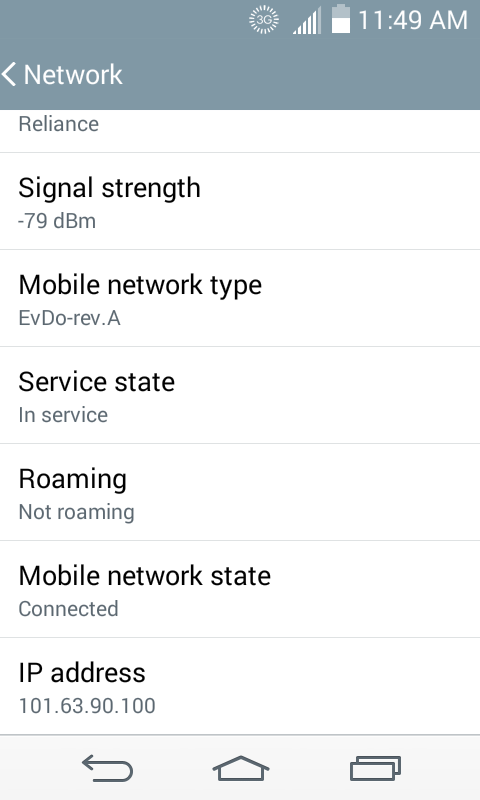

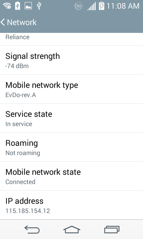

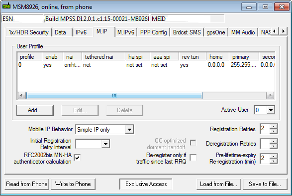

iamrafic 85 Report post Posted January 10, 2015 Thanks Vivek, Great initiative, Now everybody is buying LG tribute as they were doing it with MOTO G Boost. Now i activate the mobile on sprint, and Hostspot is active. But still i'm unable to get the taste of data services. Not even 1x Works. If you could explain the below steps with screenshots it would be great. To get data working, I am not sure of the exact change but few of the changes that I had made before it started working are below. I used QPST 2.7.411 for Step 2. (I will update the post with more info once I have the exact changes required). Changed the NV MCC MNC to 404 00 Disabled Sprint Mobile IP profiles and created a new one and activated with NAI as NET Changed NV Mode to SimpleIP Share this post Link to post Share on other sites

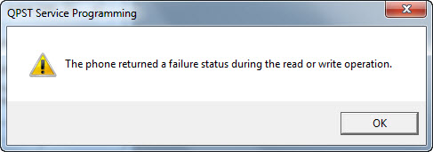

iamrafic 85 Report post Posted January 10, 2015 When i try the QPST setting, I'm able to read the settings but when i try to write It throws me the below error. "The phone returned a failure status during the read and write operation" I also tried changing the port from COM26 to COM 3 as suggested in another forum. Share this post Link to post Share on other sites
varkey 51 Report post Posted January 10, 2015 When i try the QPST setting, I'm able to read the settings but when i try to write It throws me the below error. "The phone returned a failure status during the read and write operation" I also tried changing the port from COM26 to COM 3 as suggested in another forum. You may ignore that error, it is not able to write a specific NV ITEM, shouldn't be an issue. Share this post Link to post Share on other sites
iamrafic 85 Report post Posted January 10, 2015 When i try the QPST setting, I'm able to read the settings but when i try to write It throws me the below error. "The phone returned a failure status during the read and write operation" I also tried changing the port from COM26 to COM 3 as suggested in another forum. You may ignore that error, it is not able to write a specific NV ITEM, shouldn't be an issue. The values are not getting written to the Phone. Share this post Link to post Share on other sites

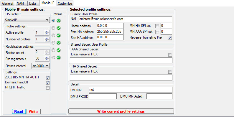

iamrafic 85 Report post Posted January 10, 2015 When i try to read the Mobile IP settings using DFS, i'm getting the below error . GET DS_MIP_SS_USER_PROF CPS_ERROR BAD_PARAM This happens only when the SIM is inserted. Without SIM and in NV modesi'm able to read and write MIP profiles. Because of this i'm unable to change the NAI to NET. I believe if the value can be changed to NET, data will work not sure. Share this post Link to post Share on other sites
nishsuxx 193 Report post Posted January 10, 2015 Of course you`ll get error with sim inserted as you are trying to read passwords... If you have evdo dump of any previous registration, just write that from CDMA WS and you dont have to do all this manual labour.... check this guide... i dont see the NAM dump there so attaching here again Reliance.rar 2 Share this post Link to post Share on other sites
pritamcharan 18 Report post Posted January 12, 2015 (edited) after doing all these changes if anyone isnt able to get data on lg tribute, get qpst nv backup file from a untouched lg tribute, write it to your lg tribute , and then follow these reliance settings MCC = 404 MNC= 00 NAI = net HA password = net AAA password = net T. Nai = net Simple IP PPP username and password = net do this chnages on nv mode chnage to ruim only and insert reliance sim you will get data Edited January 12, 2015 by pritamcharan 8 Share this post Link to post Share on other sites
