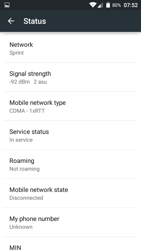

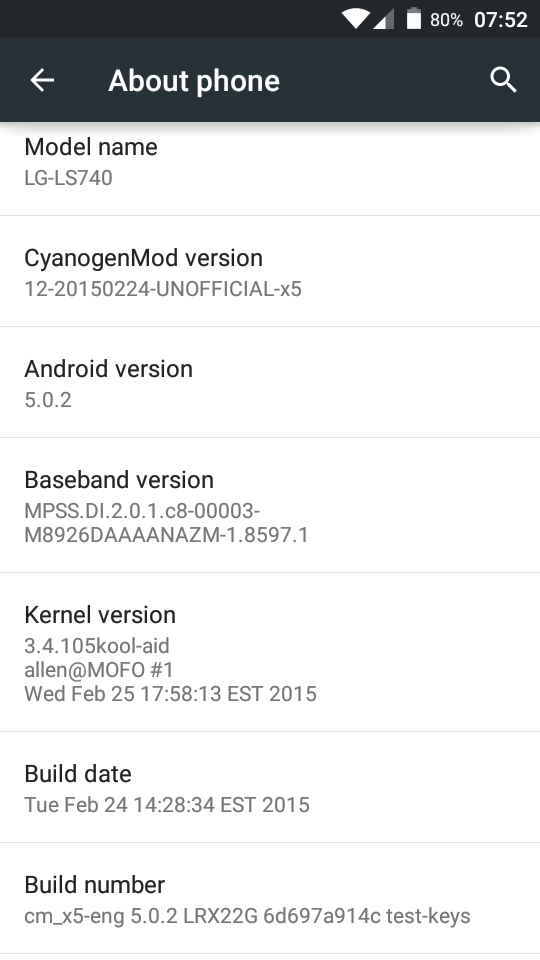

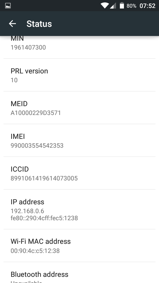

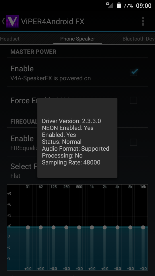

kuduku 24 Report post Posted February 27, 2015 (edited) I know its Tribute thread but Info for all Volt owners CM12 Lollipop beta has been released by a dev . I have installed it on my Boost Volt . No problems in call, sms and data .Its in RUIM mode when i flashed and read from RUIM with no issues . All works for me except REAR camera where people have mixes issue . Some have it working and some not . Only cosmetic issue it shows network as SPRINT instead of MTS . Also cant get VIPER4ANDOID to work . Shows driver installed and everything fine ROM LINK http://androidforums.com/threads/cm12-unofficial-beta.905257/ Proof in pics Now to check BSNL RUIM as both tribute and Volt were not working with BSNL RUIM Edited February 27, 2015 by kuduku 1 Share this post Link to post Share on other sites
